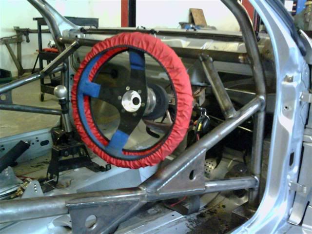

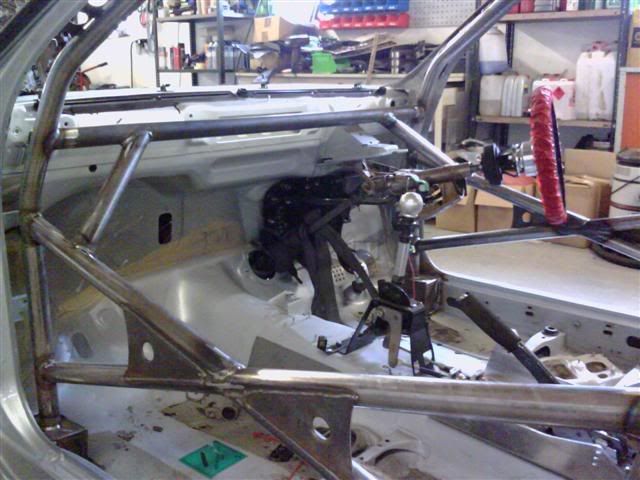

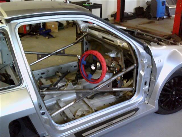

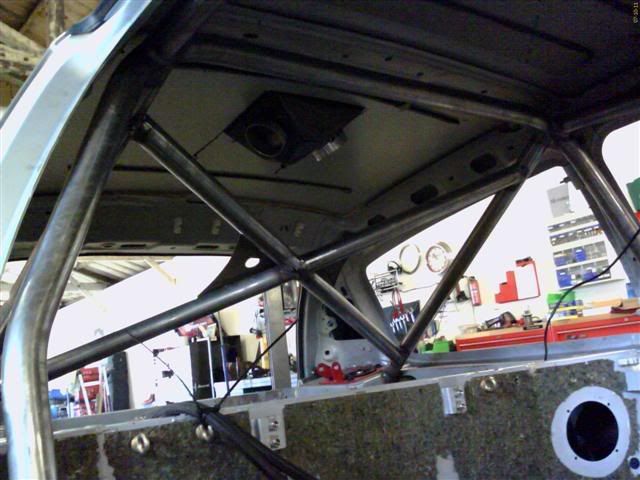

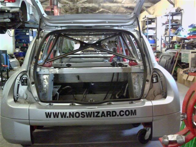

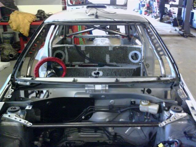

Just a few sketchy preliminary pics.
Cage and interior is off to be painted now, then Scott can start putting it all back together.
Thanks to James, he's done a beautiful job on this.
The steering wheel is not bolted into position before anyone asks..............
Very nice - weldings better than on mine!
Is the cage triangulated through the front bulkhead to the suspension towers?
Not triangulated to towers Max, it's a bit more work and I didn't feel I needed to stretch to that.
Could be done at a later date though....
