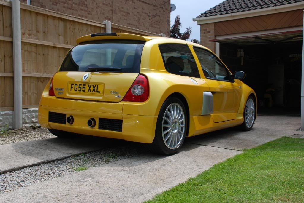

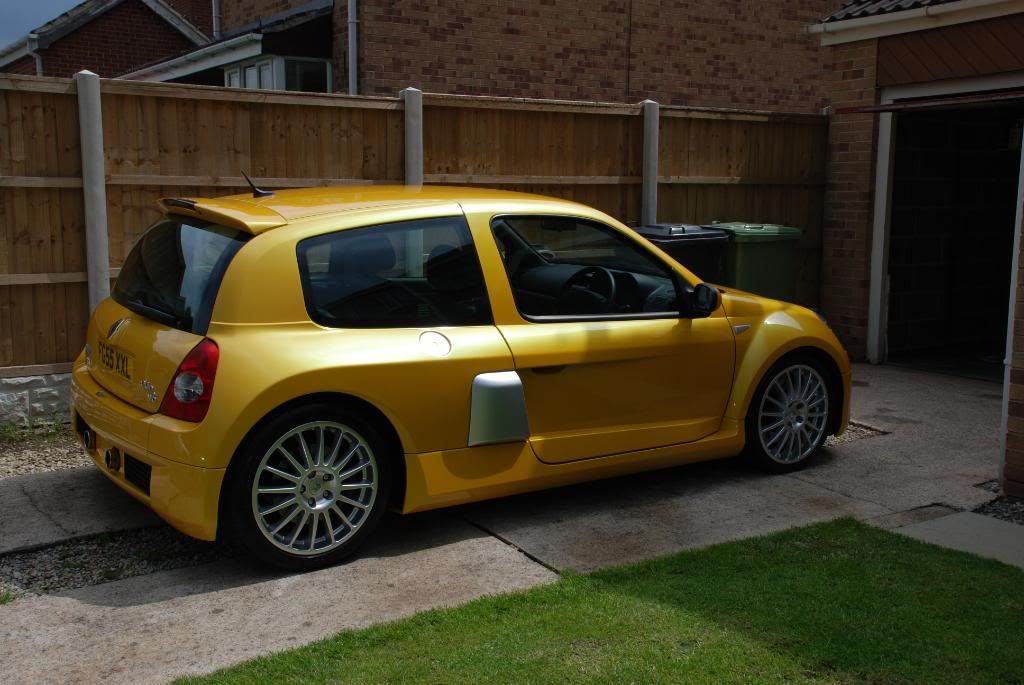

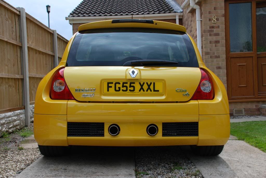

Pics of the exhaust fitted. :approve:
Gleen - Pics look good, I have just got a quick question for you and mossy but how did u manage to get the exhaust centred? Mine seems to have a mind of its own and since i fitted it seems to have moved up and is now close to melting the bumper. Is there something i can loosen or twist in order to get it coming out of the middle of the bumper?
Cheers
When I fitted mine recently I had to loosed the two clamps then literally stand on my exhaust to push it down, whilst tightening the clamps back up again. Does take a little while to get it bang on. Also make sure you put two nuts on the clamps to stop any slipage.
