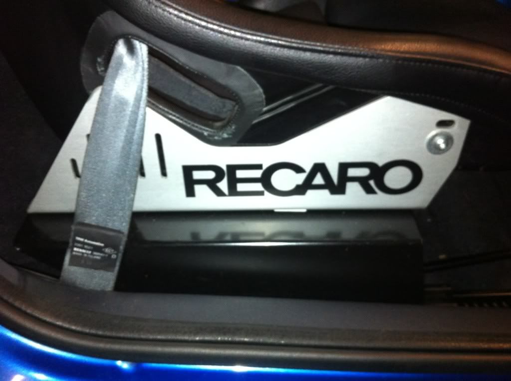

Anyone got this set up of recaro pole positions and cobra subframes? I have fitted my pole positions using recaro sub frames but they are far too high, are the cobra ones much lower? Also do the recaro side mounts bolt straight onto the cobra sub frames?

I'd agree, I fitted mine and they are miles too high. The seat back is nearly touching the roof!

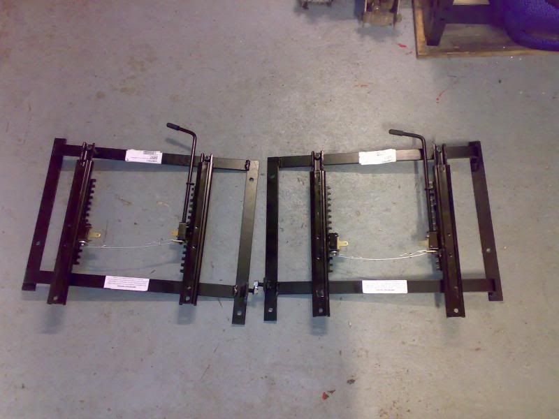

Here's my modified frames, you can see how much lower the frames are in relation to the sill and the inner side mounts are not the usual silver recaro ones ( although the outer side mounts are :s )

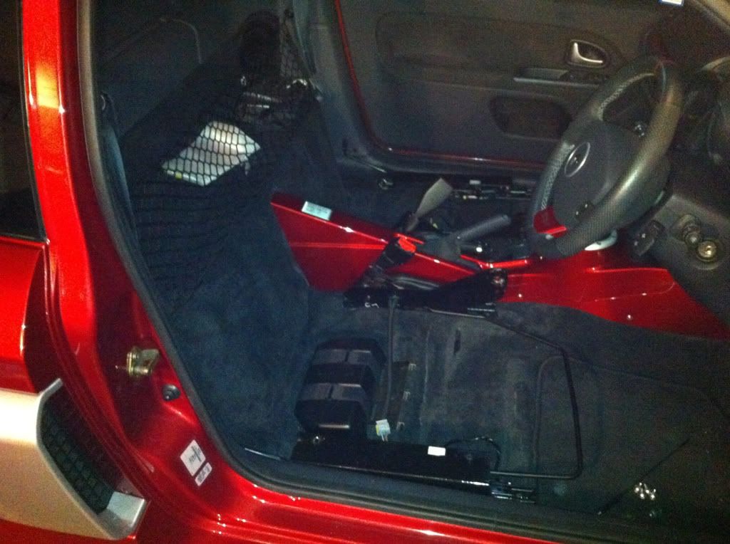

I used a set of Cobra subframes to fit my original base mount bucket seats in the Clio - there are pictures in the knowledge base article I wrote here Fitting Aftermarket Seats. They were not FIA compliant but mounted the seats VERY low but this was also because the seat was very shallow also, the car really did feel like a go-kart. Sidemount fittings are probably available or easy to fabricate to them ...
Not sure Ali but, as you can probably see, they couldn't be any lower as the inner mounting rail was literally sat on the floor with only the height of the slider between the floor and seat base (and then allowing for a few mm of subrame thickness). If you are mounting them without sliders the seat base could essentially be as low as the exhaust tunnel. It really did feel almost like you were sat on the floor and I like my driving position so my legs are as straight as possible with minimal knee bending and less pressure on my thighs - my seats were like that.
Can anyone possibly measure up a set of their cobra subframes and send me the dimensions, basically i am looking the size of the flat bar used, the length of each section and the heigh difference between the 2 legs.
