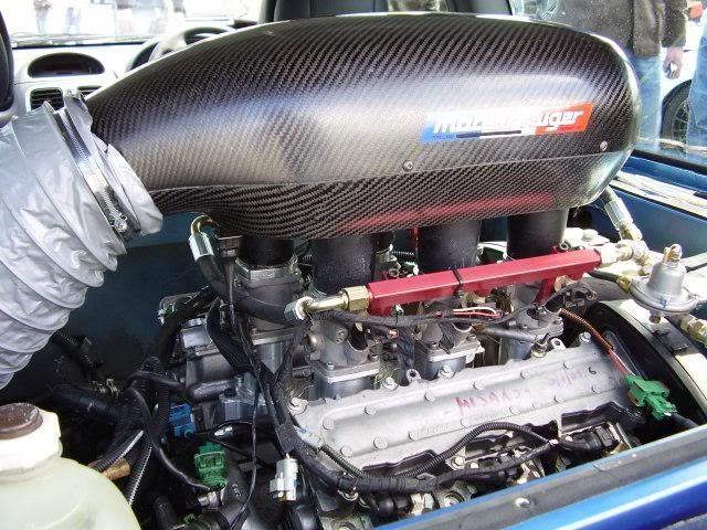

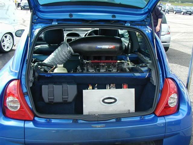

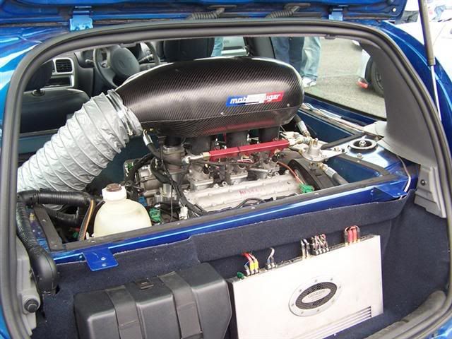

Nathan's not a Forum member but some of you may have seen his blue Mk1 at FCS.........on KTec's stand I believe. Has a Huger ITB engine.
Can't tell you too much about the specifics I'm afraid.
Engine was built at home with Huger parts and had a few issues......breathing oil a bit then blew up!!
Been rebuilt since, by Huger I believe and going back in the car soon.....he's been asking me about the clutch and plates we're using in mine.
Power figures previously were not impressive for the spec. If I recall it made only 240 atw though the mapper told him this was 330 atf. Bit of an exaggeration I suspect, Ray's for those who didn't know was 250 atw and 292 atf, so you can work out the rest.
Not the prettiest install, the rear is usually covered over.
