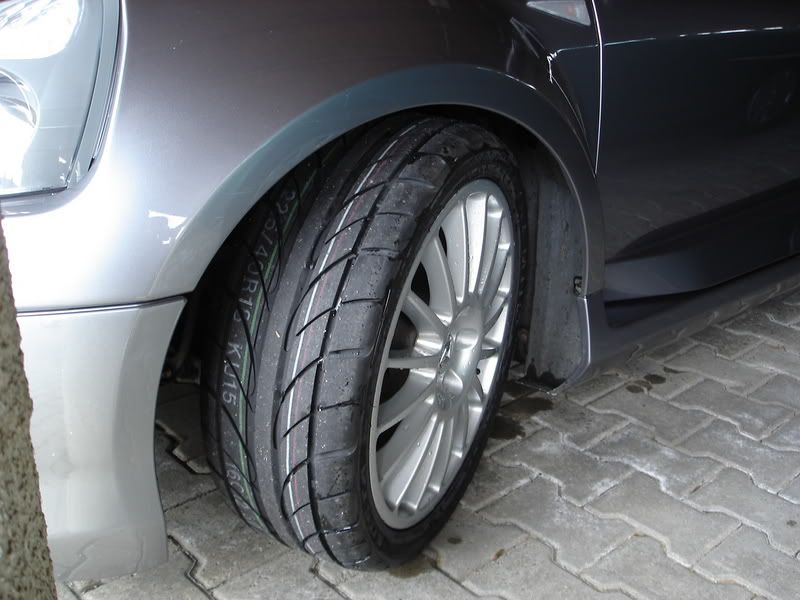

I have buyed the Kumho's KU15's a few weeks ago.
Sunday i made a test day, Zig zag lines at 170/180 km/h and pushing up & down the Hill's.
I was surprised, very good grip and stable tire walls [smilie=icon_thumright.gif]
The best price/performance rapport IMO

I see from the pic above that 253Horses is running Kumho KU15s on his Mk2 and they are 225/40/18..............225/35 would be closer to the original size.....

We'll have to wait and see if 253Horses' tyres fall off!!!!
hahahahahahaaaaa
Until now the tires on the front diden't fall off. [smilie=hide.gif]
I have pushed the Clio on mountain roads a few times really at the limit . and i am 100% confident now that i made a good choice with the Kumhos in 225/40/18 on the front.
i knew about the commandation that 225`s need a 7.5" canal, some commandations are there to avoid. [smilie=drunken_smilie1.gif]

As I said, I know MikeT ran 225s on the front when on 18s also.......
Takes a brave man to push it to the limit in a V6 on mountain roads and on tyres that might fall off.......:)
