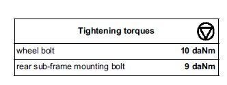

Subframe bolts will need to be torqued to the correct setting.
Not sure of the setting, im sure someone will advise. It would not matter if the car was jacked up or not, but if the weight is on the subframe (ie not jacked) it would help.
