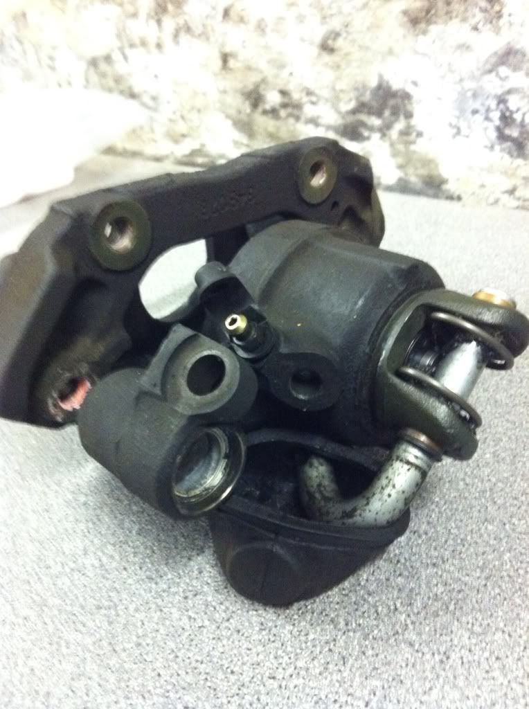

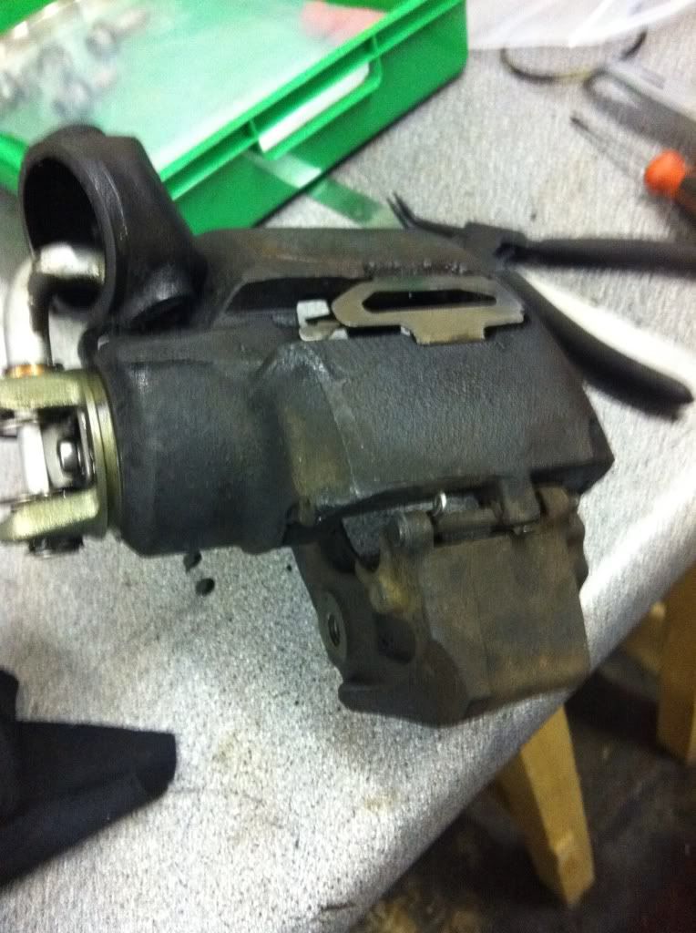

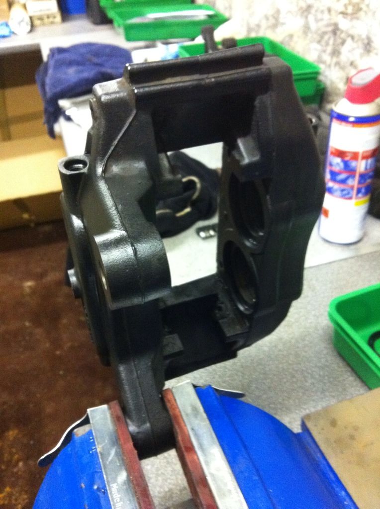

Starting to strip one of the calipers down...
Showing Rear side of caliper and the handbrake mechanism exposed...

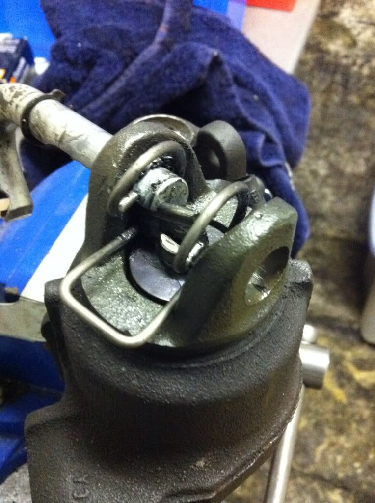

Starting to take handbrake mechanism apart...

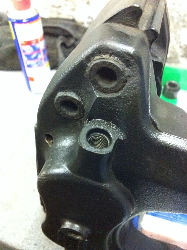

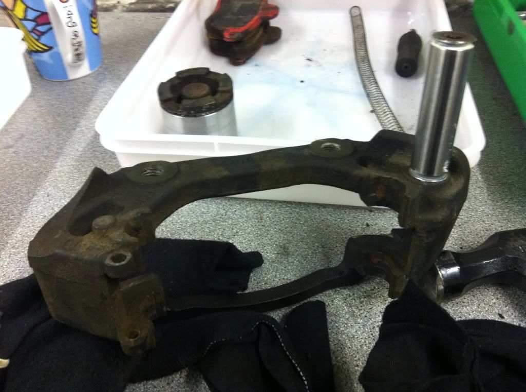

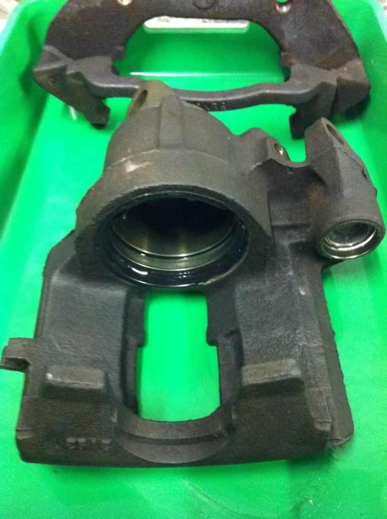

Carrier and slider bolt...
All seals, dust seals, and rubber boots removed ready to be shot blasted and painted...

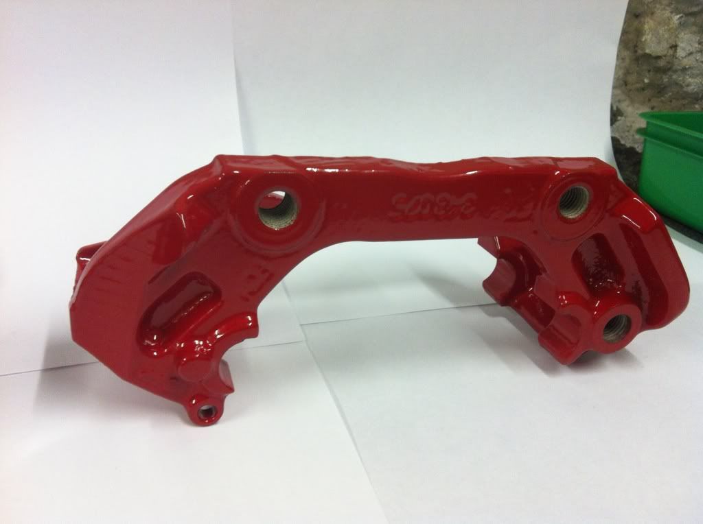

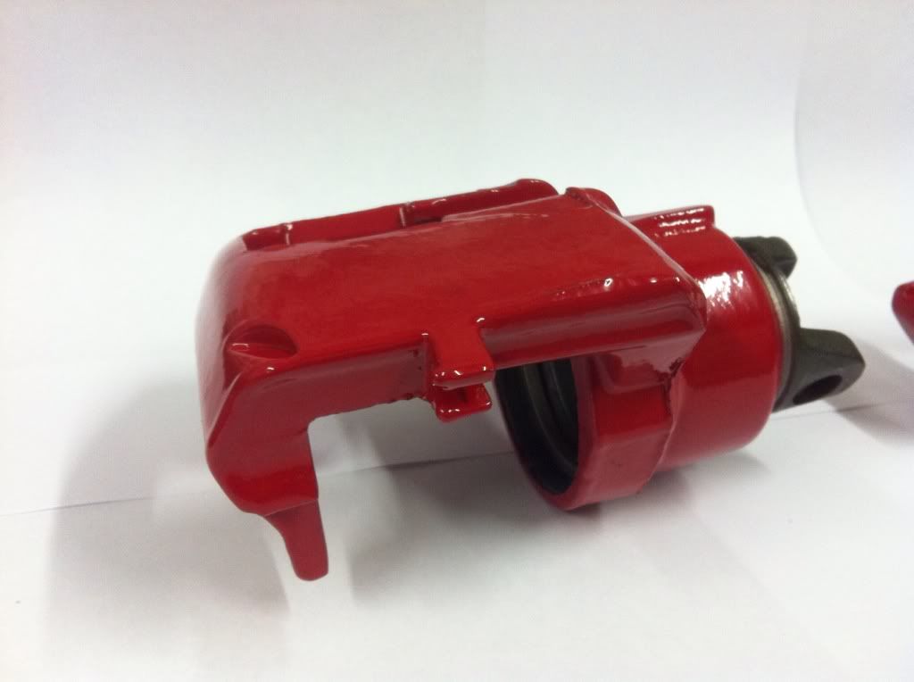

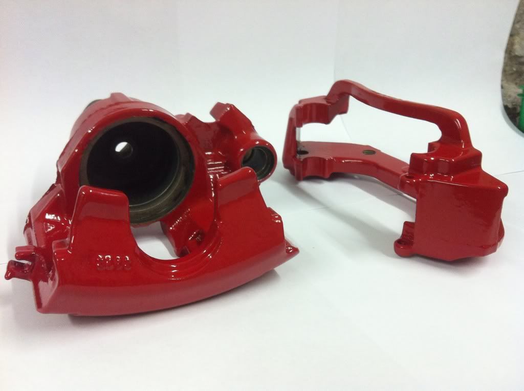

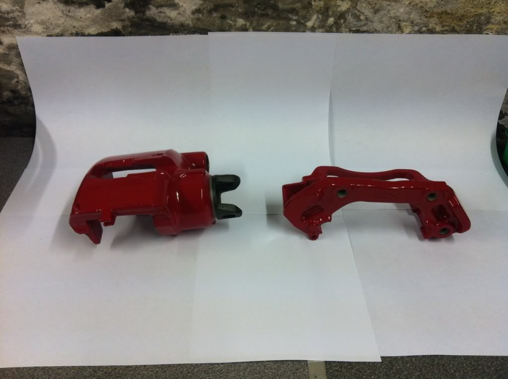

Just got the rears back from the painters today!.. blasted and powdercoated:
I think I must have been a magpie in a previous life, I just love picking shiney things up from the powdercoaters!

Hi fella, its easy enough to get them off, unbolt them from the mounts, disconnect the brake line/hose. (Im replacing all the felxible hoses on the car with Braided lines), then catch the brake fluid in a container.
The difficulty if you want to blast and paint them is that the caliper(s) will need to be stripped down. That means taking all the seals, dust covers etc off. quite a time consuming process. If you are not too confident attempting this then there are places that can do it for you.
If you want to do a quick job then you can mask off all the rubber parts and just clean the calipers in situ, then spray paint them, but for me that wouldn't be a propper job.

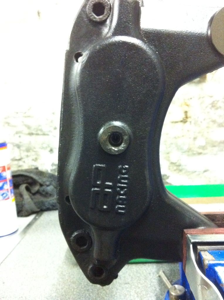

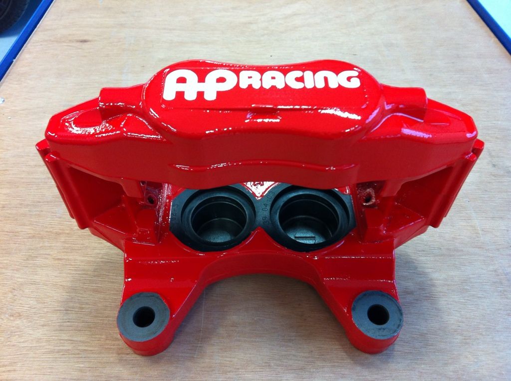

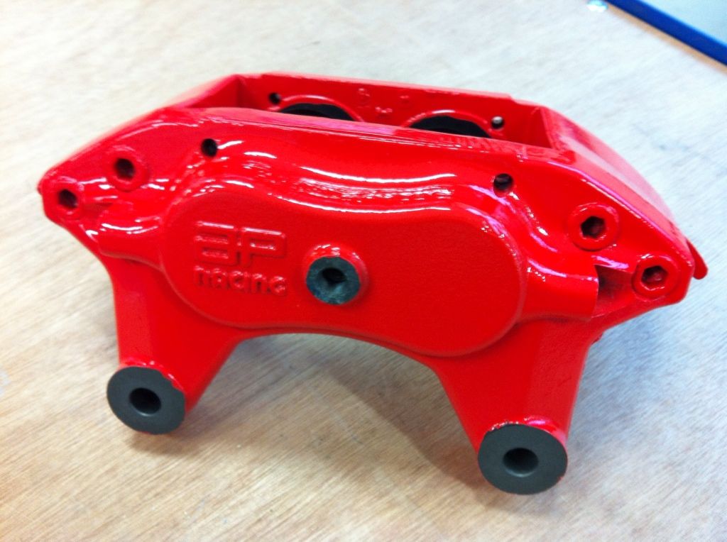

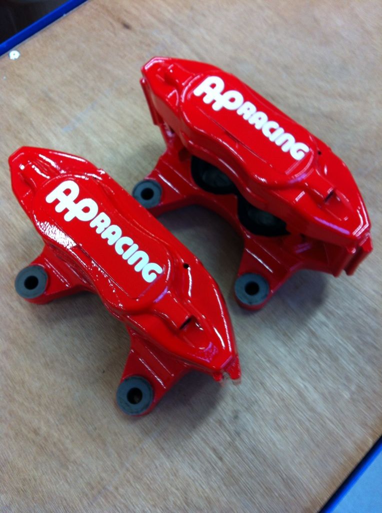

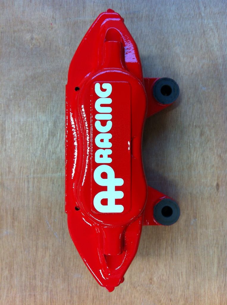

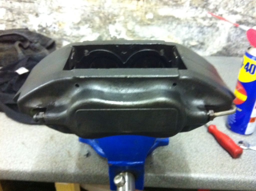

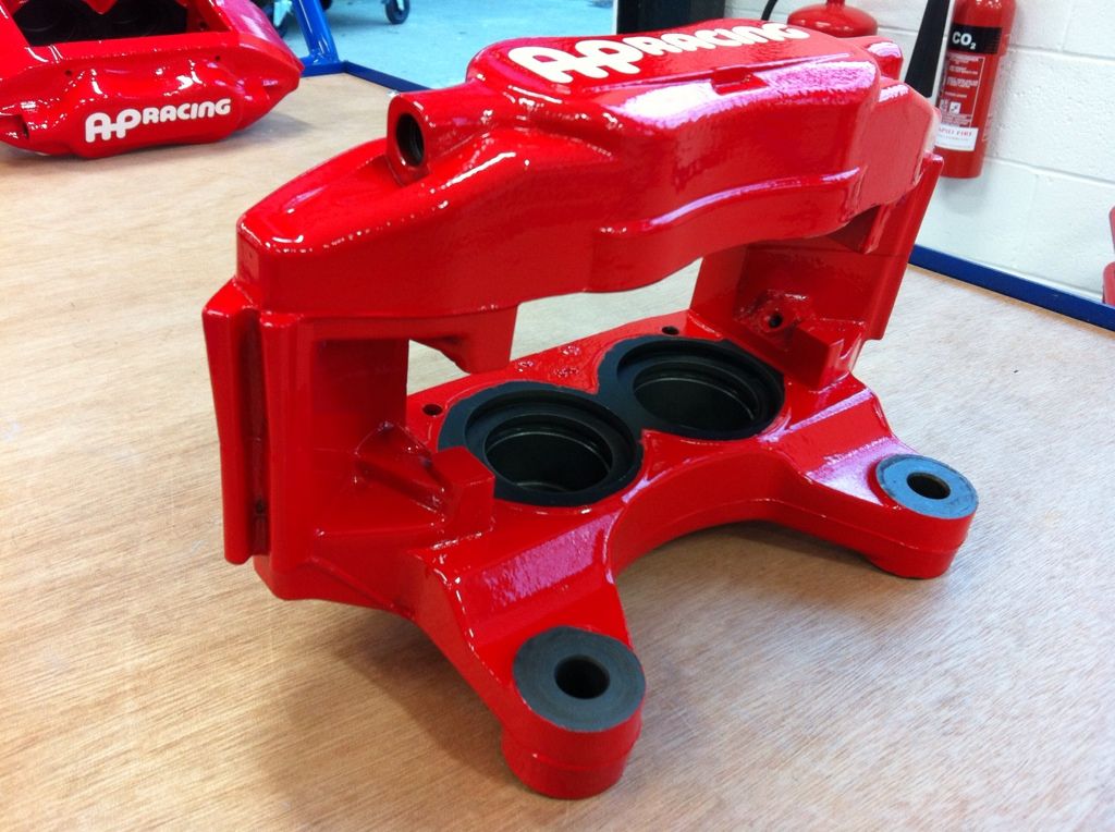

Just got the fronts back from the painters. I went a differnt route with these. The rears were shot blasted and powdercoated, the fronts were etch primed, painted with 2 pack, decals applied then laquered. Im very pleased with the results. Here are a few before and afters...
Before:
After:

Dan, when you had the rears painted how did you ensure no paint went inside the calipers??
Hi Ali, not sure when you posted this, only just seen it! I had my rears painted by a place in Nottingham, I think they use a metalic/foil like masking tape to ensure the internal bore of the caliper does not get any paint inside.

The rear calipers are standard cast metal items off a citroen XM, and are easy to paint. The front ap racing calipers are alloy and have a special anodized finish that is wrecked if they are shot blast, so thats why I opted to have them etch primed, spray painted and laquered. a local paint specialist in Brighouse did these for me. I sourced the AP decals off ebay! They are heat resistant specific ones for brake calipers. (sorry I have probably already posted this above, but its so long ago and I cant be arsed to read it all again :-)
