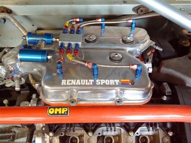

Mine was drilled through both sides with a full length tube section inside to strengthen............
You can see a couple here to get the idea...........

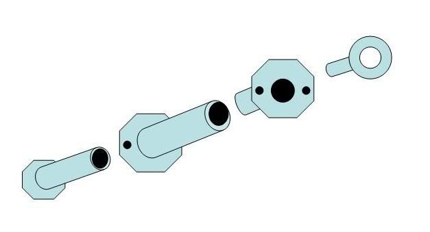

OK CHAPS!
Opinions please!
I've come up with this idea now :-
Sort of a combination of all the other ideas.
The idea being that I can use my exising 7/16th eyebolts (there's lots of reasons for this) and NOT have to damaged to box section by grinding off my existing welded on nuts.
Internally threading the tube should provide a lot of strength.
Do you think the BACK END (engine side) of the tube will be sufficently strong with just a weld on protuding tube ???
Any more advise much appreciated. :D
P.
Tube section through the box and bolted at each end with another tube inside that the eye bolt threads into............
dodgy diagram
Yours is a nicer pic than mine!! :wink:
Back end weld is fine if the steel is quality and a good size and welded properly.

Tims solution - which I've seen and is better than mine - is very robust

the sleeved solutions are the answer

Thanks for all this everyone.
The diagram provided by TRW1 makes perfect sense but this is one hell of a thing to engineer for someone like myself.
I'm just thinking of using the "middle bit" of his diagram - ie, a threaded tube with a large plate at the back, through a 12mm hole, inserted into the exsiting nut at the front of the box (then welded to hold it in place there).
The eyebolt will screw into this threaded tube - when it's pulled, it will pull on the tube and hence the backplate "spreader".
IE - a bit like my diagram, but doing it this way will mean I don't have to weld at the back of the box section (it's a little tricky with the engine in the way).
I can also then manufacture the "tubey" bits with the back spreader plates on OUTSIDE the car - making things a bit easier.
P.
