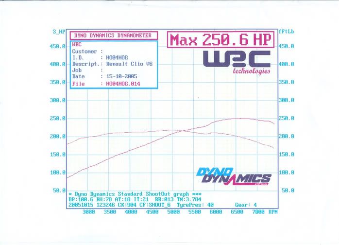

So, just to let you all know that we got 250 BHP on the chassis dyno with just the lightweight TWR exhaust as the only change from the standard spec and max torque at 5500 rpm. Using 98 RON petrol.

As promised, dyno plot from WRC, peak HP and torque occur about 5300 with max HP at 6200. With only change to a standard 255 engine being fitment of ex-TWR development silencer box.
Figures as you'd expect really. They always show a little less than book figures. My Mk1 engine showed only 217bhp with a quicksilver box but without sufficient air through the side pod to the filter.
With Nitrous it showed 275@6000 and 330ft/lbs@3600!!
Heavily modified since........
