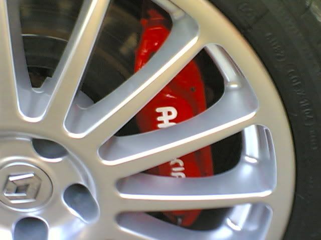

Have you got any photos of your calipers now they are painted? I think I'm going to do mine but can't decide on the colour although blue is the favourite at the moment. My old Puma had blue calipers from the factory on a blue car and really suited it. Although in the pic below they had faided a little :oops:
The AP writnig didnt comeout the best but its still work in progress and i will get it spot on if it kills me
Hmmm, shiny red 8) . Maybe a rethink is in order for me.
Are the "AP racing" decals? Where were they from?

John:
The AP logo is stenciled paint but it wouldnt take to the caliper paint so a rethink is required and maybe Its going to have be Decals,
I just had the logo made into a stencils at a sticker place near me.
If you want some "DECALS" let me know as im gonna get them made next week and ive got them the exact size for the caliper. :wink:
