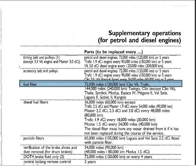

The fuel filter tends to get forgotten about due to it being time consuming and diffiult to change , when you do fit a new one its worth cutting the old one in half to see how much crap is in it :)

how many miles? 20k + needs a fuel filter, its a pain to change but for about ten quid!!!!
