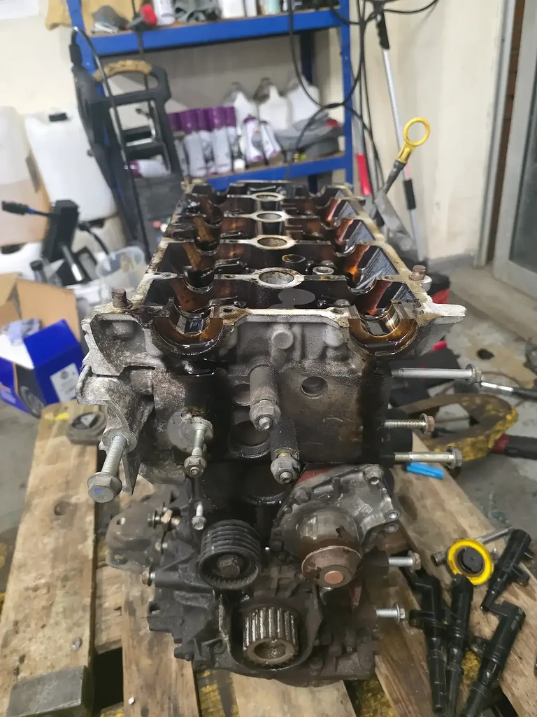

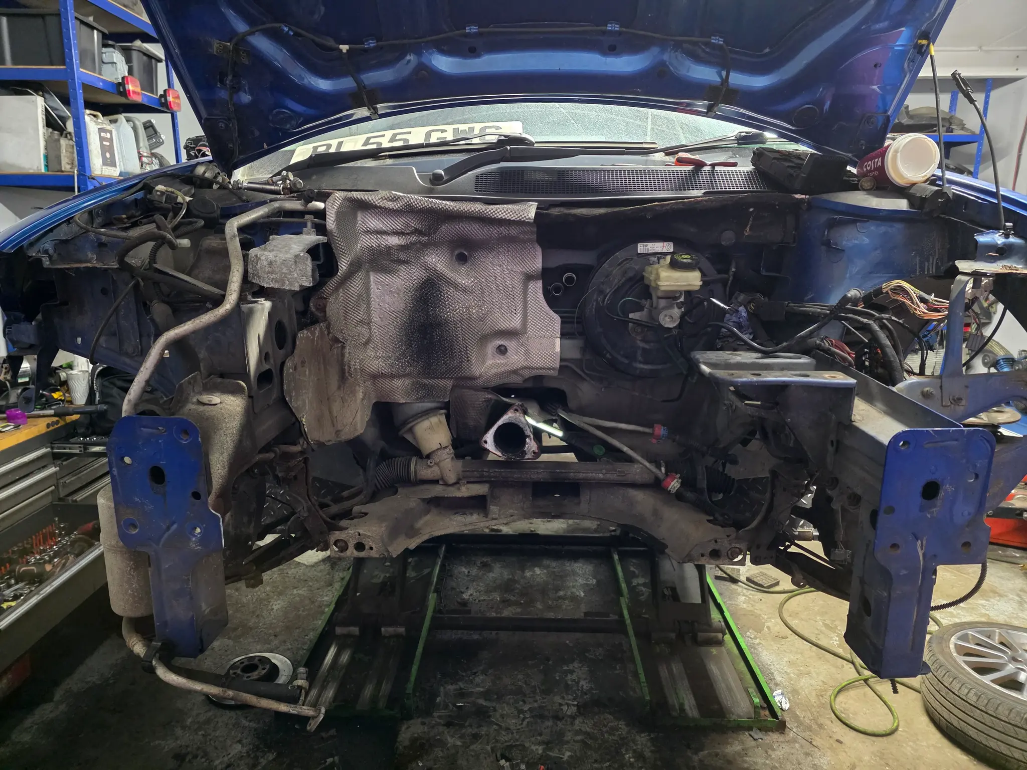

Done across a couple of days after work this week, one meg engine and gearbox removed!
The overall condition of the lump isn’t to bad, no major upsets. In the coming days I’ll be stripping the engine down and hopefully the internals look okay too!
I’ve heard these suffer from the ringlands so will pay extra attention here but so far so good.

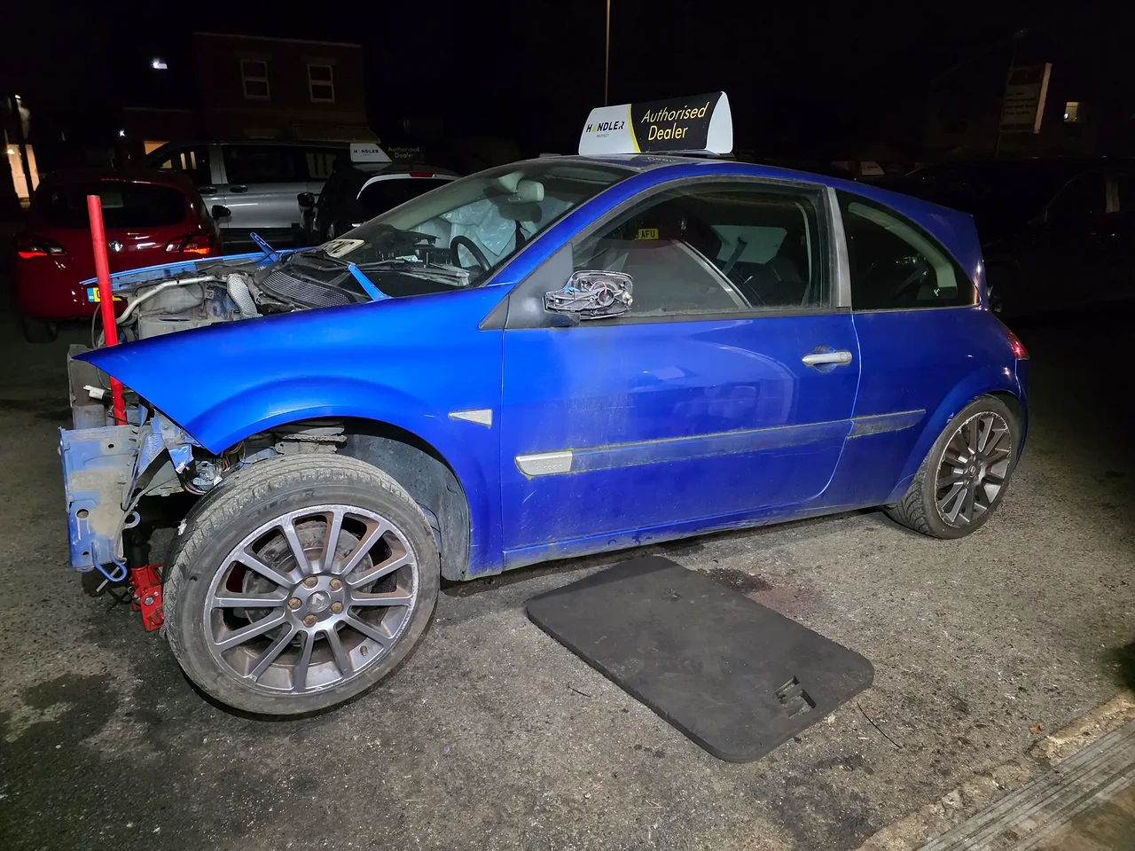

** Little update **
Having stripped all the required parts needed for the swap (plus a few other bits to sell) the megane is now ready to go go go to the scrapyard :grinning_face: Thankyou for your participation in your destruction. Its been fun!!

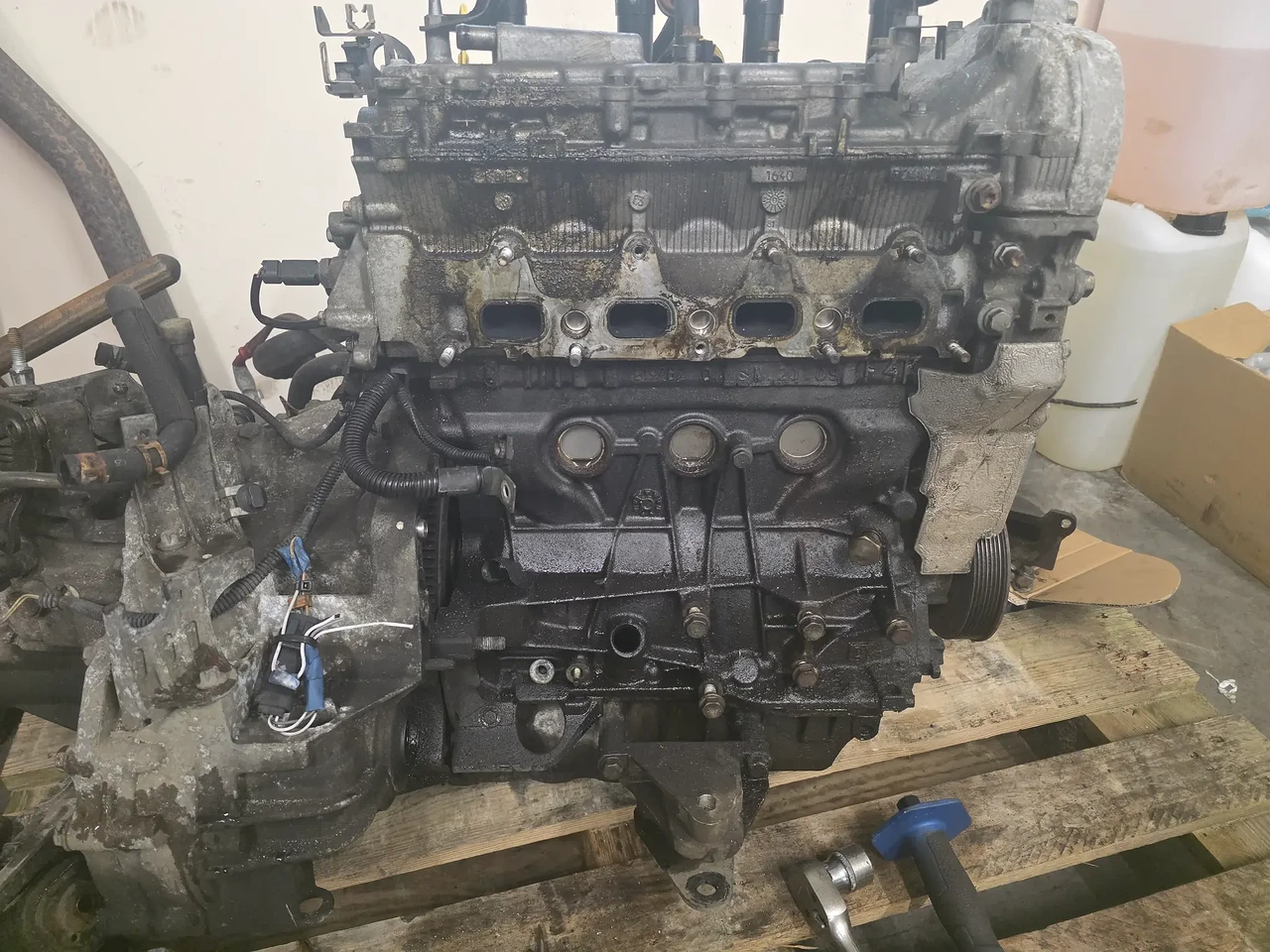

Having made some progress on stripping down the meg engine im pretty pleased with the condition of the exterior. Nothing out of the ordinary.
However rarely the turbo is telling a different story :smiling_face_with_tear: is there play in the turbine shaft. Yes. Yes there is :sweat_smile:

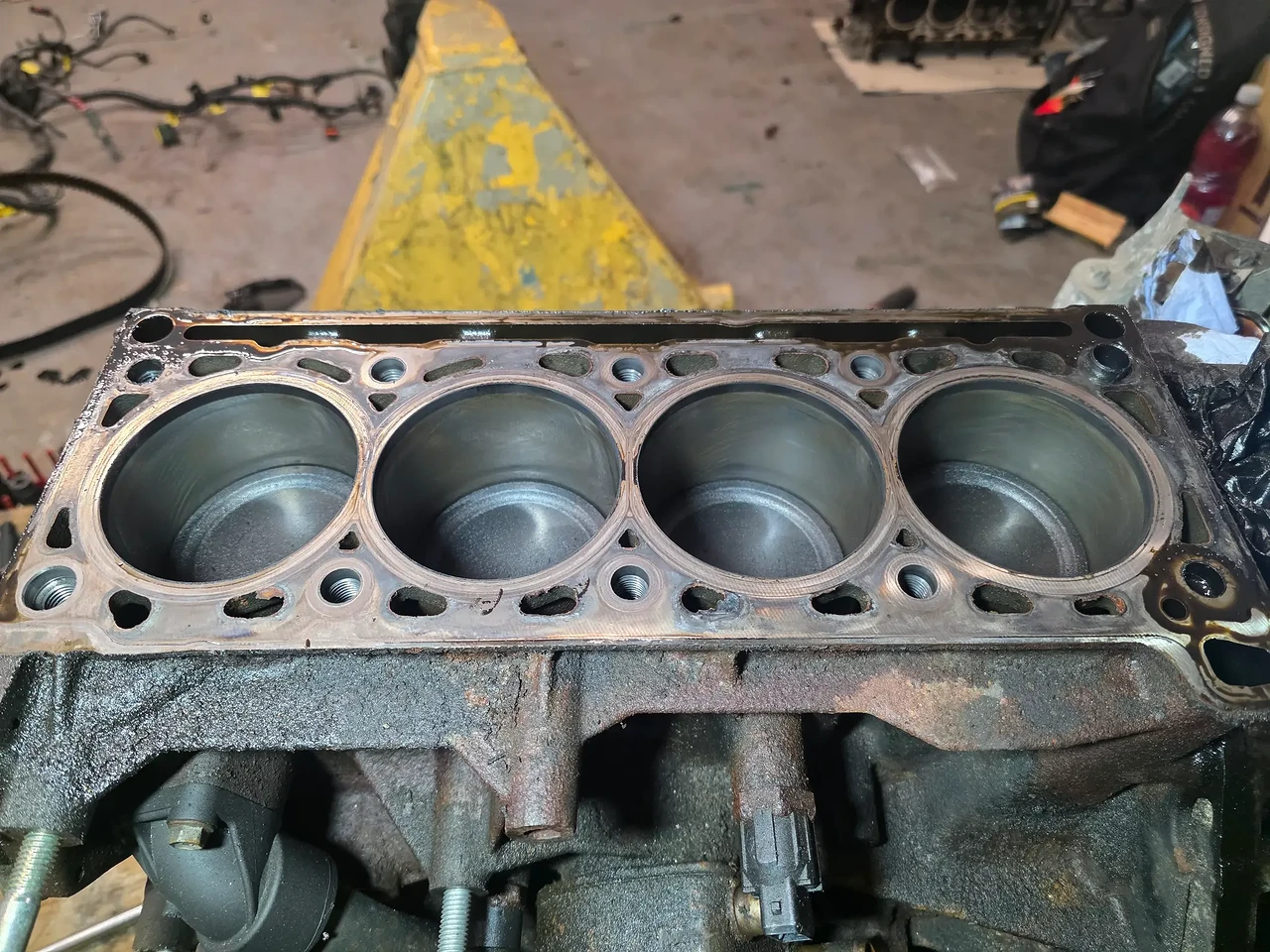

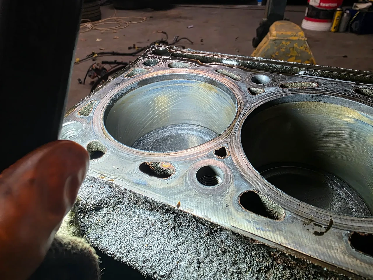

Progress progress progress! Having finally stripped enough to get a good eye over on the block and internals im one happy chappy! Timing belt in good nick (will be replaced regardless)
Cylinder bores and pistons looking gooddd!!

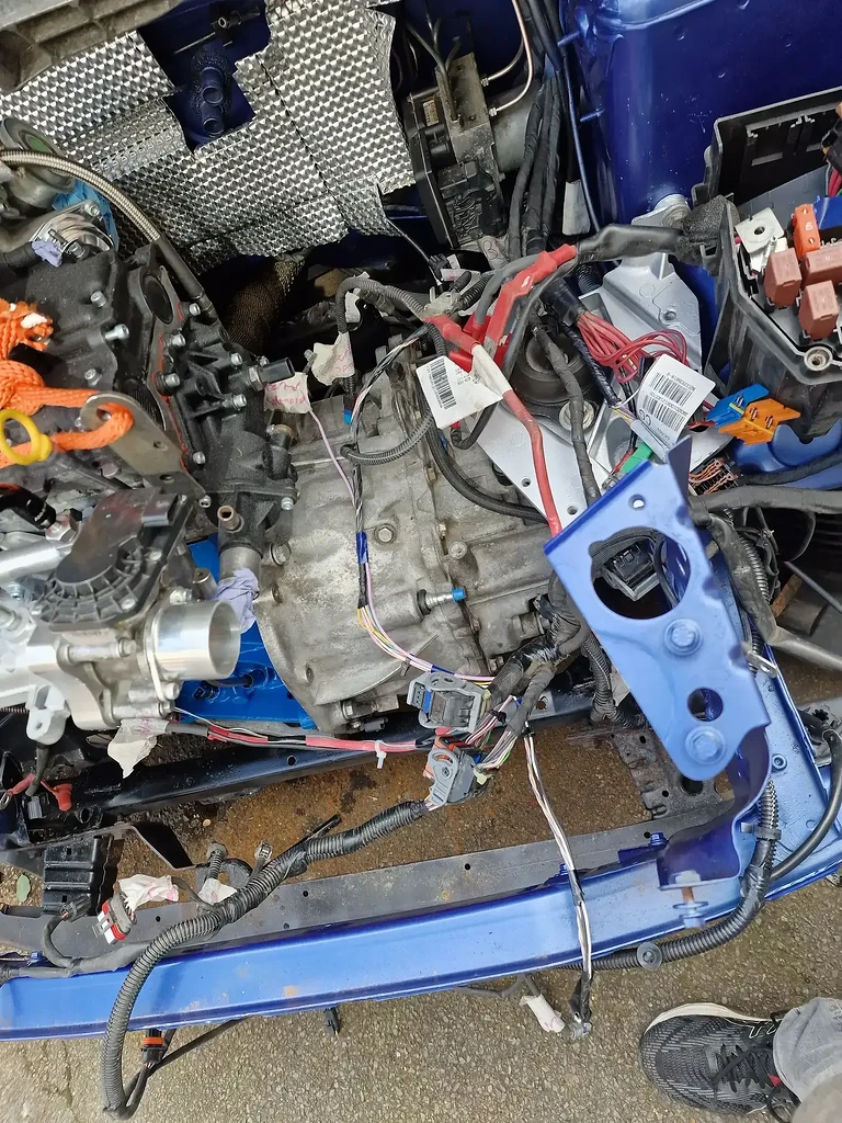

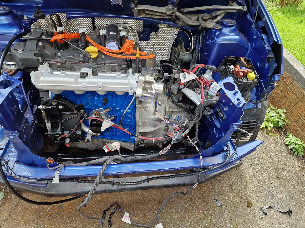

That would be very much appreciated, any help is help! As im sure this is going to throw some curveballs somewhere. Did you use the 6 speed box from the meg?
I tried and fitted the ndo yeah, you’ll need a quicksilver for it as it won’t clear the gearbox mount though, and you have to cut the chassis. Even then it’s a hell of a tight fit
But, when people do the 197 swap they also use a clio 6 speed box, so there may be better room for the Meg 250 box
Hiya, forgive me if im having a simple moment here but quicksilver?
I was aware that some modification may have been needed to the chassis but in all honesty I’ve been a little blasé to it thus far and just seen it as another hurdle to overcome.
Am I starting to bite off more than I can chew here?
I have my reasons for wanting the NDO box retained, mostly for the cost side as swapping to a clio box means swapping sumps and all sorts.
The idea of getting the donor car was so that I didn’t have to collect various components.
Ive seen it done on a few twingos
Namely the green one on YouTube. But can’t find any decent info on how it was actually achieved.
I was hoping in doing this build and using the NDO box that I could well document it so others can feel brave enough to undertake this project to!! So many options :joy:
