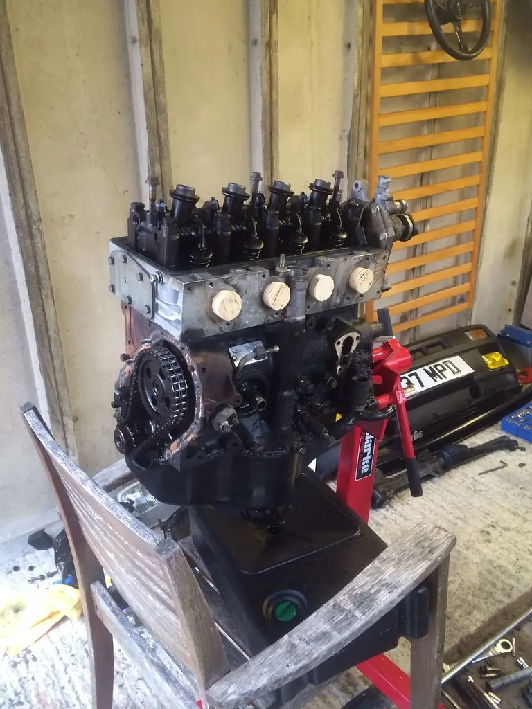

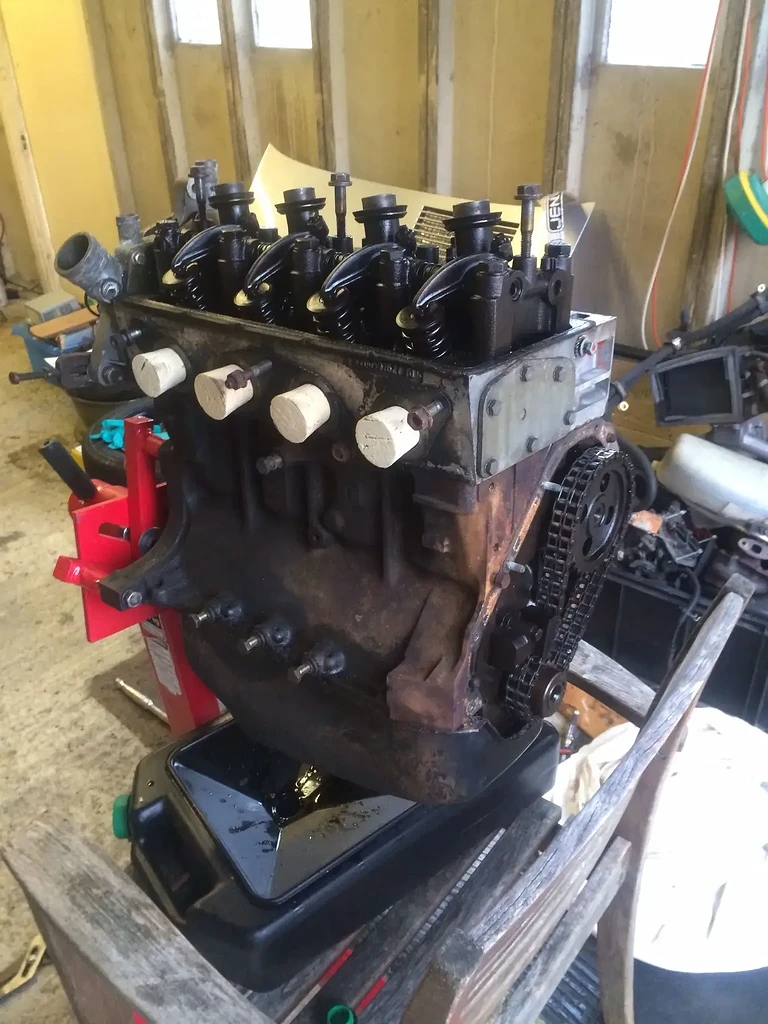

Engine now on the stand and getting ready for cam removal and a clean
Great work :slight_smile:
properly stuck now though, i need to get the chain off to remove the cam? ill start a thread in technical to answer it, my haynes doesnt actually say how to do it, grrrrr
