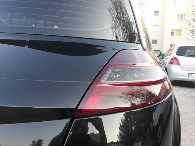

Smoked rear lights and turn signals:

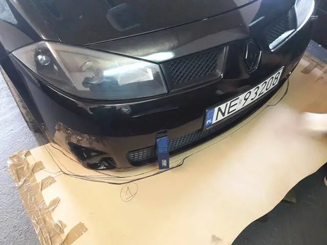

Yestarday I have visit a local company Time Attack Customs-https://www.facebook.com/TimeAttackCustoms/ specialized in the production of custom splitters, canrds and diffusser. Photos during designed custom items for Meg :):):slight_smile:

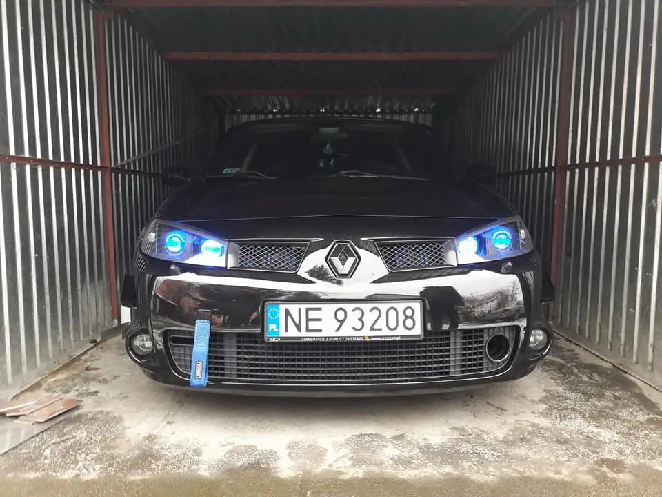

Lights ready and on:

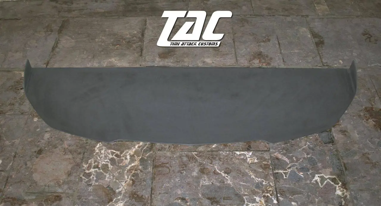

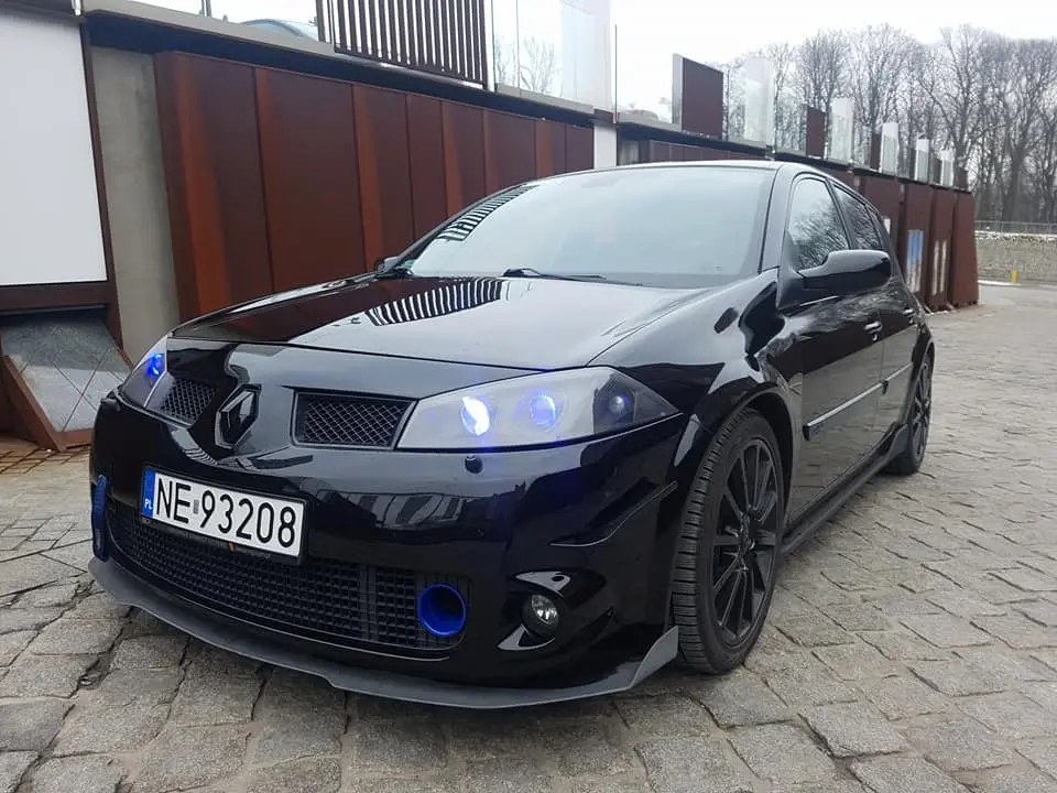

Splitters from TAC:
Canards on the car:

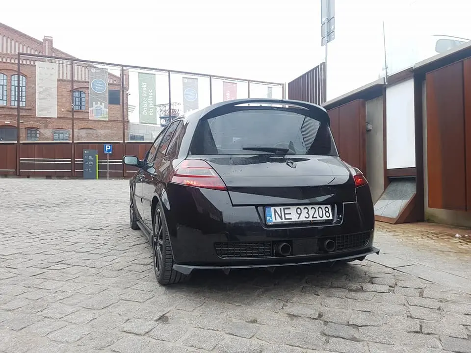

PHII rear bumper grills:

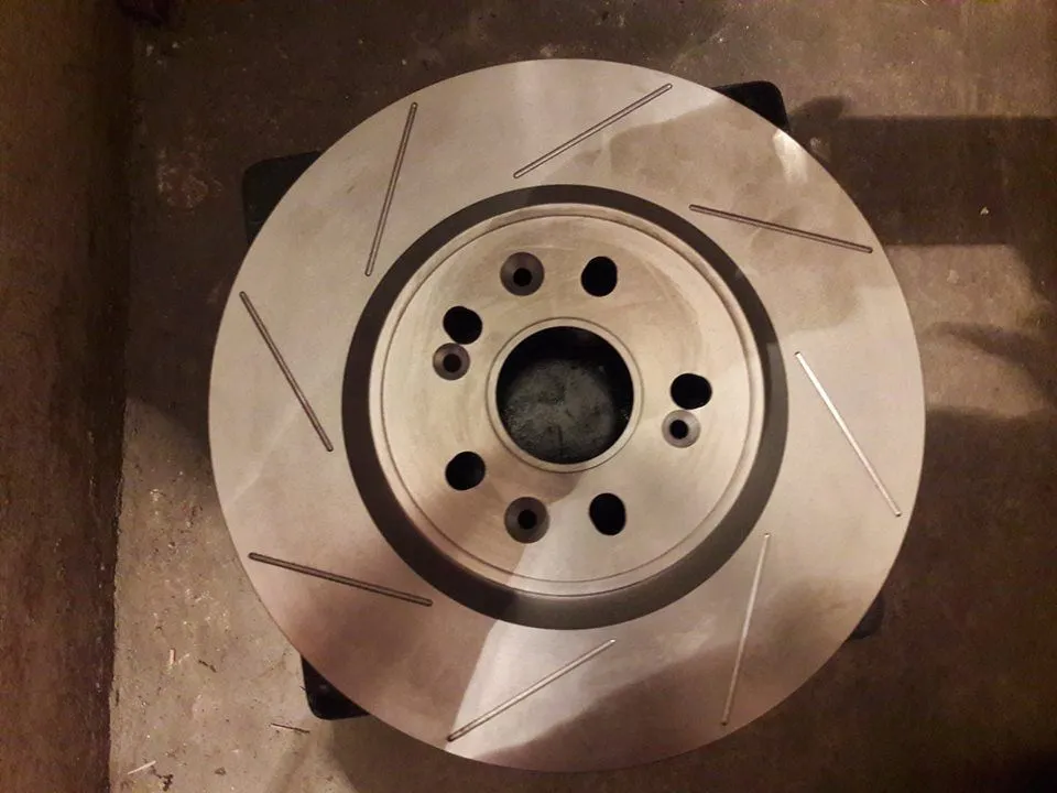

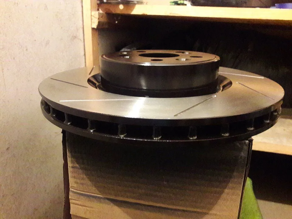

Big Brake Kit. Brake discs from M3RS, spcers, Ferrodo DS2500 and calipers after rebuild on new parts:

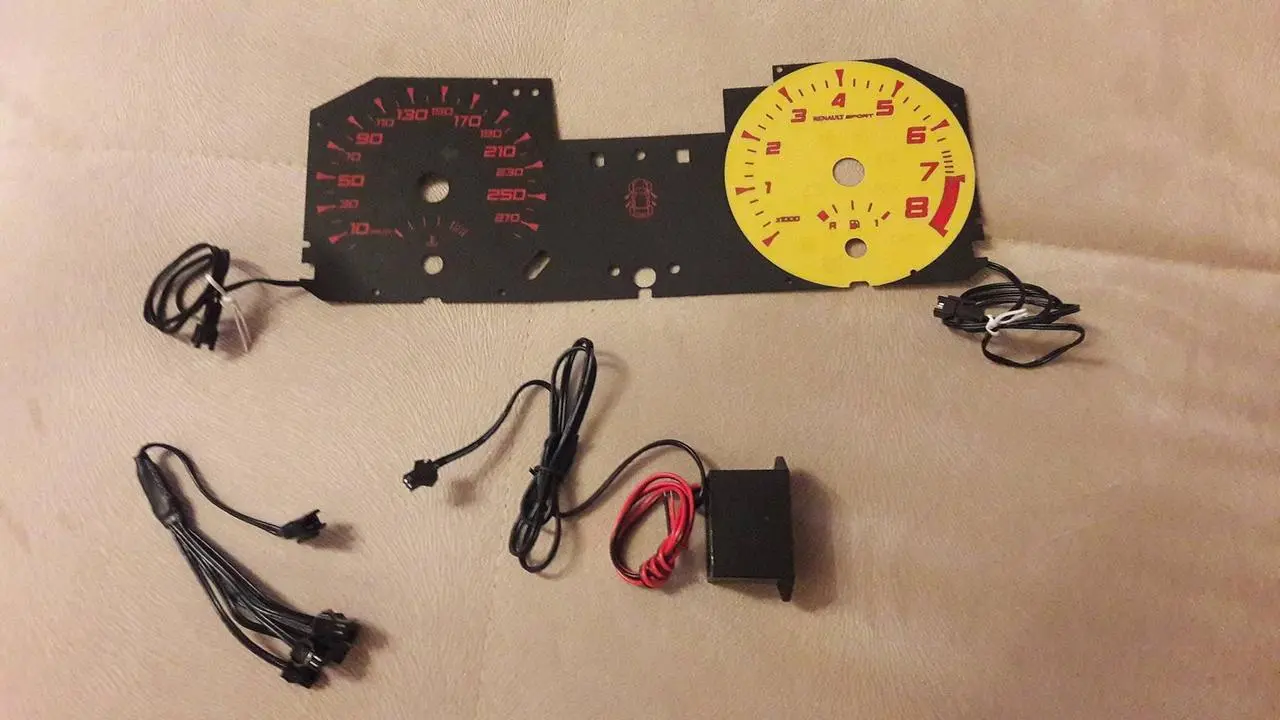

New custom dials :smiley:

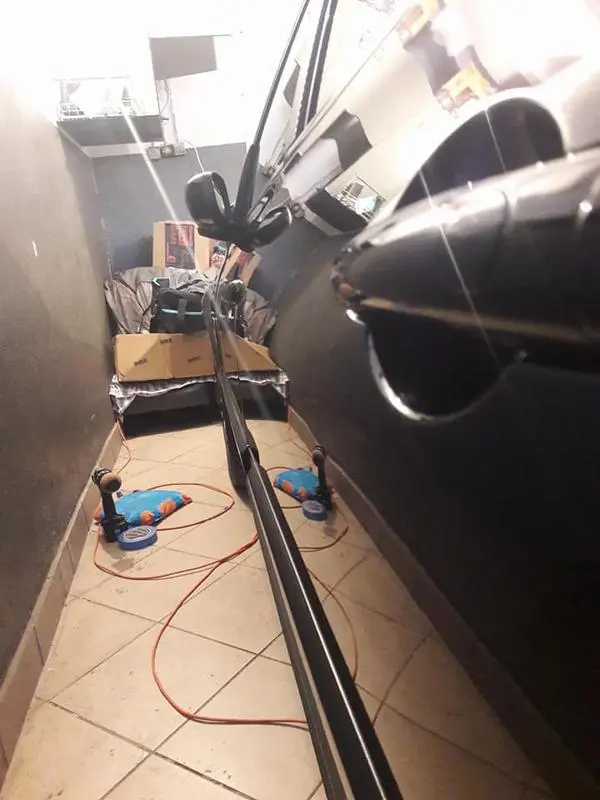

Rear window polishing.
Before:
During the work:
After:

Meggy got a new custom lights :stuck_out_tongue:

Dials on. Live look much better than in the pictures:

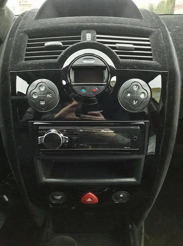

Black gloss console finally mounted, after 5 months :stuck_out_tongue:
Brake discs get painted black + new brake oil - Millers 300 PLUS:

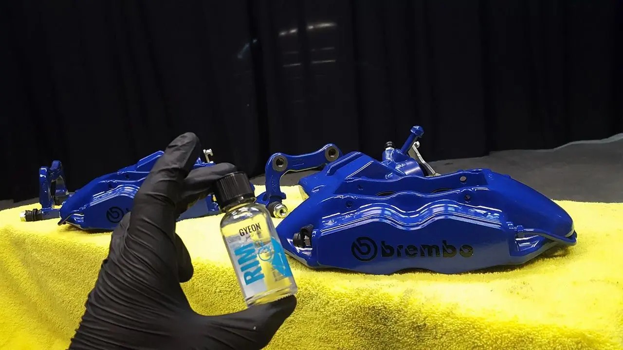

Brake calipers get the Gyeon Rim ceramic coat:
Splitter and diffuser finally on :eek:

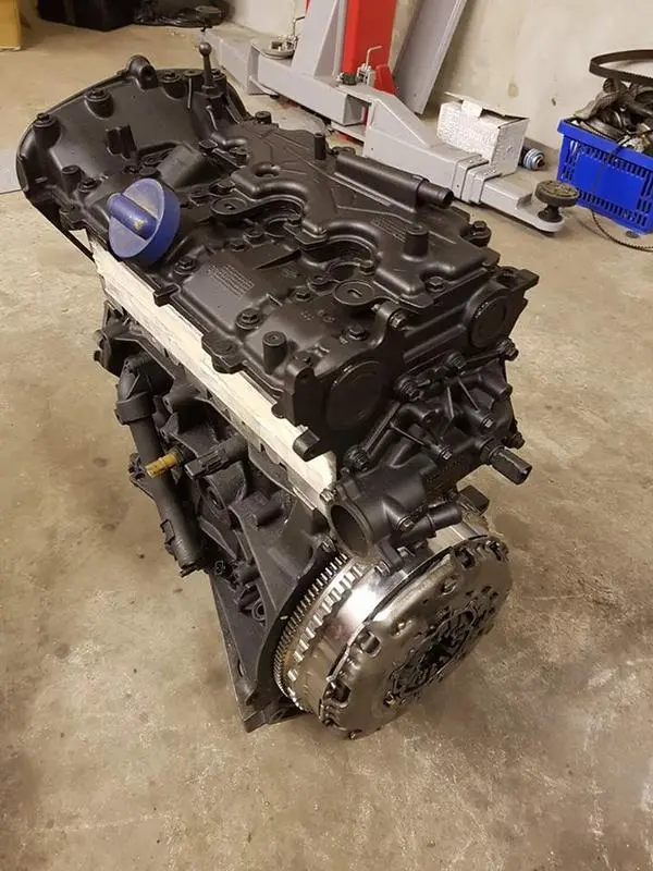

And we start with the engine:
Engine block ready for oversize forged pistons and rest of the bits:
Pistons and rods fitted:

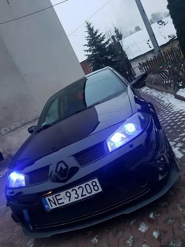

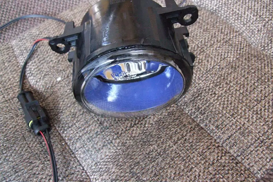

A new headlights design - again :smiley:
Fog lights also have to match the headlights :stuck_out_tongue:

And most importand thing :smiley: Engine is ready :D:D:D we had a small helper, probably the youngest mechanic in Poland :cool:
