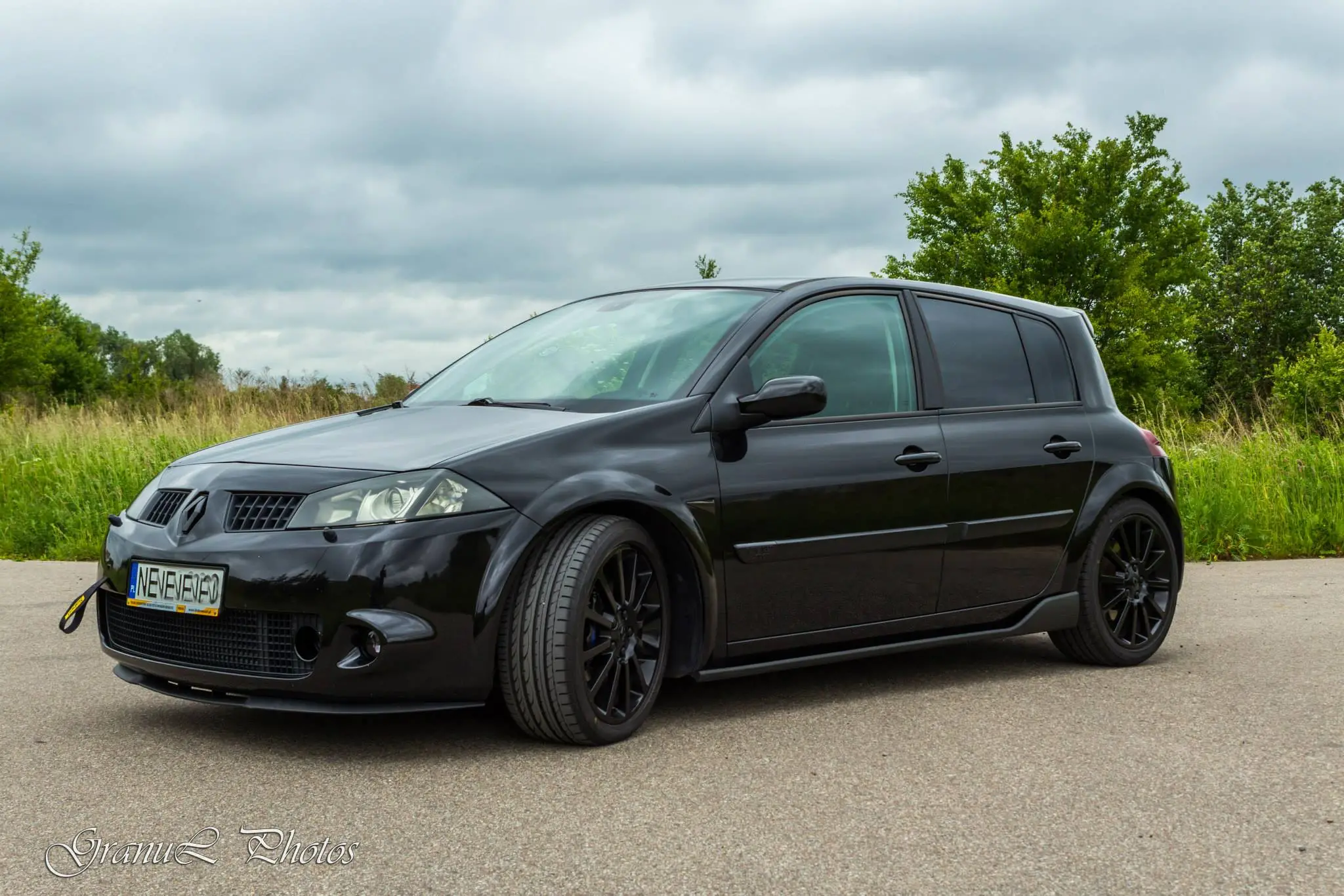

This is my 2005 Megane II Sport 225. I bought it in 2012 and it was look like that:

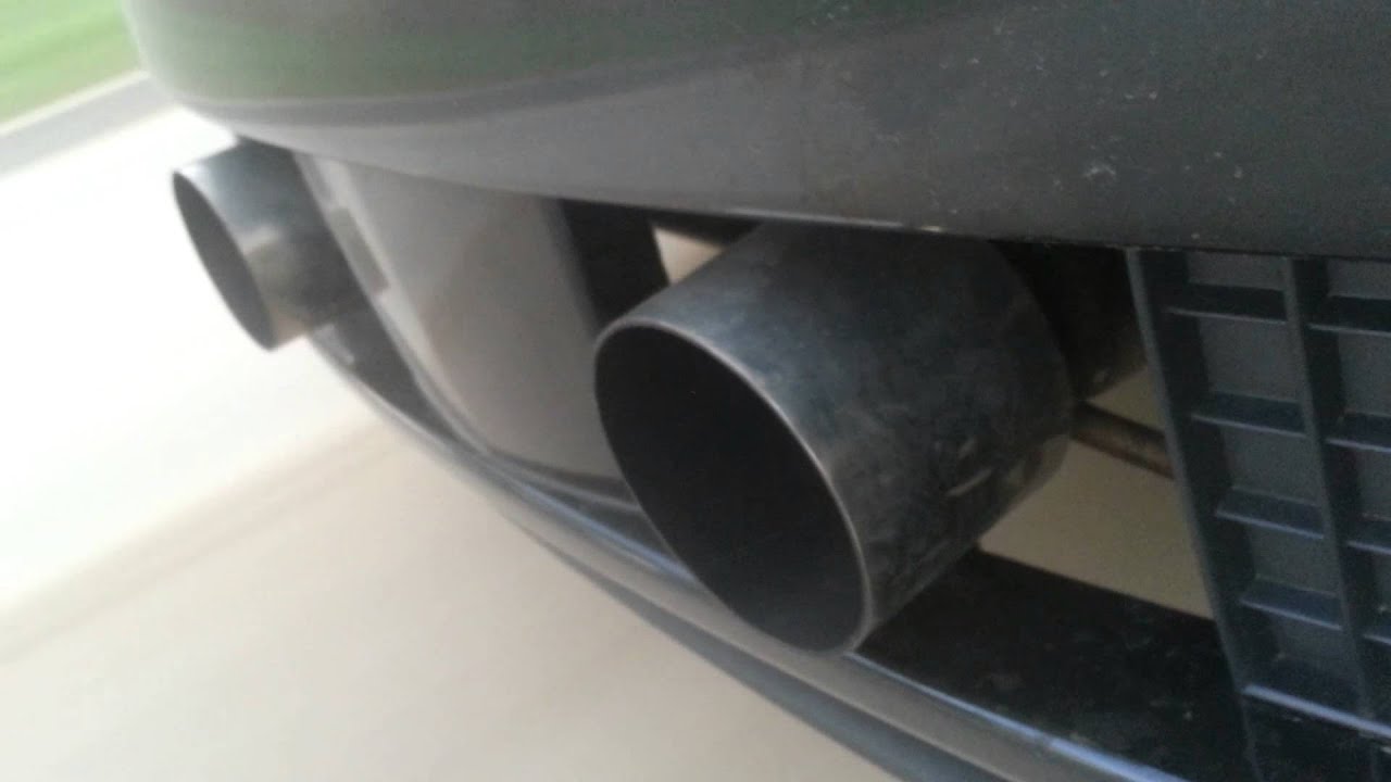

EXHAUST:
  • Custom 2,75" Turbo Back By: Dr-Xhaust With Two RM Motors Mufflers
  • Central Muffler Can Be Switch On Straight Pipe (P&P System)

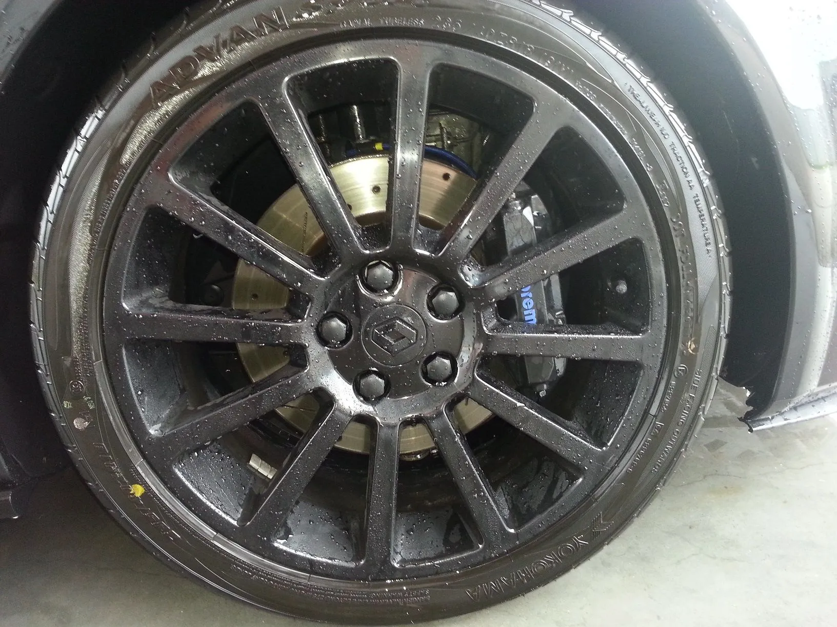

  • Calipers Painted Black (Powder Coating) With Blue Brembo Logo

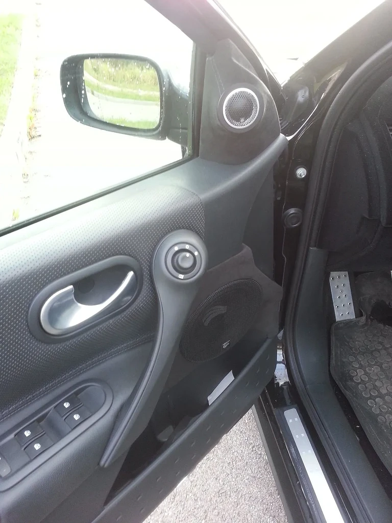

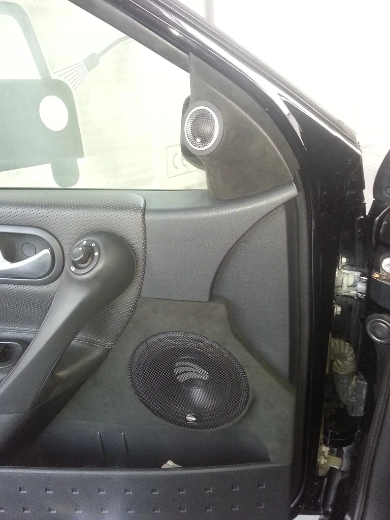

  • Front Speaker System Rainbow SL-C6.2 PRO In Custom Build MDF Panels, Covered In Black Alcantara
  • Front Doors Muted

WOW! Looks great @mek!! :i-m_so_happy.gif:
I love all the suede you’ve put inside!! I’m thinking I may do similar on one of my cars.
Thanks m8 :yes3.gif:
It isn’t a suede it’s a flock :wink: Best part about flock is that nothing is reflected in the front window :slight_smile:
It’s flocking good! :smiley:
It’s good to see another black 5 door 225 owner on here. Mine’s a ph 2 :slight_smile:
Looks great, I really like the steering wheel! Very different, not seen that before.
Thanks :slight_smile:
DaveL485 - this is a standard steering wheel with flock on the air-bag and alcantara on the wheel.
Yeah really like it, very tempted to have my ClioSport one done similar!
Nice :slight_smile: On the last photo alcantara looks very gray - because of light, in fact alcanatara is much darker and looks better than on photo :wink:
5 doors in black look as hard as nails. Really like the look of yours buddy. :clapping.gif:
Thanks M8 :slight_smile:

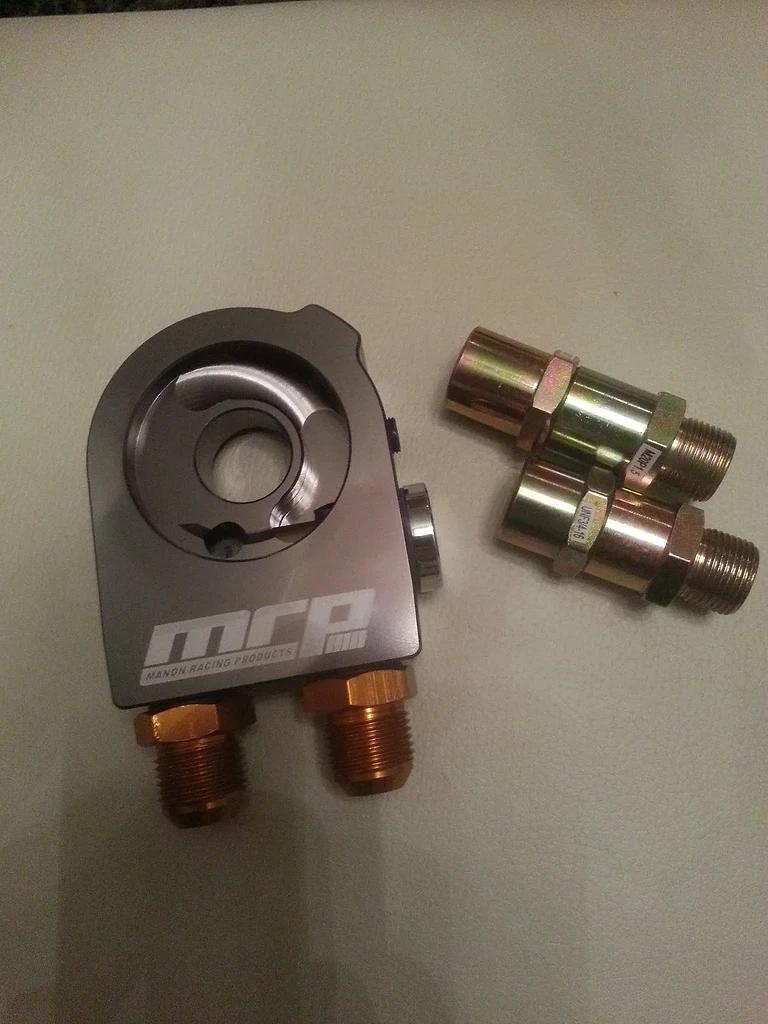

16th Row Setrab Oil Cooler, Goodridge Fittings And Wires + Manon Racing Products Sandwich Plate With Thermostat.

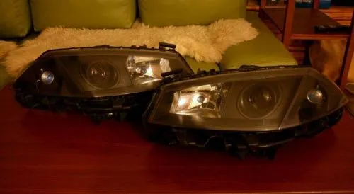

Head lights interior was painted black, get install Bi-Xenon lens and blue “Devil Eye”

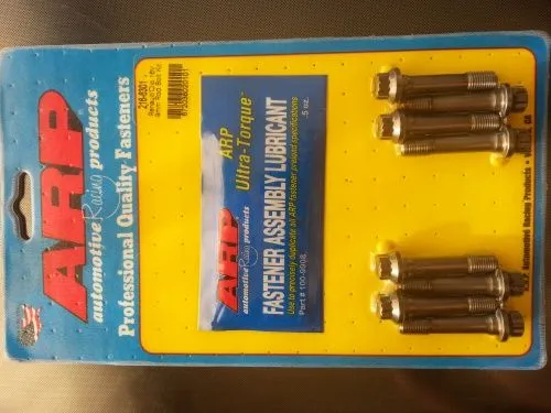

Few “Power Upgrades” ARP rod bolts, 265LPH fuel pump DW65c, hybrid turbo T19

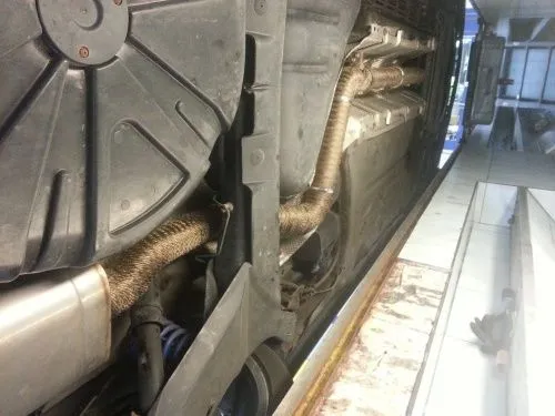

AEM DryFlow + High Temp bandage for exhaust wraping:

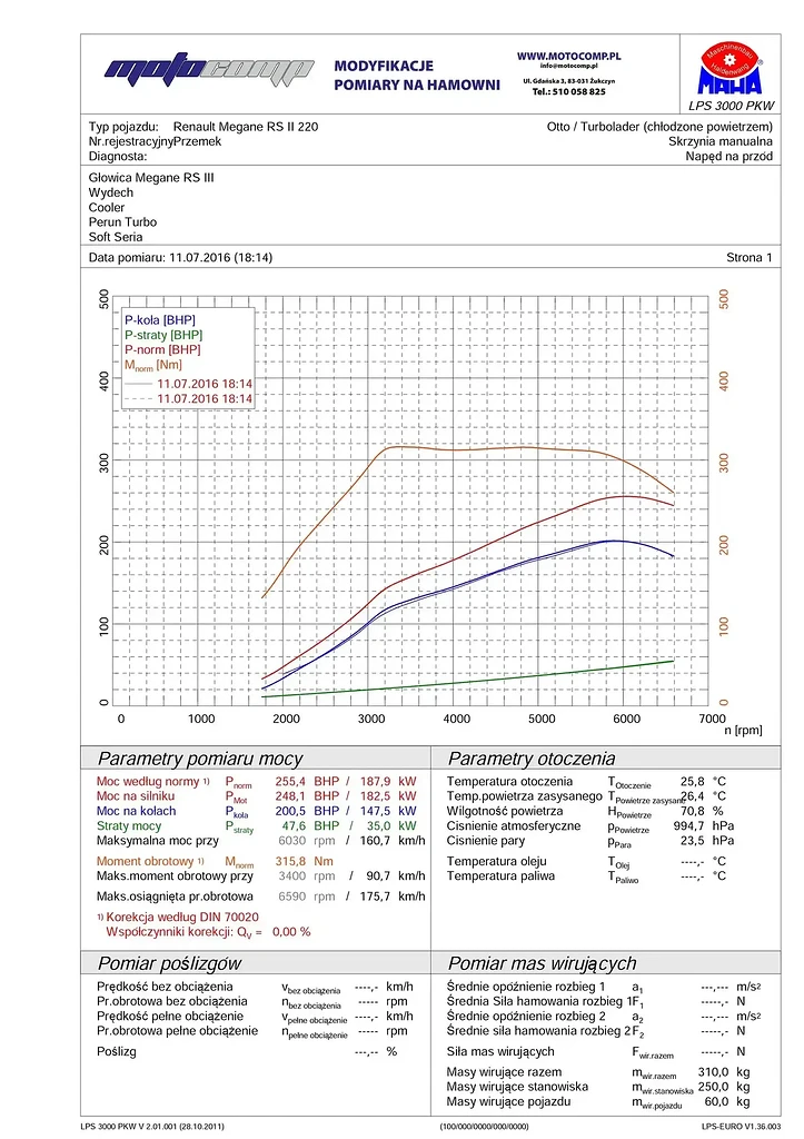

And this is the score after new ecu program: 334HP/400Nm :stuck_out_tongue:

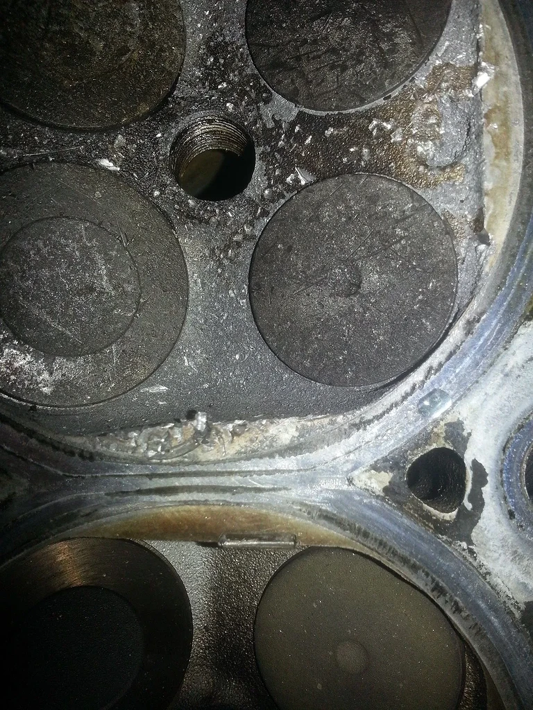

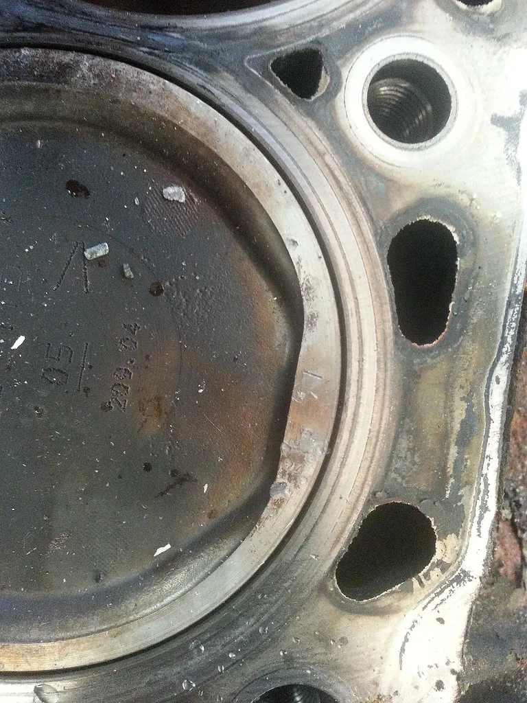

We go down with power to 310HP and 394Nm. On the last dyno run engine explode :bb:
I have decide to purchase Megane III RS engine for swap block with internals. The first two engines proved to be flooded with water, only the third turned out to be good.

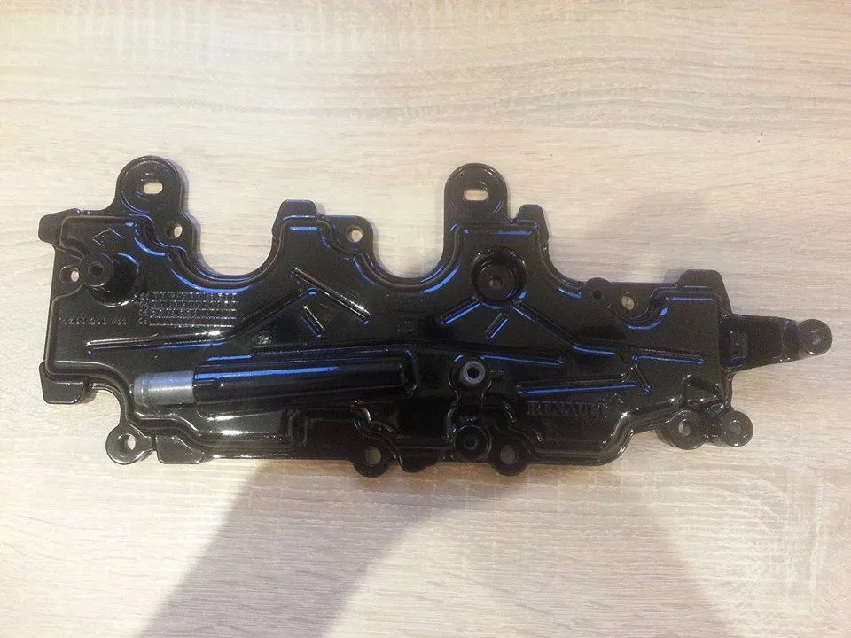

In the meantime, I painted the interior and engine components:
Rebuild turbo T20:
Intake manifold and throttle PTFE gaskets, 3mm thick.

What caused the engine fail? Looks like detonation to the max?
I think too less fuel, pogram we made on stock injectors.

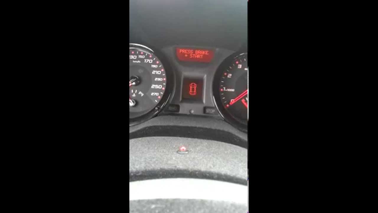

First start :clapping.gif::clapping.gif::clapping.gif:
Megane is alive :bi::bi::bi:

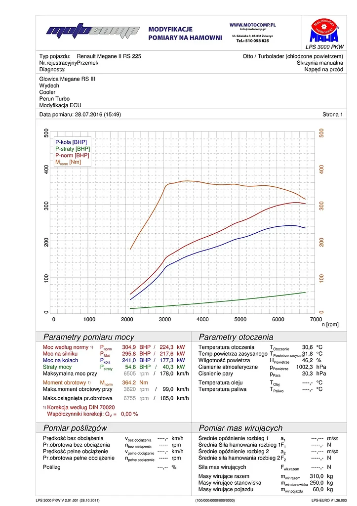

OE program graph: 255HP/232LB/FT
1,3 bar boost: 304HP/268LB/FT

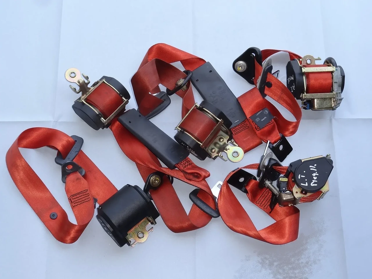

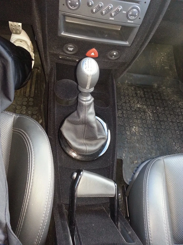

Red satbelts and gearknob insert

What model are the red seat belts from?
Seat belts are from Megane 2 Sport ph I
