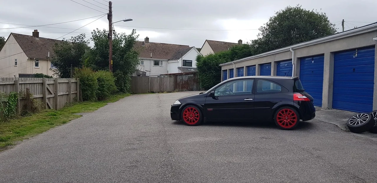

Did take it for an outing before taking it off the road the other weekend so just a few pics from not so sunny Cornwall
And an accidental tripod :smiley: :

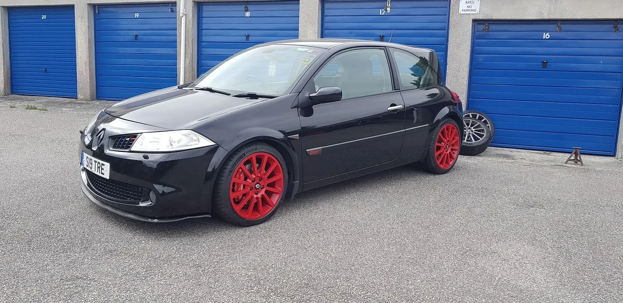

The car has barely been used, clocking only 3k between MOT’s, i have had a spare set of wheels for awhile and decided to try them in Renault Capsicum Red. Bought some paint and gave them a go myself, the finish isnt great so will be redoing them now i have decided i like them:
I have also played around tinting the side indicators and will probably try the headlights soon to see if i like it with a very light smoke

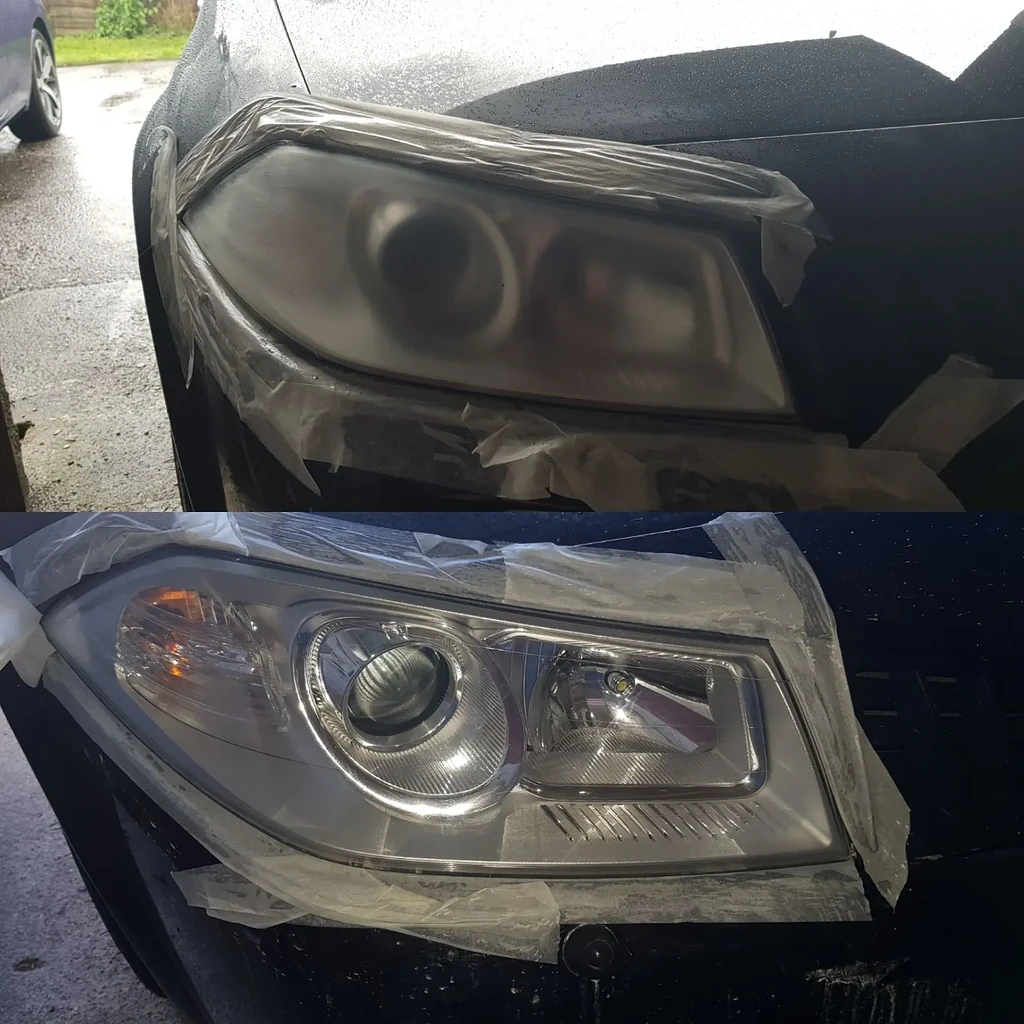

Ended up buying a set of headlights off ebay to replace a cracked one. The lenses were pretty rubbish when they arrived so fitted them and set about restoring them:
Wet sanded with 400, 800, 1500 and 2500 grit sandpaper. Compounded with Meguiars ultimate compound finished with Meguairs M105 and sealed with meguiars headlight coating to protect for now
