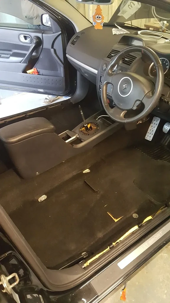

Last weekend we set about fitting the carpet, turned out to be a simple little job:
All stripped out - we noticed some mould on the foam underneath so sprayed it with some mould killing spray and then some oust

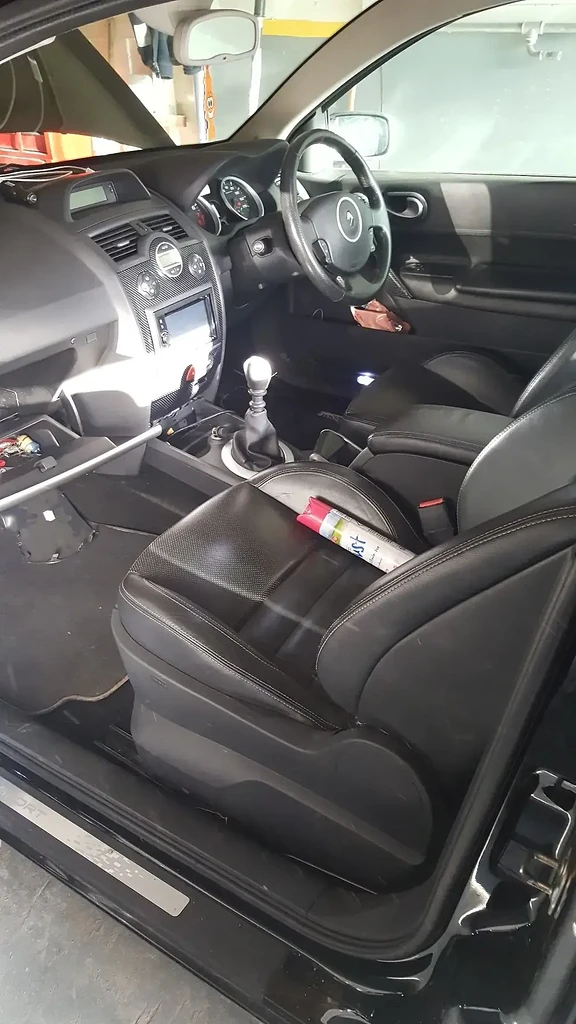

and the new carpet in :).. this carpet was a much nicer colour than the one fitted before which was a bonus :slight_smile:

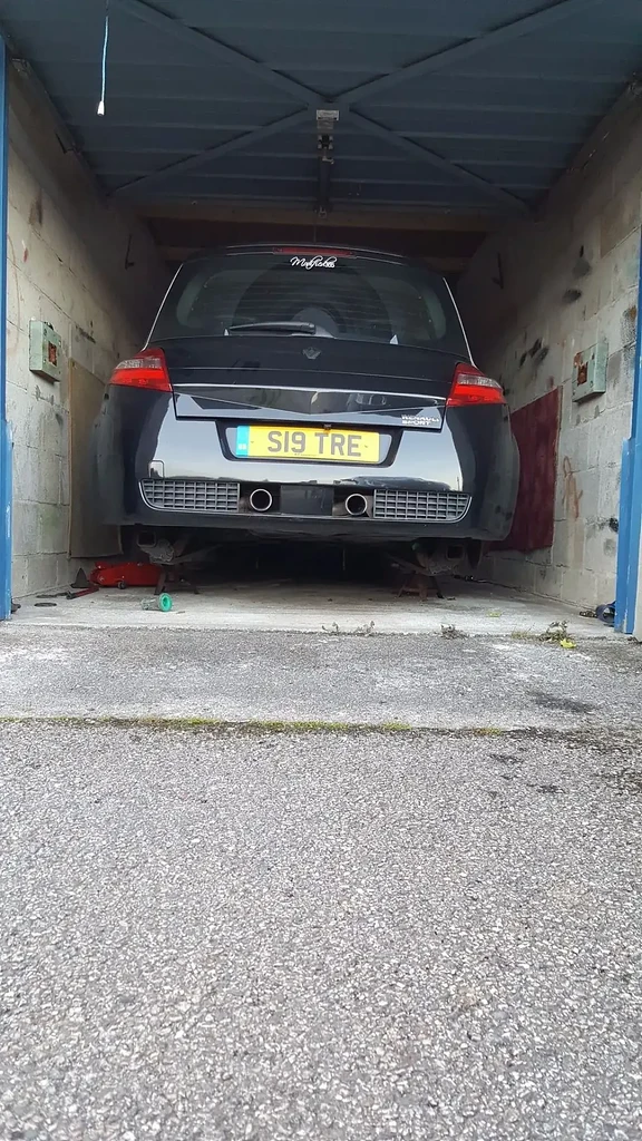

Got them off the car and the car onto stands in a very very tight space!

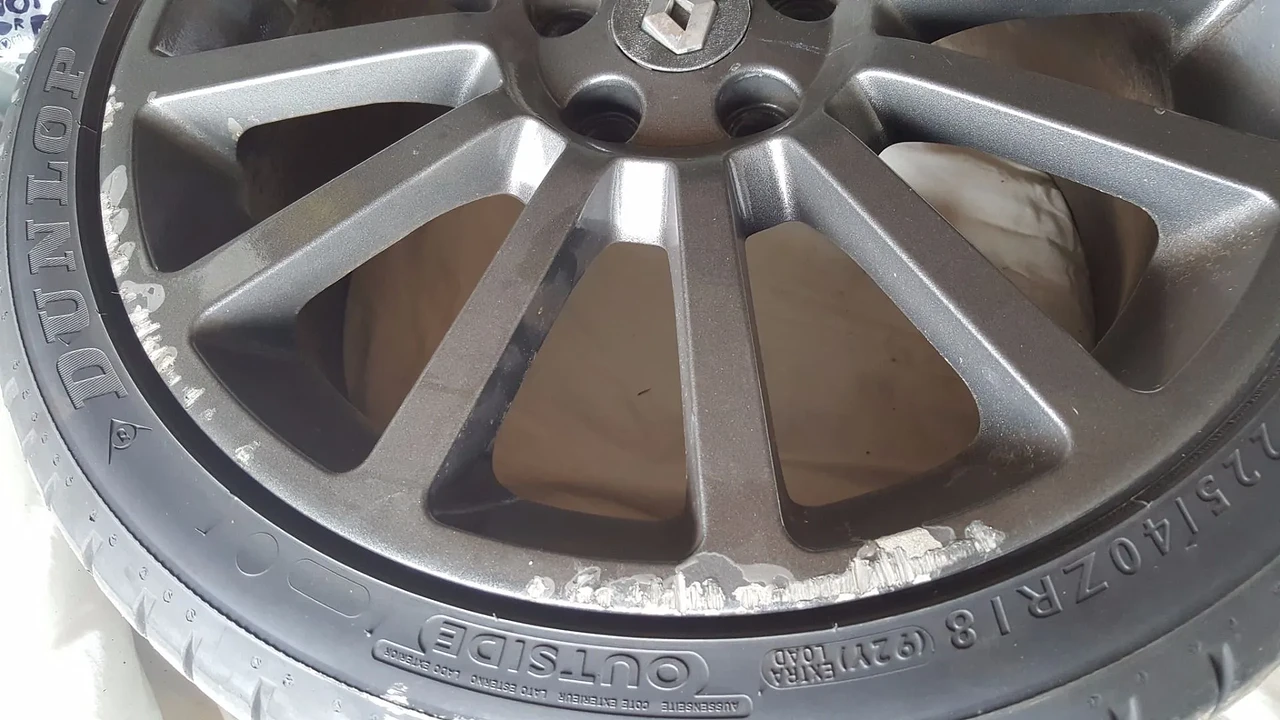

This was the damaged alloy before i started on it:

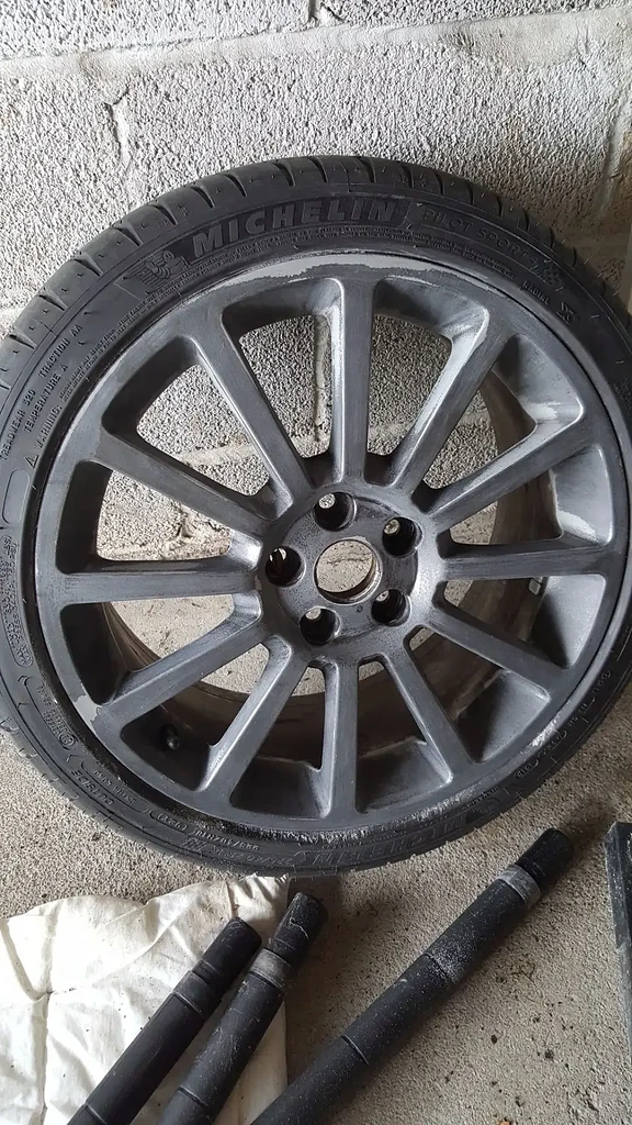

I flattened the wheel back to bare metal and then flattened off the damage using a file and sand paper
Then added and sanded back the smallest amount of filler i could get away with:
Then after some time spent with some filler primer and alot of sanding the damage is almost invisible:

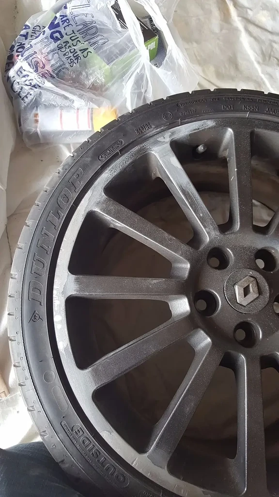

I have started to prepare the other 3 alloys,none of these were damaged but the paint on them was peeling and flaking. So after alot of snading i have got them to a nice smooth stage ready to primer:

All nice and smooth wit the filler primer:

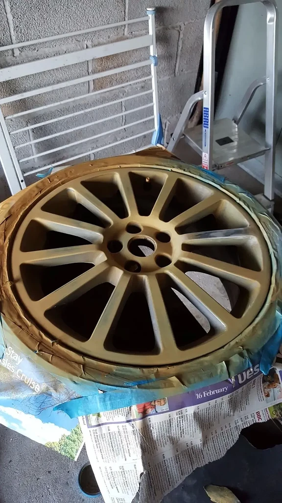

Then onto the normal primer:
Gave this a good flat back to make sure all was smooth and ready for paint

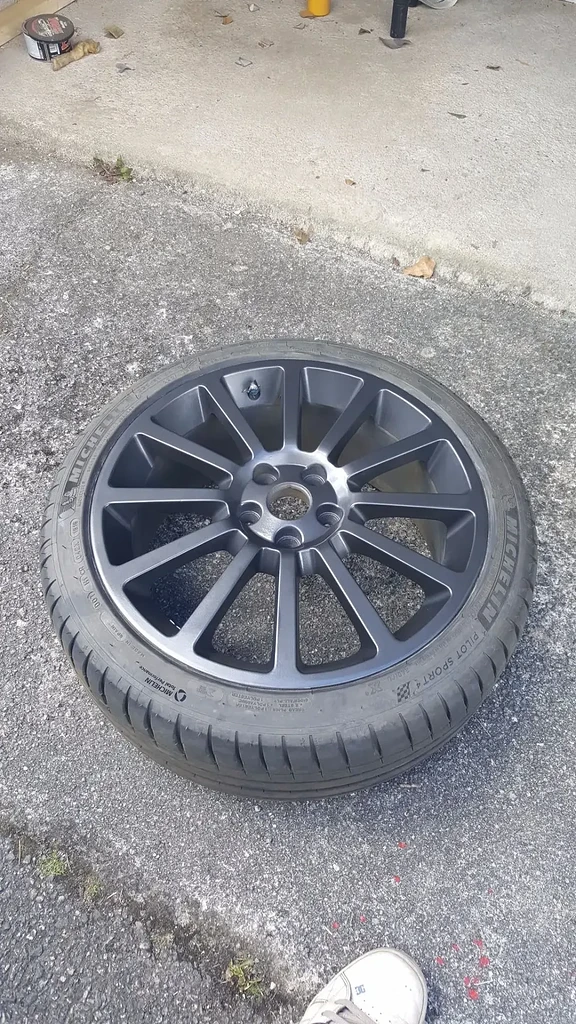

This was after 3 coats of paint and 3 lacquer:
I wanted a nice metallic colour that wasn’t far off the colour they were before. Took a gamble on Ford Graphite grey metallic and was pretty happy with the outcome

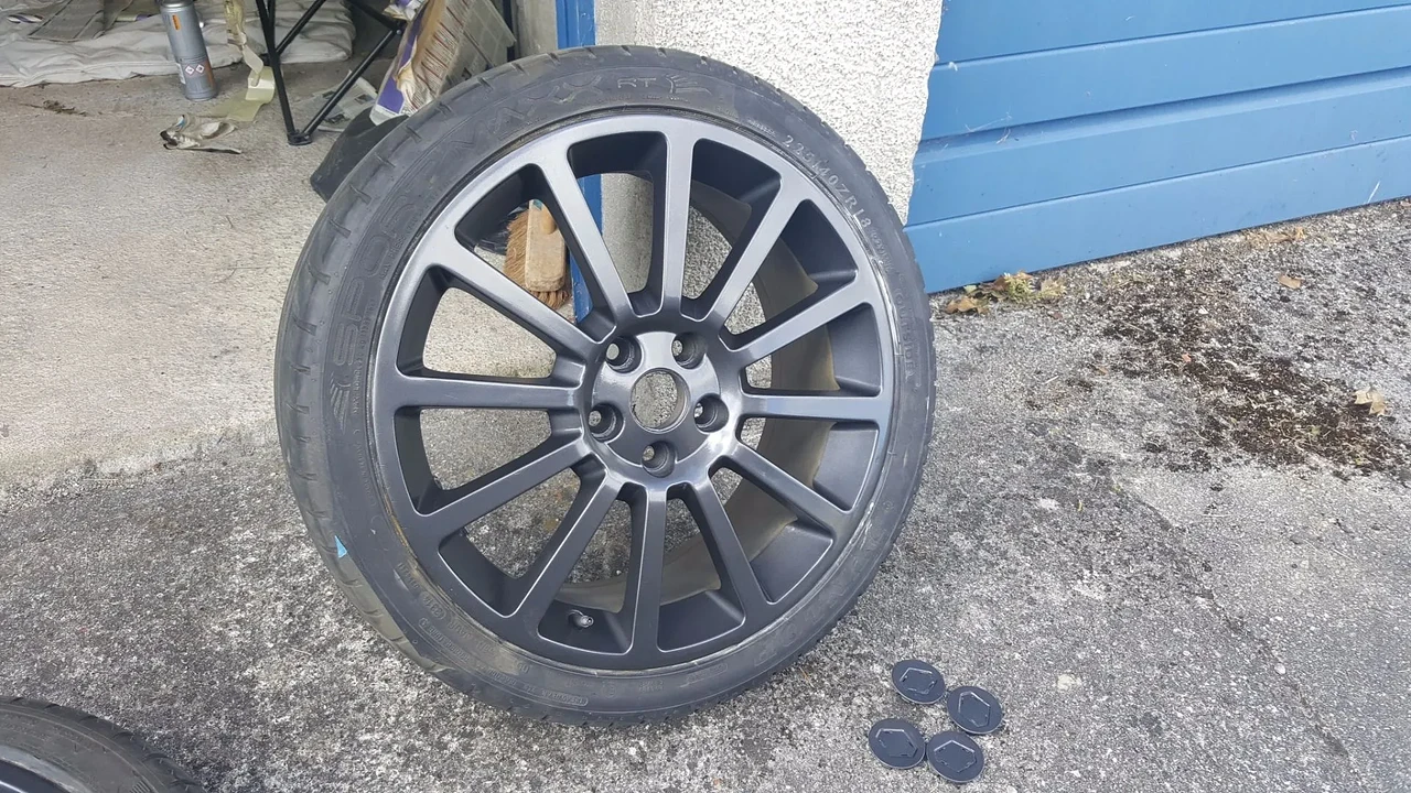

And after a couple of days to harden off:
Reassembled the centre caps and popped them back on the car, then left the car in the garage a few days to allow them to harden a little more:

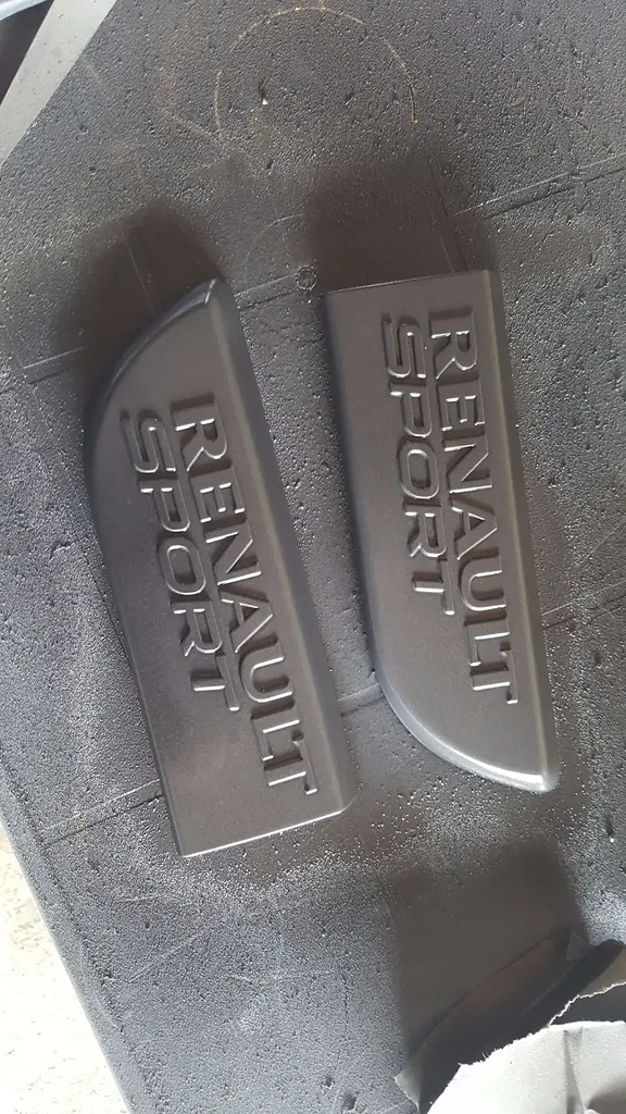

While it was sat in the garage i thought i would tackle my door bullets, been thinking of doing these for awhile.
Came up with the idea of doing them the same colour as the wheel with red writing:
Sanded the rust dots off and got them primed:
All painted in Ford graphite grey. I painted the writing by hand for now but will more than likely redo this part later on:

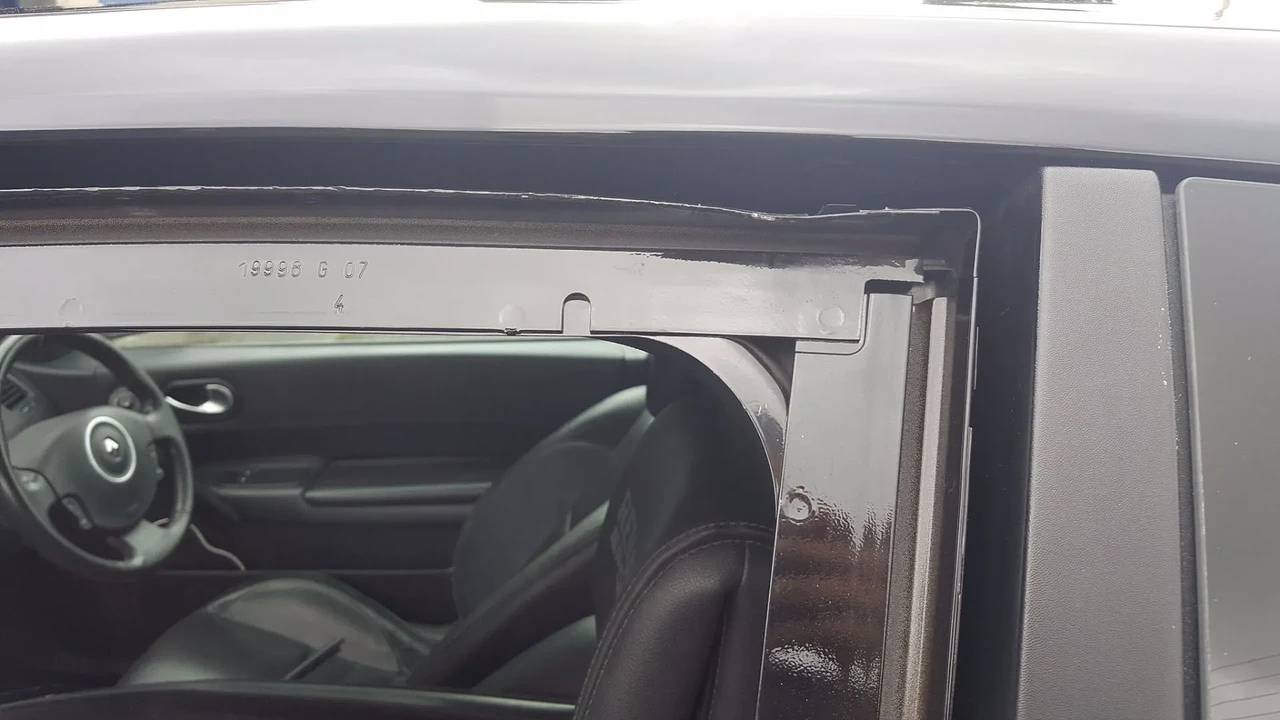

Also someone tried breaking into the car and damaged part of the door and the seal. Stripped the old seal off and was greated by this:
Set to work with a tiny hammer straightening it all out and putting the new seal on, its still slightly raised but works as it should:
