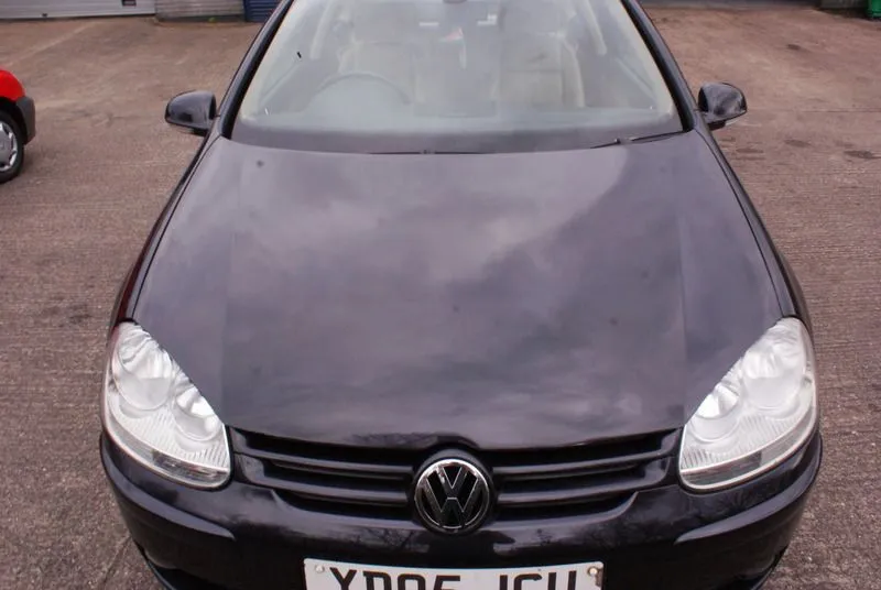

When it arrived.

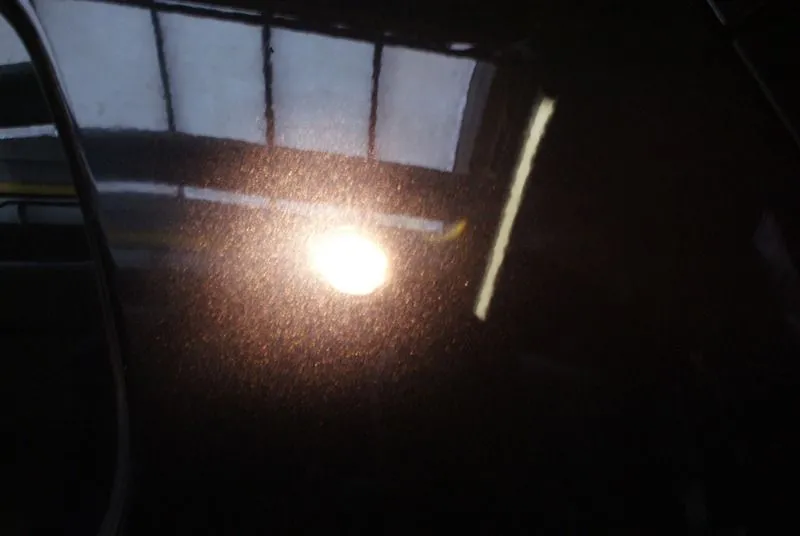

No clarity.

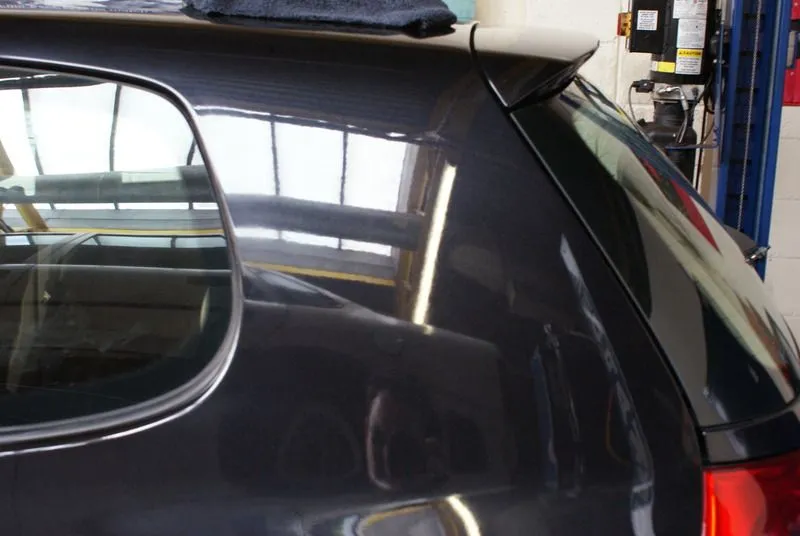

After a few polishing sets, the gloss was coming back.

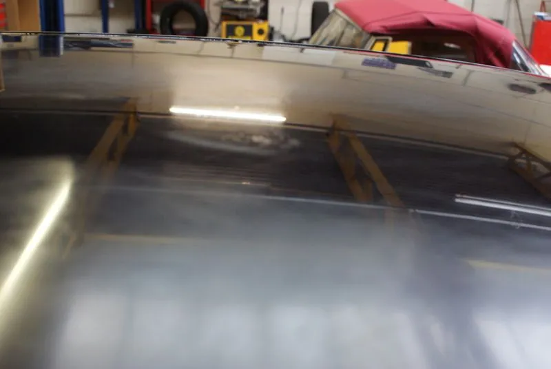

The haze is from the heavy polishing set used. This was refined further with another 3 polishing stages.
