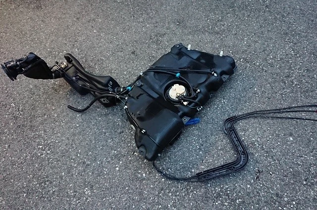

The fuel tank as well.

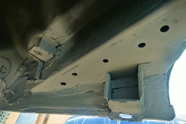

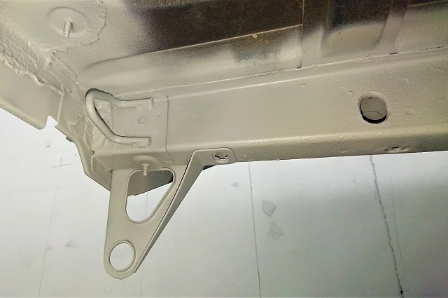

At the lift points on both threshold, there was most work.
Either the points were deformed by improper lifting of the car, or even injured so far, that the rust could eat the plate.
Nevertheless, the repair was no big deal at these places.
After repairing all rusty spots, the bare areas were treated with Brunox.
Thereafter, these places were primed.
All sheet edges / transitions were also cemented after priming.
Next, colored, overcoatable underbody protection was used to simplify the subsequent painting in the body color.
Now the entire underbody could be painted in body color.

The fuel tank was cleaned, and the hoses and clamps replaced.

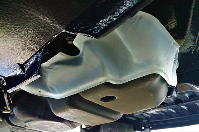

The fuel tank was reinstalled.

The rusted shields of the exhaust system were blasted, blue galvanized, and reassembled.
The front shield in the center tunnel was actually still available from Renault.
