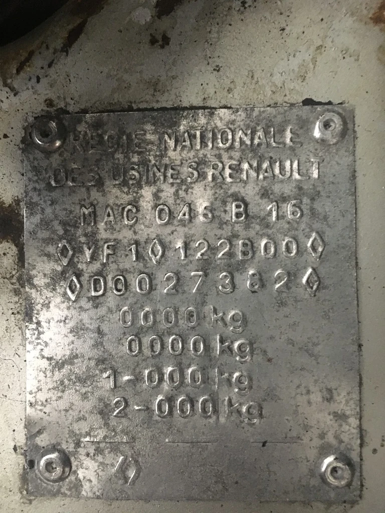

This is interesting. Looking at markings on my car, I think it looks like the SUISSE as I can see the 046 122B. Does this mean it was made for the Swiss market? Thanks
Does you car look like this?
Mmm. Hard to tell as it doesn’t have bodykit. I have a video from the original purchase & lots of photos of work in progress. Can I send video to you direct to look at?
See attached. I picked out the 046 and 122B (if that is correct?) but not sure what the C6J728 is
