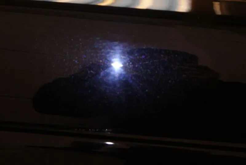

Driver’s door.
Rear quarter to door.

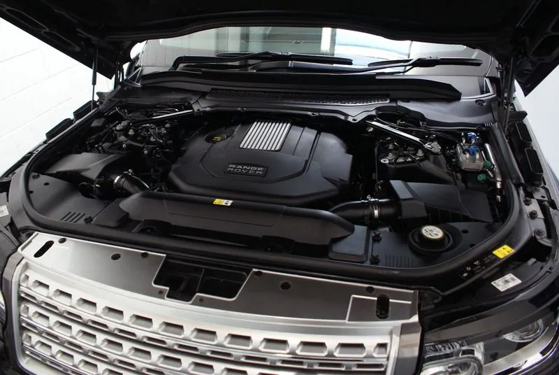

The engine bay was cleaned up and treated with Auto Finesse Dressle
Auto Finesse Revive was used on the plastics and rubber trims.
