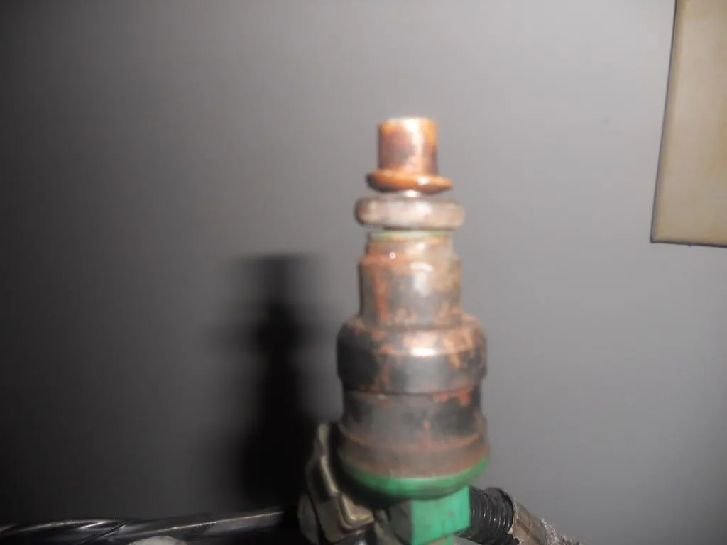

[BREAK=Fuel Injectors, with service report]
Injectors before
And after being serviced
Results of before and after

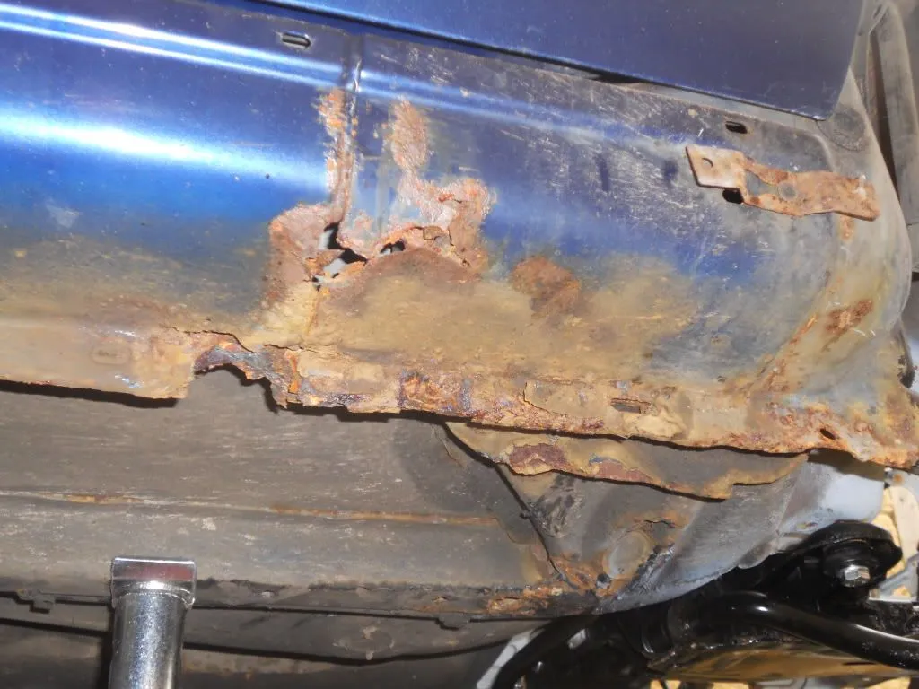

Took off the side skirts. Really wish that I hadn’t!
I was hoping, or wishing that these wouldn’t be this bad as I’m not looking forward to welding new sills. Bought a new set anyways, cost me about £50 for the pair.

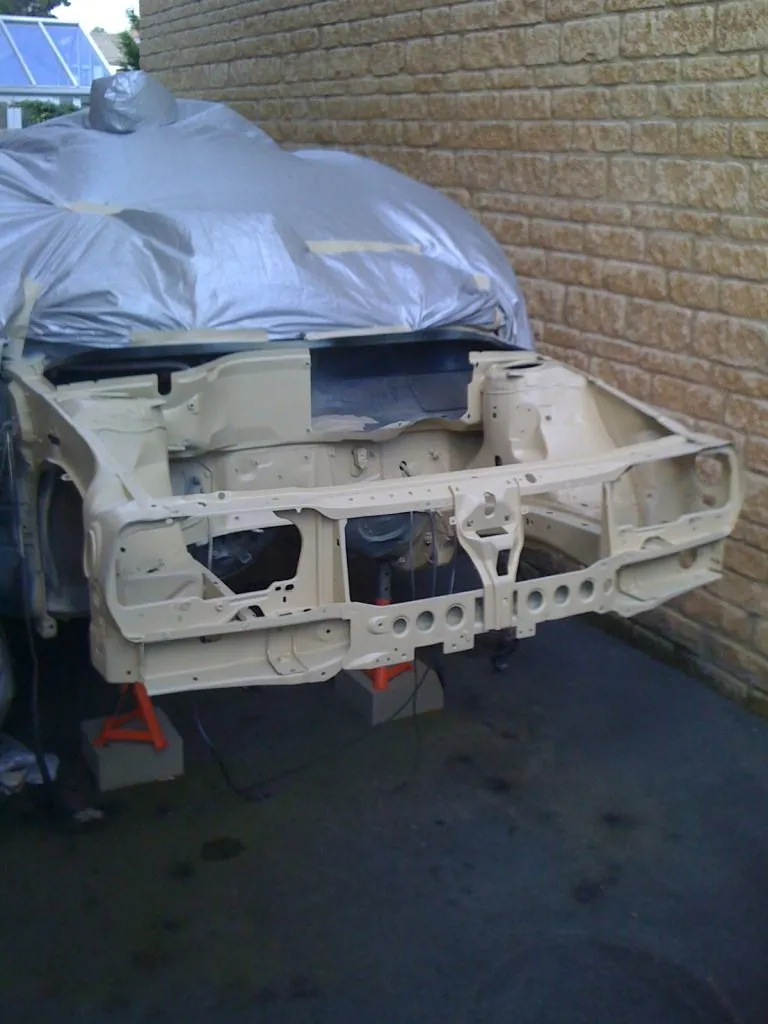

[BREAK=Painting engine bay]
Okay so I have one nice sunny day of 2012 to get this done. So I crack open my spraygun and have a bash.
The bay has been in zinc primer for as long as a can remember and theres no sign of rust coming through so thats good!
After a few coats of filler primer and a rub down.
First coat of base coat, and lots of flatting back. Did about 3 coats of colour in total.
The finished pic which doesn’t really do it justice. After 2 coats of 2k laquer. Sweet!!
Gonna wait about a week to give the laquer time to go ard, then refit all the gubbins. I can’t wait!

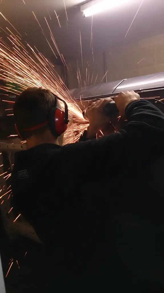

[BREAK=Cutting and welding inner and outer sills]
With the car now on its side I’ve begun cutting the outer sills off to get to the inner sills. As the outer sills are going to be replaced with new anyway.
Me in action
Outer sill has been chopped away, leaving the inner sill now exposed. I’ve cut out the lower part of the inner sill as this was totally rotten.
