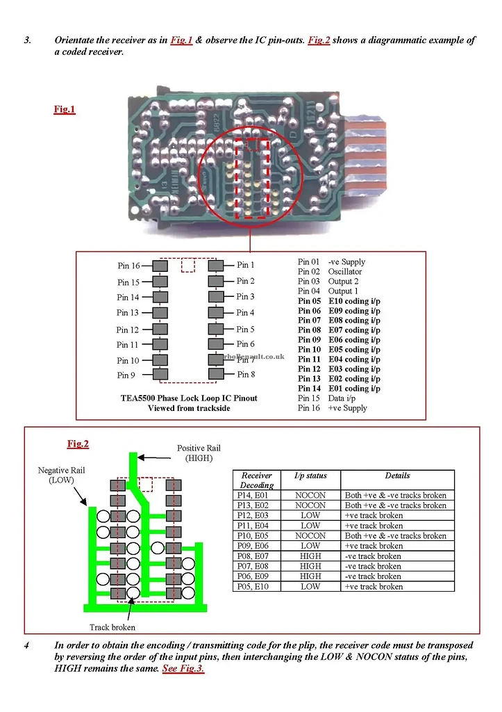

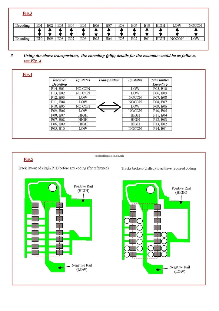

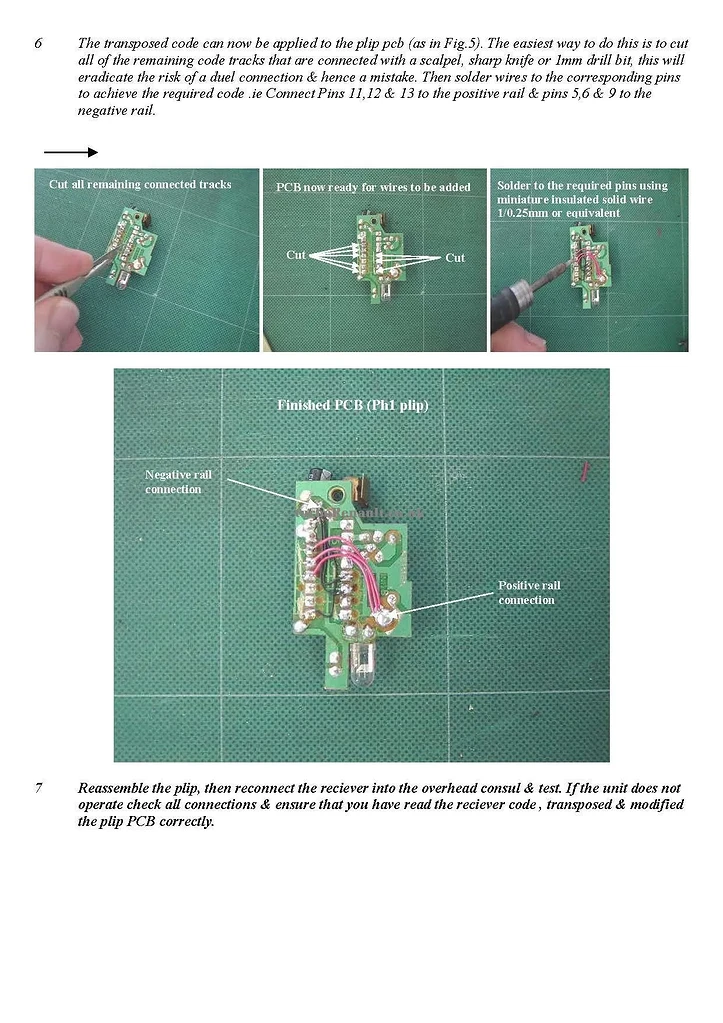

old plip programming , do you need the matching I.R in the car to the Plip ??
Or is there some way of programming these up ??
These cars were pre immobiliser so I thought you could do it ?
can any one shed some light ??
thanks matt
Yeah you can fudge them, I have a document on it somewhere.
Thanks knew you could
Anyone tried this?
Yes it’s been done a few times.
I have used these to repair and code repalcement fobs, very good service…
http://www.retrofrenchkeys.com/
Bit fiddly to solder, but apart from that works grand.
That’s @Chet T16. He can also re-program plip keys, not just standalone fobs and receivers.
