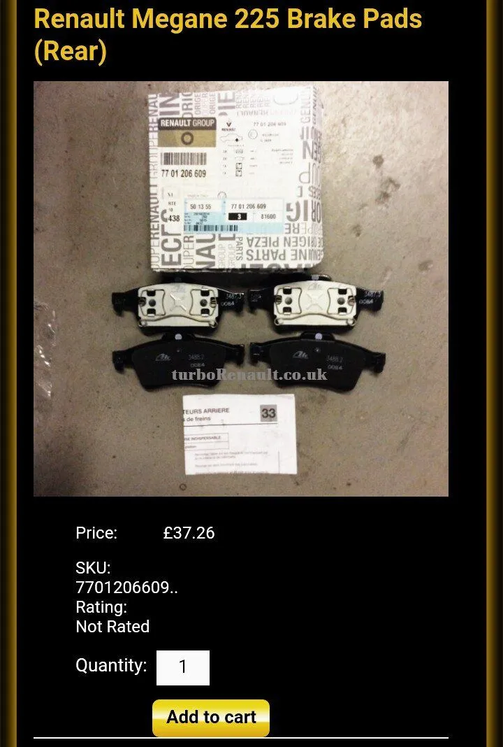

So it’s these ones then, much cheaper
If you’ve got 25mm bearings, then yep. Same as what I run on mine.
The brake pads look different though - Mine are more rectangular than that (440602466R)…
I’ve been told 25mm, which is handy as there’s £50-60 difference in the discs.
Just as well you checked mate (y)

Going on the chassis number supplied rear discs are 8200443579 for one with no choice of bearing size.
The pads are 440602466R as per a previous post by Mart
That’s excellent, really appreciate the help. So that’s the 25mm bearing. Great I can order discs and pads now.
