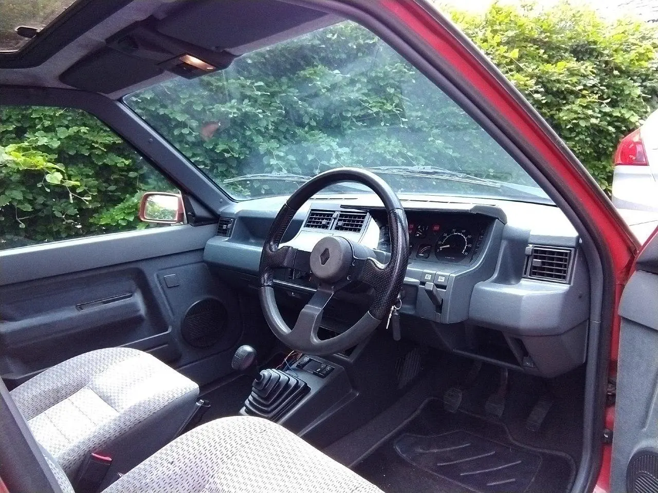

Carpet clips arrived, so centre console back in :slight_smile:
