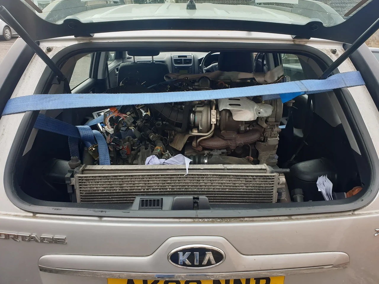

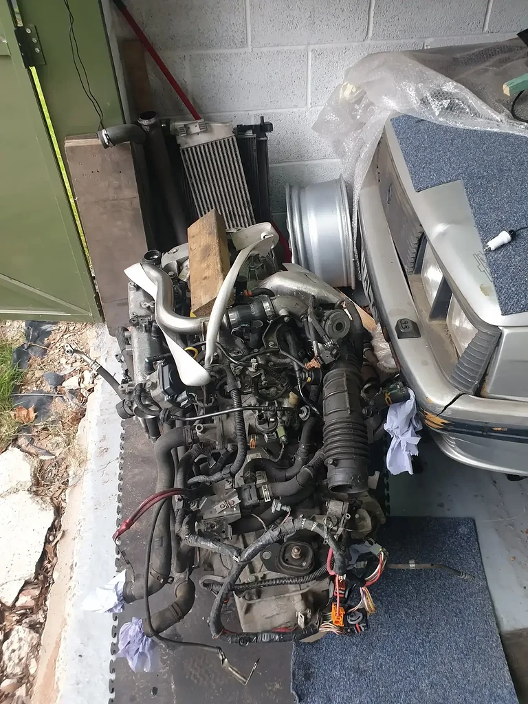

My 197/Meglio conversion
Here we go with the Meglio.
The 197 has so much potential, but ruined by the shite gearbox and ratio’s and the scarily common mapping issues with the flat spot and horrific cold start kangarooing. This should resolve all of those complaints and save me doing a belt service too!
No date set for the swap yet, but want it to be soon, in and out, job done.

ECU immobiliser cloned and back with me
Need a downpipe to complete the parts accumulation, then i’m going for it! :smiley:
plenty of decats pop up on fb, if i see one ill tag you. Is this ready to drop in now then?
What sort of power are you going for Dave?
Got one, wrapped with lambda’s, £90…coming this week. That should make it ready to go in. Fancy a garage day with me before CSS? :smiley:
