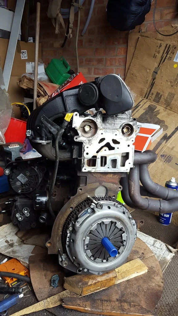

Not much to update other than I have bought a 172 sump, and flywheel.
Laid the engine over to swap the sumps (Only temp as it’s all going to come back apart for parts washer and painting)
Swapped the flywheels over, and removed the spigot bearing from the F4R-t crank, then began offering the gearbox up.
No longer will I listen to advise from people who havent actually done this conversion, on Facebook. Haha!
There is a lot more to it than just marking / drilling two holes.
The gearbox doesnt locate on the sump bellhousing bolt holes. It’s got about 2mm of movement up and down / left and right.
So I need to get my buddy to machine me a spacer which will locate into the middle of the 172 flywheel, and centralize the first-motion shaft in the gearbox, so I can then drill the new bellhousing bolt holes in the correct places.
Unless anyone has a better solution?
It wont be to stay in there, but just to locate the box while I mark the holes.
AND, it’s not ‘a couple of holes’ that need drilling. It’s 5 of the bloody things! :declare.gif:
I’m contemplating just re-building the entire engine into a 172 block, but I’m not too clued up on the compatibilty.
I assume the turbo return pipe will need making up one way or another. And obviously I’ll need to factor in the water pump being driven by the aux belt as apposed to the timing belt.
We shall see. I’m going to get this spacer made up and see how well the block drills.

I did a 197 block with 172 sump and flywheel on a 172 box. I’ll dig out pics but it was 2 holes maybe 3 tops that I drilled and tapped. great project, I keep looking at mk1 megs as I think they would be awesome with an f4r in.

I 100% have 4 holes to drill and tap. And 1 hole to drill through so I can nut and bolt.
Some pics would be awesome if you have them.
What method did you use to locate the box before drilling your holes?
I fitted the box as if I was normally, 172 box fit with 172 clutch and flywheel so it was central and the 172 sump gave me all the bottom fixings to hold it in place and keep it central. Marked through to the block the holes that then needed it, metal was there just no thread/hole. I think the pics might be somewhere on the site if not an old laptop
you might be right with the amount of holes. I think there was one I didnt use due to lack of material on the block, was a few years back now so memory is hazy.

My sump mounting face sits about 1mm shy of the face of the block so if I was to bolt the box up to the sump it would lift away from the engine block.:thinking:
I’m wondering whether there should be a shim / plate which sandwiches between the sump and the box.
