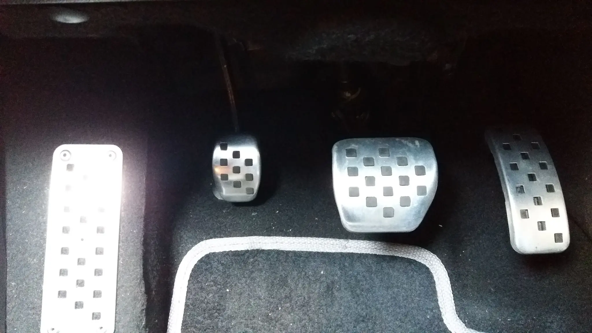

I would like to know if someone has had this clutch problem.
I have a Fluence GT that uses PK4-017 gearbox, very similar to the PK4-018 of Megane RS mk3.
This Saturday, the clutch pedal simply stayed low after I pressed it while driving the car out of the garage.
I had to pull the pedal back up and insist some times until it regained pressure and worked again.
Apparently is appears to be the pedal master cylinder, because I did’nt see any leaks…
Does the clutch hydraulic line run near anything hot? My 21 used to boil the fluid in the line, pumping the pedal would bring it back to life.
Good point, I will check it
