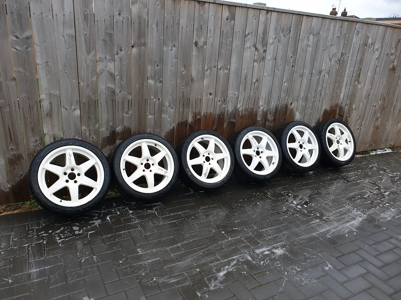

Picked up a new set of wheels last weekend. Ive been sniffing around for a while for nice wheels and anything nice in 5x108 is like rocking horse poo to find.

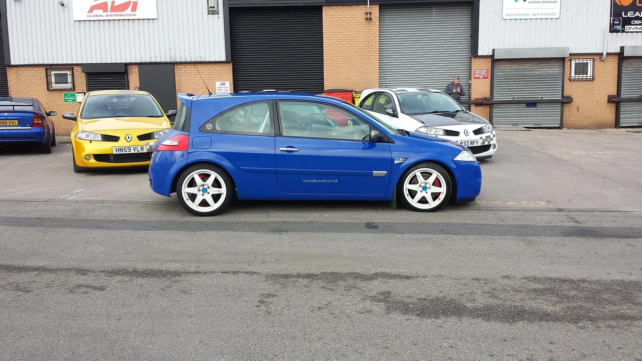

Story goes like this. Back in the day around 5 years ago i went to a TurboRenault rolling road day at RsTuning in Leeds and seen a nice ultra blue r26 with a set of white compomotive mo6 on. Thought it looked pretty epic and took a pic and that was the last i seen of it.
Fast forward to a couple of weeks ago - im browsing facebook and i see the same r26 again on the meganesport facebook page so i fire the current owner a cheeky pm asking if he wants to sell the wheels. Reply was not currently selling but will let me know if he ever decides to sell as they are road/wet track wheels.
A week or so later i get a pm asking if i want to buy them as the gearbox has blown up and hes breaking the car! Was tempted to buy the full car but we already have the ph1 225 sat there in the garage.
Got a few pics through via pm, set of 6 wheels, 4 have new goodyears on. Bit of heritage with the wheels, apparantly custom made years ago in r26r offset with correct hub centre bore and possibly used when testing the r26r around the Nurburgring? One wheel has 2x valves in for mega accurate tyre pressure checking.
Agreed a price and the deal was done. As per usual miles away from me and i dont have a vehicle large enough to pick 6x 18” wheels and tyres, so borrow my neighbours Combo van thats not been furthur than the local builders merchant for years / never been serviced to pick them up in, what could possibly go wrong? :LOL: Luckily nothing and it done the 600 mile round trip without any dramas at all and even got a shoutout off MistaJam on capital on the evening.

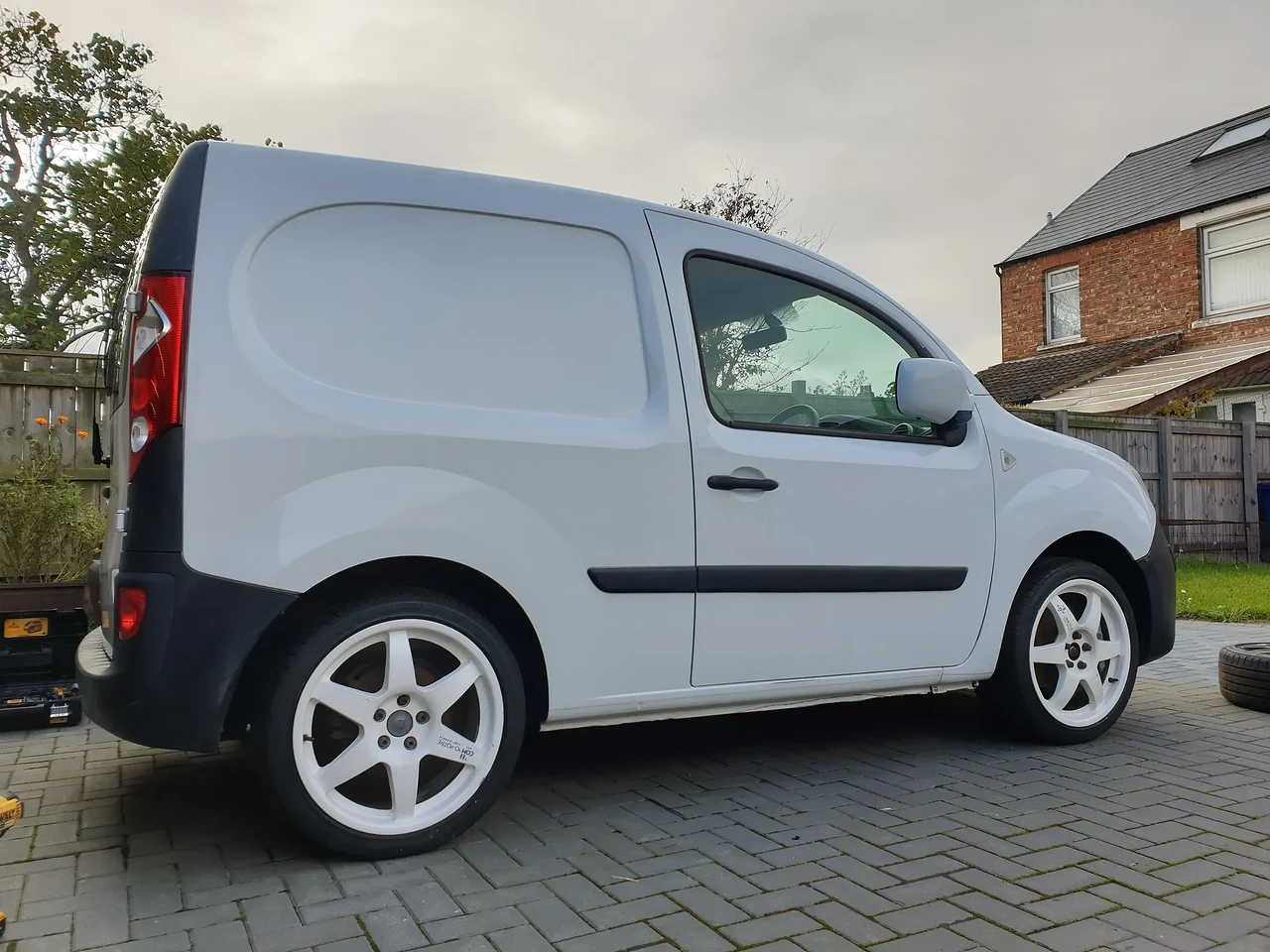

Give them a clean up, in pretty good nick considering been used for track. 4x matching rims et66 and 2x slightly different offset et54. Wheel with 2x valves 2nd from left.
Test fitted. Needs a major altitude adjustment (looks like a fecking micro machine at the moment :LOL: ) still no engine or box in so will see how it settles. If it needs more lowering ill buy a pair of meg coilovers for the front and sort the back with a custom setup if needs be.
Pretty happy though as heading in the right direction.
Tried them on the mrs 225 and they look epic.
So 3x sets of good wheels in 5x108 to share between the pair.
