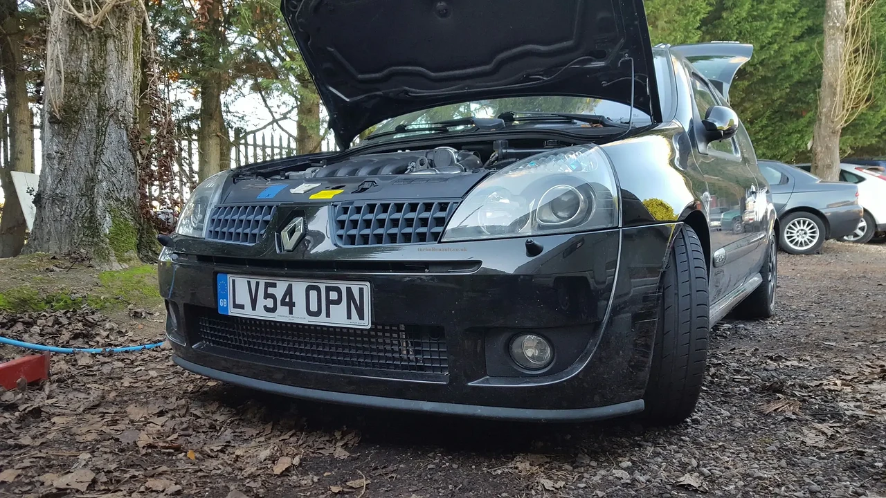

Not the best pic but other than down pipe its done

Did the decat pipe clear the mastercylinder ??
the decat pipe had to be modified for the clearance
@James5 bit of a bump but in the pics it looks like you have the stock fuel rail fitted? did you swap it out for a ph1 setup?
Hi @Adey no i ran the stock ph2 setup on the low boost turbo.No issue with fuelling at WOT was a little rich could have added a few more psi I suppose. Car has done 4 or even 5 track days and no issues’s
