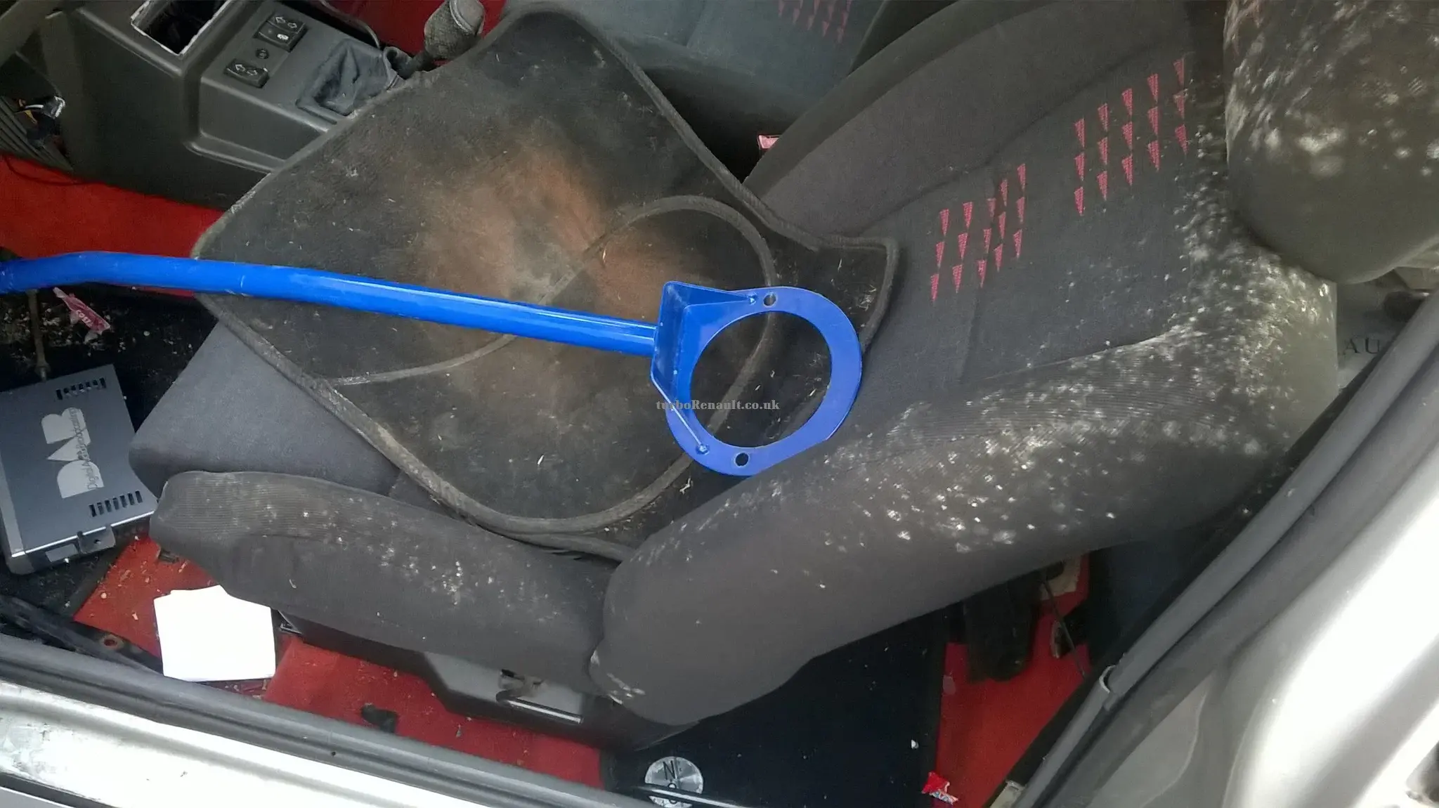

So hot topic is mould on seats and advice welcomed
In terms of the seats I was going to air, good hoover and poss white vinegar mixed with water to hopefully sort the mould and dry review status
Will need to change one of the bolsters which seem available
Any advice on 5 interior? Can you get the material / pattern as an option
Seats seem the worst but will know more when out of the car
Feed me info and options

Pick for ref
Wet vac should sort that. And maybe a spray of febreeze.
Keen to kill the mould also Dave but agree a cheeky hoover and clean may be enough…wishfully thinking lol
My clio seats and carpet were the same due to leaky sunroof. Good wet vac and dry them out properly should be enough to sort it:)r
I had mine do the same when under a cover for a while and I had to drive it as I was moving that day when I found it. Dettol wipes came out, good scrub and mould was gone. Expected it to come straight back within a month but it never did. Quick and easy.
Yeah mold will bugger off soon enough with a good wash/vac/wipe. Nothing too detailed I believe. It’s just a case of drying out the moisture. The Carpet may be your bigger headache..
Thanks all, will try a good hoover / clean and if it returns can get serious with it

Just read this one.
Hoover it off, then steam clean.
The steam will kill off the bacteria that’s grown behind and inside the fabric so you’ll get no bad smells coming back out.
You can always wet vac them too but I tend to use it as a last resort on older seats as the foam and bits degrades over time.
