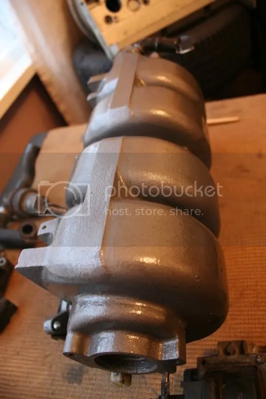

Inlet…
Cleaned it with gunk and de-greaser
Duct taped up the holes up
Gave it a quick sand with 400 wet & dry
Painted with 3 coats of custom mix Hammerite smooth
The colours a custom mix as hammerite don’t do a dark grey… 70/30 black/silver… Ish… i just mixed it till i was happy with…but i started with more silver so Ive got shit loads left, so painting as much as i can lol
Its not dryed as shinny or dark as in the picture… but im pleased with the results
