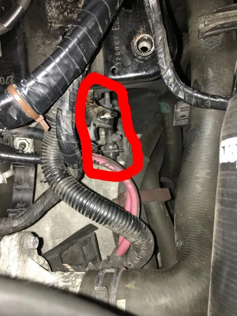

The clutch hose is pretty awkward to see, so you’ll want some light. It’s in the area surrounded by red and is quite low down. The give-away is the metal clip on the end and the bleed nipple. A picture speaks a thousand words…
Once you’ve located the hose surrounded in red you’ll need to make sure you can get your hand down to it to press the metal clip in and pull it out, which was pretty awkward to do, and you might need to move some cables/brackets around to get there.
