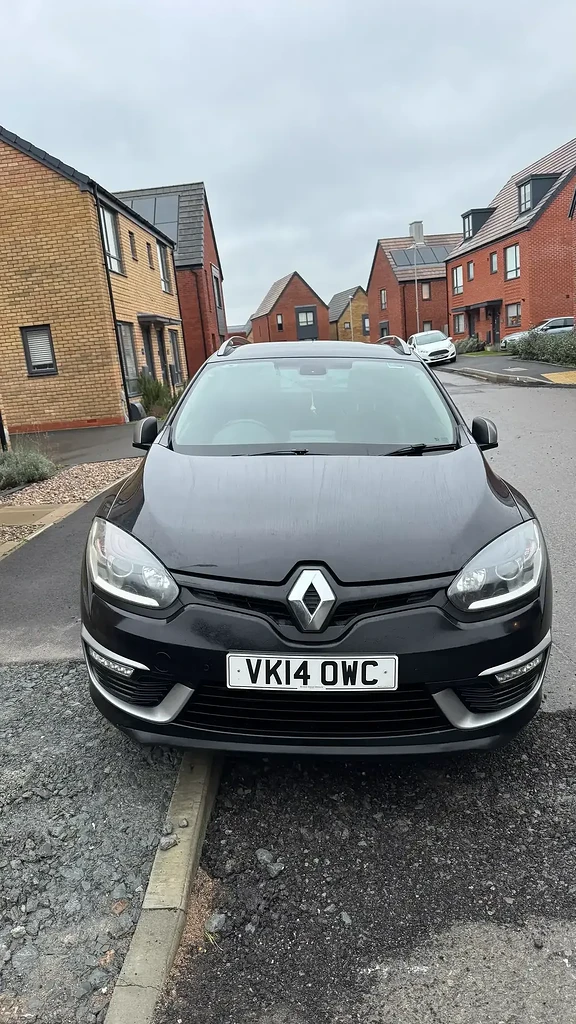

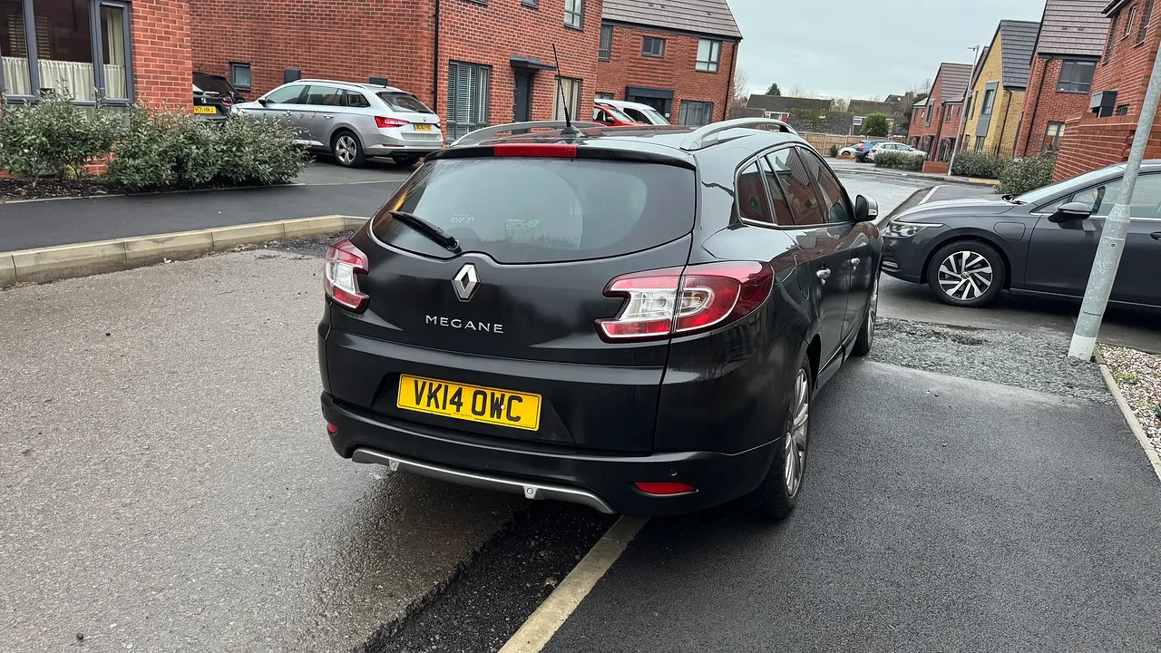

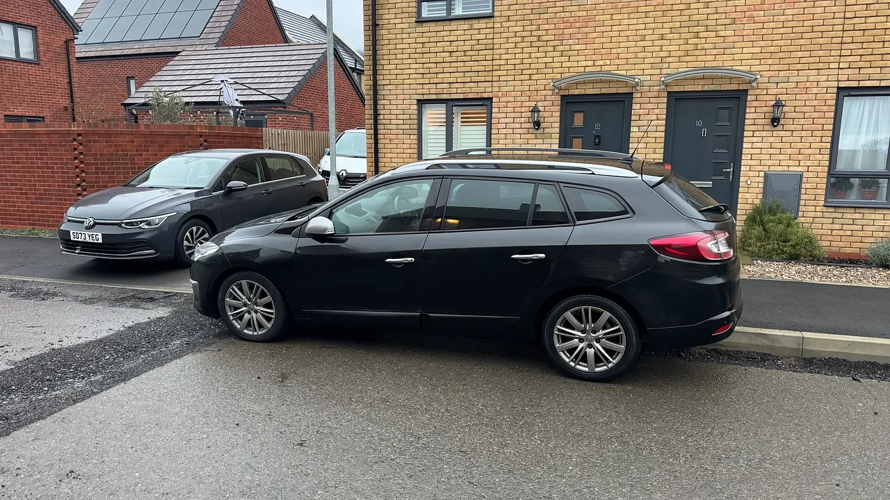

After selling my beloved Kang-Poo van, I clearly learned nothing and, while on a weekend break in Newcastle with my partner, I did what I always do and started browsing Facebook Marketplace. That’s how this 2014 Mégane Sport Tourer GT Line followed me home.. Ironically, it’s a VK plate registered in Gloucester, serviced in Gloucester, and now I’ve brought it back home. It’s clearly seen more of the country than I have.

kinda like the look of that you know

Inspired by butlers old smoker, the blue pre facelift he had. I wanted similar spec with a sunroof but lets be honest, its just something else to go wrong on these things…
