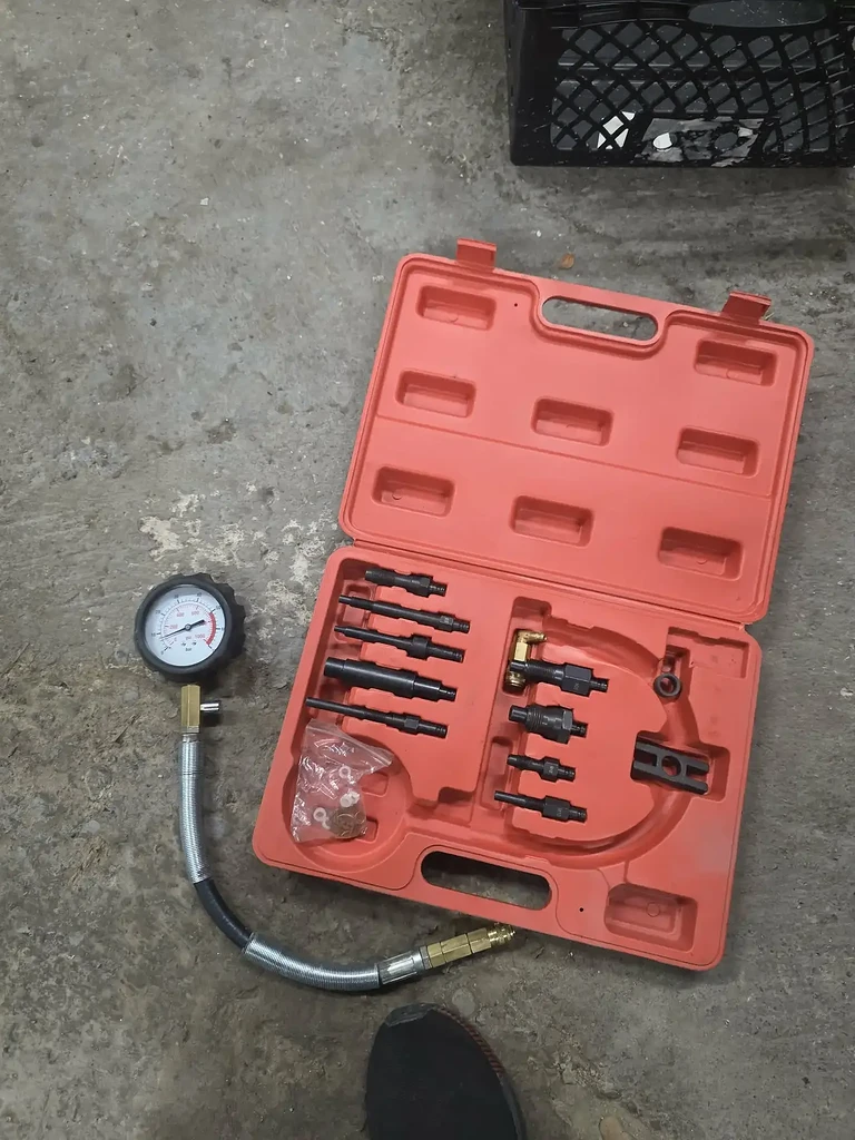

Threw it in my unit Tuesday night and got to work. Benchmarked it against an Diesel Insigina Estate up a slip road enroute and got comprehensively humbled. Not a happy boy.
First job was track down the “dead good” compression tester my mate had left on the shelf.
“Dead good” if i was testing diesel injectors. That was a non-starter so [I]I’ll just rip into it then.

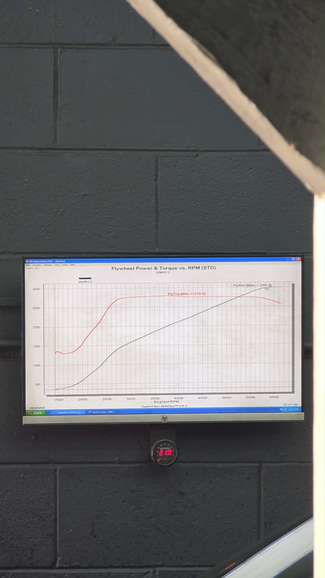

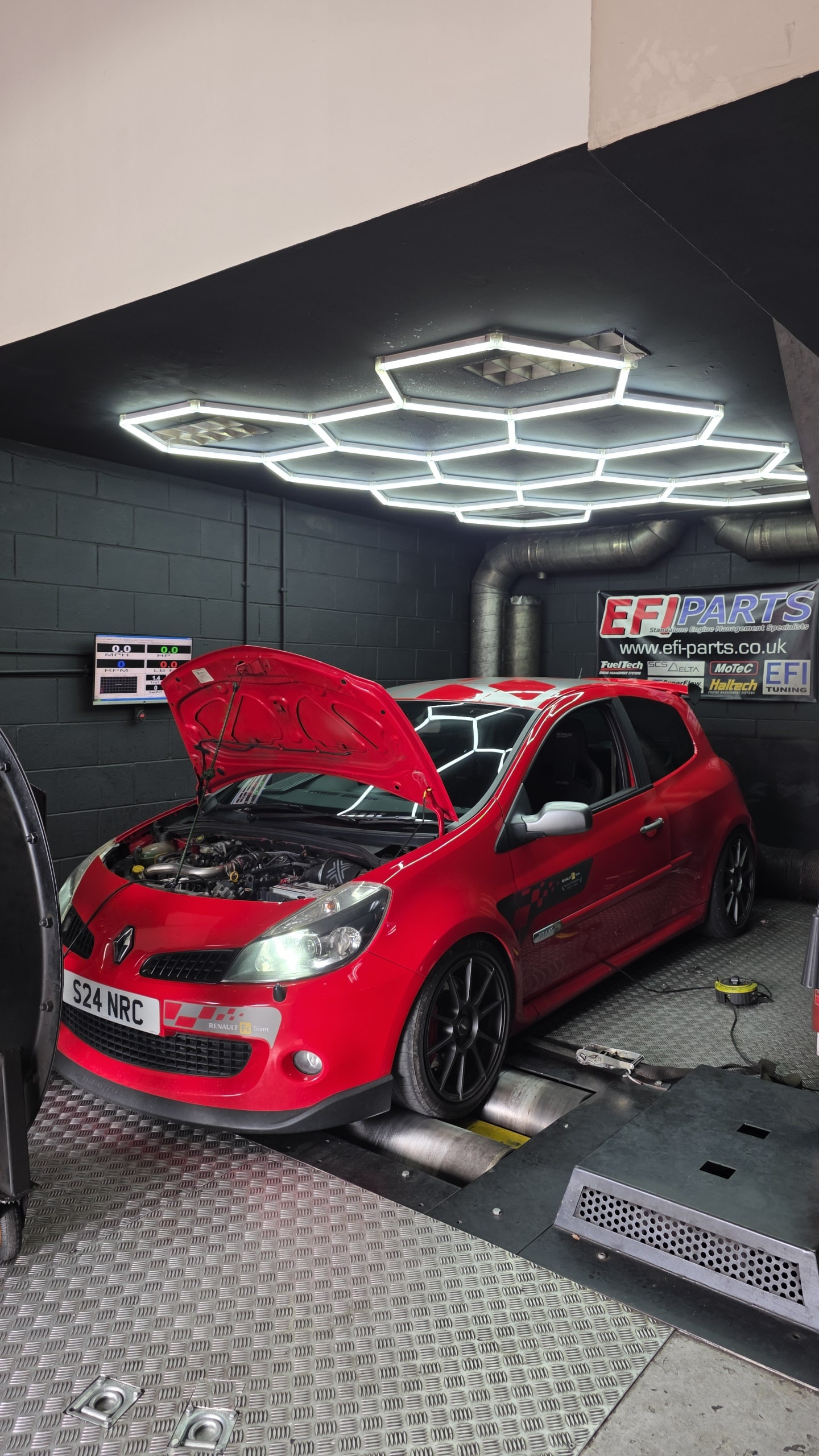

Made some changes last week, cars ripping now.
Had a week off work so went ahead and threw a new oil and filter into the rig and finally made use of the cornering lights post Meg conversion.
For some reason, and I’m guessing its something to do with the Megane ECU and loom, the Clio cornering light system simply do not work for love or money. I’ve spent a good few hours on a few occasions metering out the loom and checking things but I can’t seem to get it to work. Decided to fit some nice PIAA bulbs in the high beams and the cornering lights and dump them all into the same circuit so I essentially have a 6 bulb high beam. It’s absolutely mega at night, and just in time for winter commutes.
On Thursday, Chris at EFI posted some last minute availability for the weekend. I jumped on this as it would be nice to know where we currently sit with everything.
Roll on Sunday afternoon and we had a chat about the economy being a bit weird, the car not feeling particularly fast top end and some general weirdness with part throttle. First run and Chris aborted it at 4k as he could already see the fuelling was out-of-range rich and the power was already tailing off at 238bhp.
Oh.
So we went back in and had a look over the bay. A lot has been changed since Feb, but nothing huge, and nothing that Chris thought would be causing the fuelling to be so wrong. We decided to start from scratch and finished at 300ish and 280 torks, not bad considering it pulled 310/290 at -2 ambient in Feb.
Because I’m also a massive child and had been at the Woodpecker stages on Saturday listening to Rally 2 cars farting about, I had also asked for some mild bangs on gear change. Chris said he was limited with what parameters he could change for that kind of thing but said he would add the mildest option possible. Never really heard them during the post dyno road test, but on the way home discovered it basically has full bore anti lag now if I let off above 4k. I imagine the novelty will wear off in the next fortnight as its been approximately 4 days and the constabulary have already had words…
Absolute missile now though. Buzzing with it.

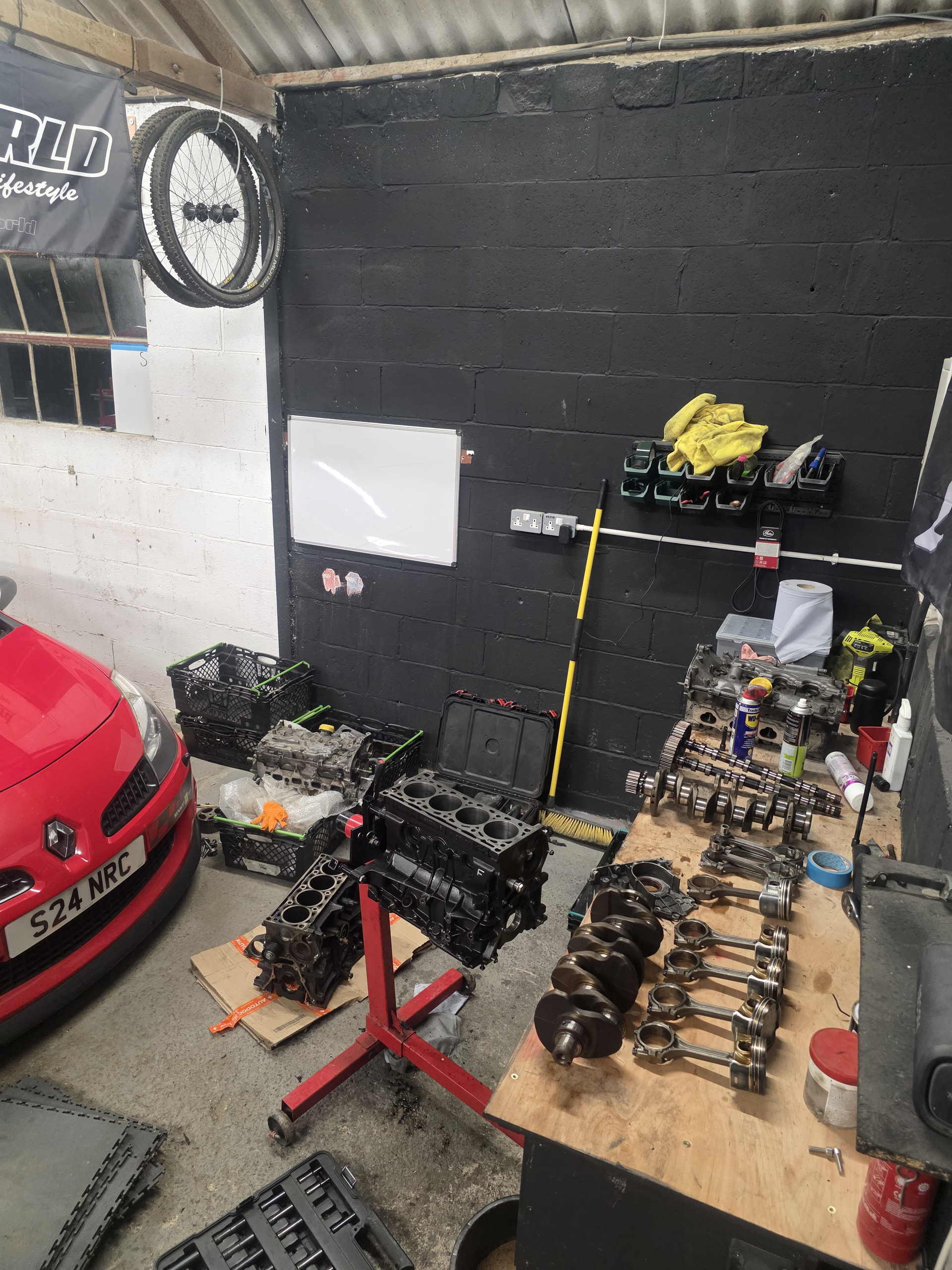

Rolled the Clio back into the unit after giving the place a proper clean and clearing some space at one of the workbenches. All our cars have been working, so we’ve got out of the habit of tidying up and lost a few hours to that in the morning.
Gave the Clio a wash and got chatting to the landlord. He’s done everything: chassis development with Bentley, VW Cup cars, Porsche Cup—the list goes on. He mentioned having trouble with a VW Cup car where the helical gearing in the gearbox was loading the crank, which I’d never considered and might be worth checking. I noticed some horrible gearbox noise when the car was on the dyno, and the ND0 interfaces directly with the crank through the pilot bearing. The box is probably approaching 200,000 miles now, so there’s a good chance some wear items are past their best. It’s also the only component that’s remained unchanged across all these engines. It might be a long shot, but it’s worth investigating.
I started cataloguing my spares, too.
A head I thought was good turned out to have some nasty gouges in the inlet cam journals, so that’s no use. Pulled another head that looks good, has undamaged journals, but needs a few helicoils where the threads disintegrated while removing the rocker cover. They don’t take much torque, so provided I’m accurate, it should be fine.
I also had a block acquired quite cheaply from Facebook, containing a crank that had covered around 500 miles after a rebuild before a piston melted. The crank was mint, as were the bearings but unfortunately, there are some nasty scratches in the bores. It would suit a forged build with oversized pistons, but I don’t think I’ll get away with using it in a stock Mk3 bottom end. That one can be shelved for a rainy day.
Checked another spare block that has been on the shelf since 2023 because it was too heavy to scrap and that ones a lot better, will likely go again with a hone and some gentle WD40 and Scotchbriting on the journals. I still have the engine in the car and another assembled bottom end sat there, so will crack on disassembling those two and go from there I think.
Cams and pistons are pretty simple - I’ve got 225 cams that will go again, and I’ve got a set of 874 rods and pistons out of a 250 that will be fine to go in with new rings and bearings.
After this, my mate decided to absolutley fkin nail his 172 bottom end. Worst knock I’ve ever heard coming out of one. Discovery 3 once again saving the day…
I hate F4Rs.
Spent Monday/Tuesday night investigating previously destroyed engines and blocks.
Stripped the bottom end of engine number 3 and found number 2 big end and number 3 main had spun. So most of the bottom end is scrap, but the head is still usable.
Then whilst speaking to my mate and fiddling with the oil pump chain drive, I noticed the sprocket was free spinning on the crank. Penny dropped. Went to check over engine number 2’s crank and sprocket that I’d kept together and confirmed that the crank and sprocket had witness marks suggesting the pump sprocket was spinning in place on the crank. I’ve seen various reports of this happening on diesel M9Rs which use a similar architecture.
I will probably admit I’ve been a bit lax in torquing the crank bolt to to spec in the past, probably erring more on the side of ‘FT’ than the exact angle tightening on the presumption that a keyed crank pulley would prevent most issues… Will have the engine in the car out this weekend and that will be the first thing I check.
