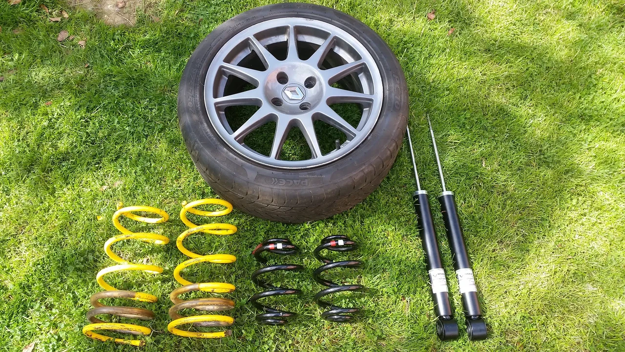

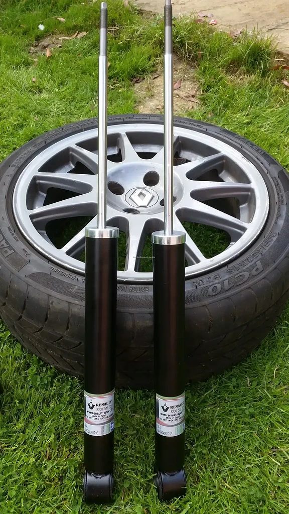

August 2015 I sourced some new genuine Sachs rear shocks to go on when the originals have had it, added to the cheeky original Turini spare wheel (with shady tyre) I bought months earlier and spare set of low mileage oe Trophy springs to complete the suspension spares dept.

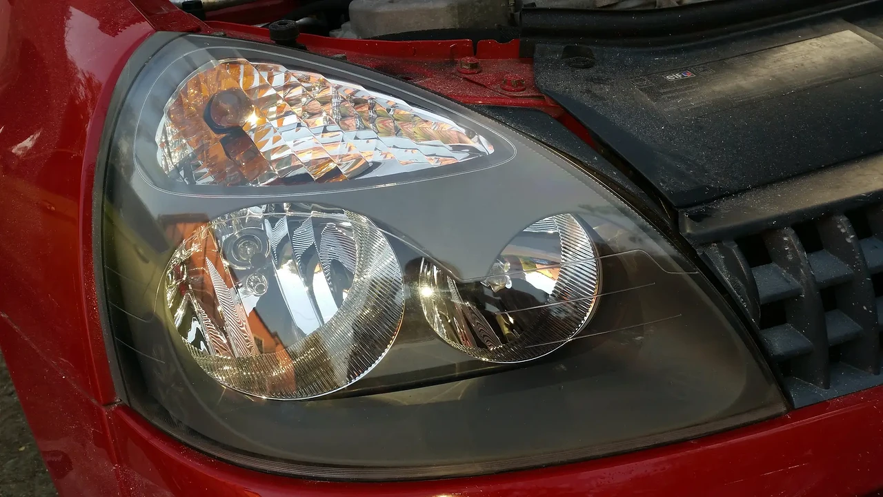

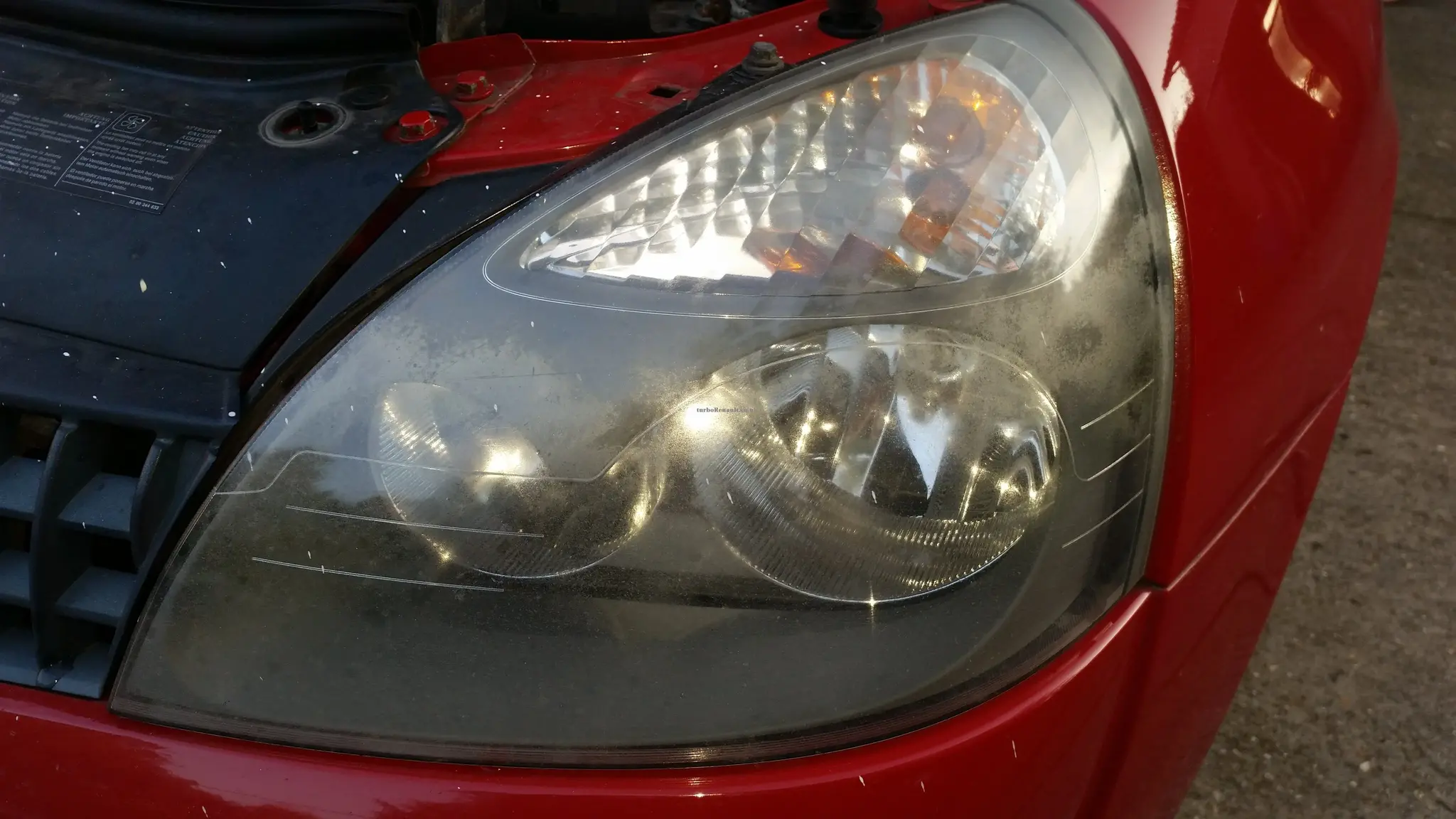

October 2015, headlight lenses have been a bit foggy since I bought the Trophy so invested in a 3M headlight kit, then sealed with some Gtechniq C4. Before and after pics…
Great stuff, amazing the difference on the headlights (y)
My next job on the Mrs 1.2 dynamique! Ballache!
Around 30-45 mins per headlight they will be fine, lots of that blue masking tape stuff around the headlight you are doing particularly at the bottom and sides. They do go pretty really ‘misty’ after the first stage and you will think WTF have I done! however all good in the end, the 3M kit is very good with with C4 to seal them afterwards you cant go wrong fella. :wink:
