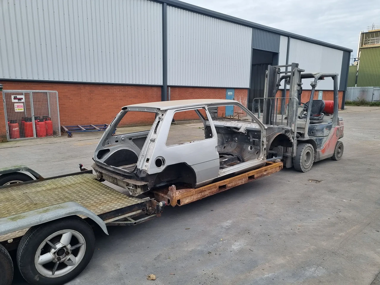

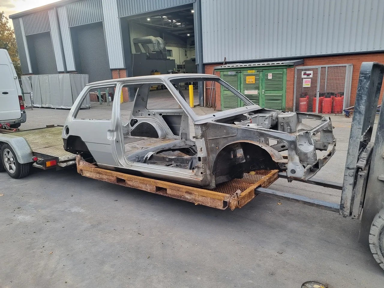

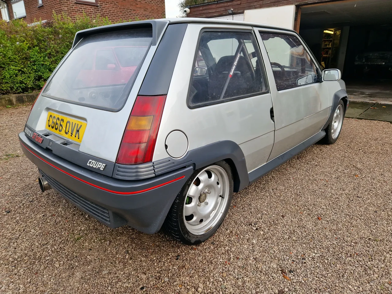

This became available as a rolling shell, comprising of :
Rollcage already fitted.
Fibreglass doors, the white race number squares were removed.
Polycarbonate/lexan windows
Fibreglass tailgate/spolier.
Fibreglass bonnet.
Corsa b electronic steering column, returned back to oem.
172 front struts/hubs, replaced with Gtt/ gaz coilovers.
The bulkhead had been modified slightly for a previous engine, reversed and covered with some red oxide.
A known good engine fitted, along with a carb rebuild, a fresh coolant tank, silicone hoses, radiator and some shiney bits

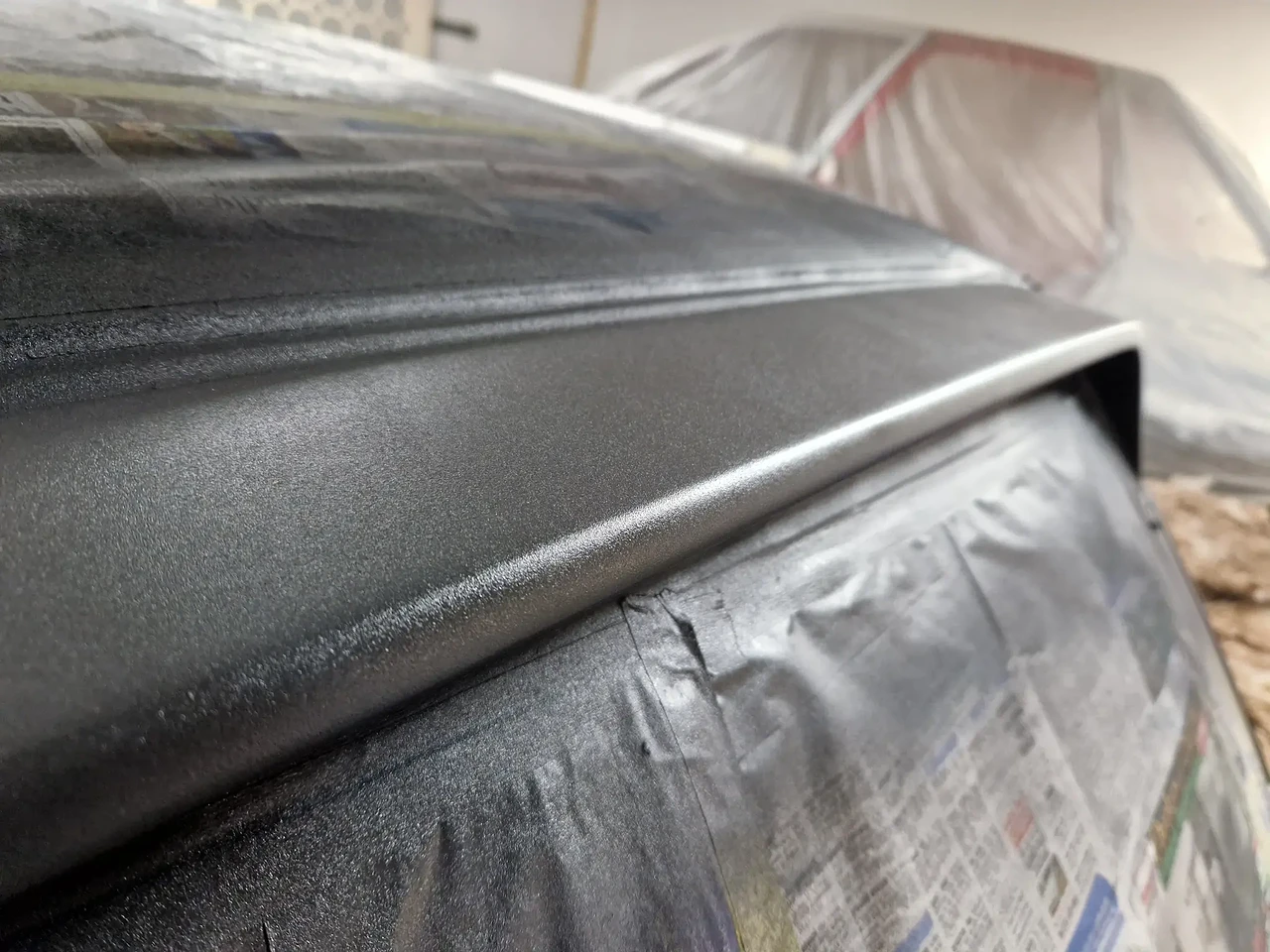

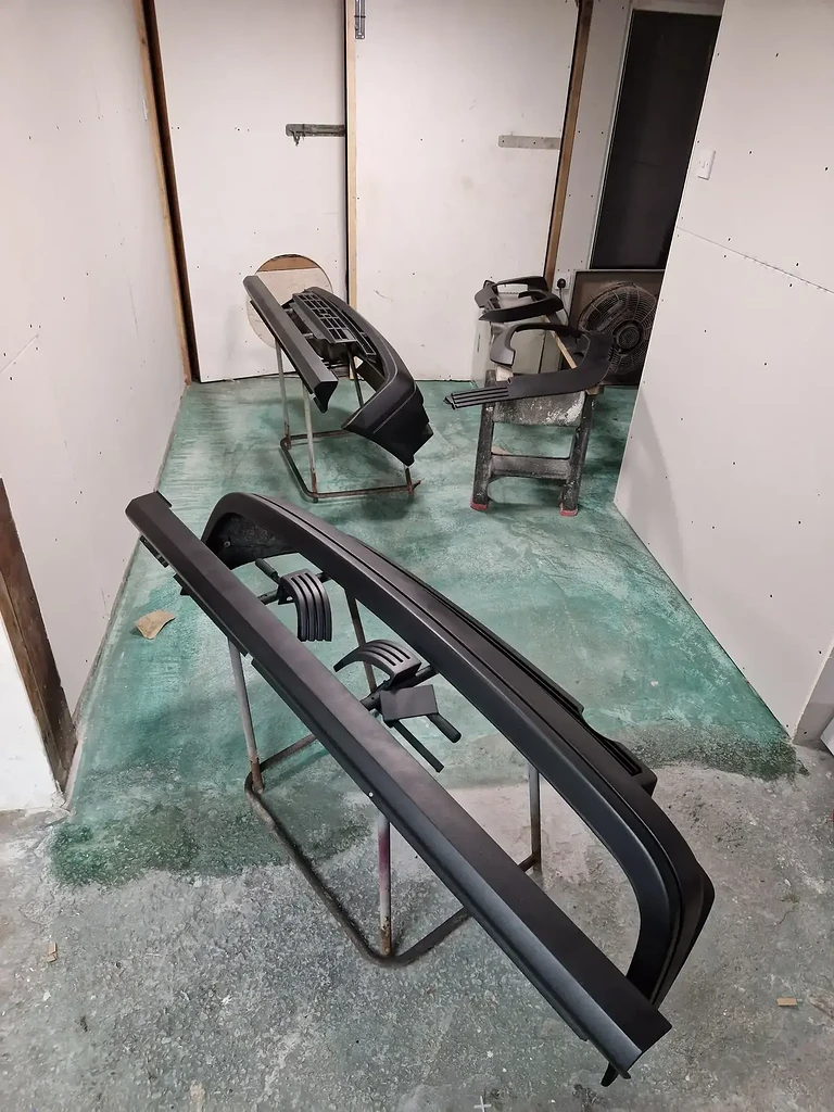

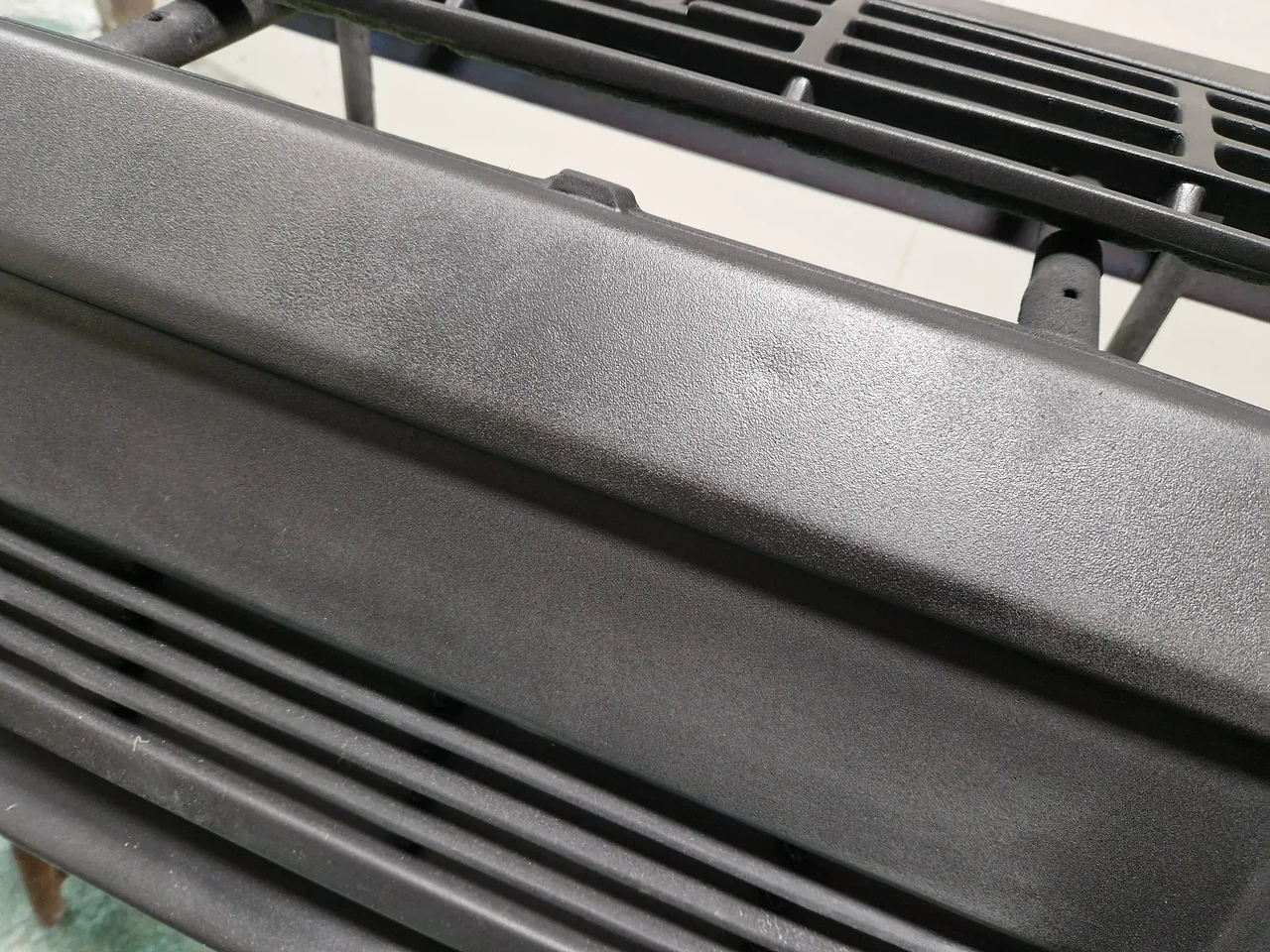

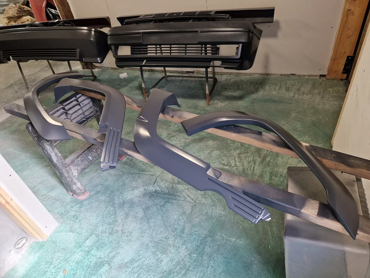

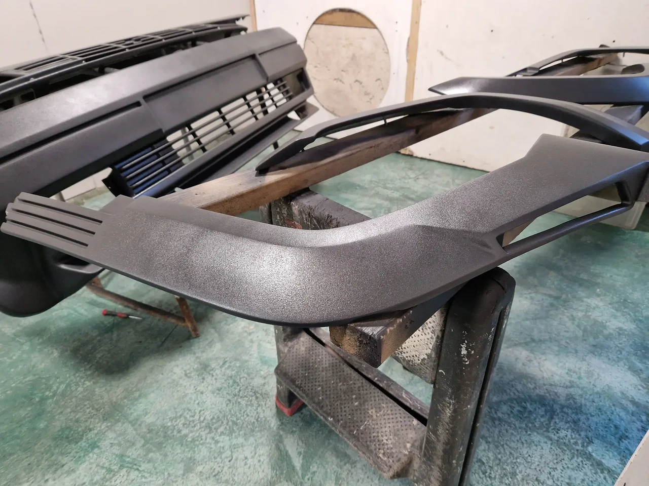

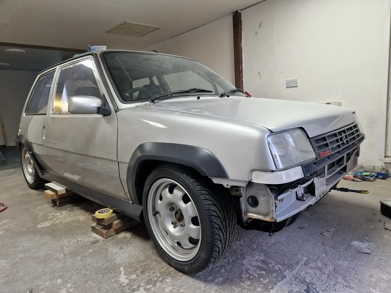

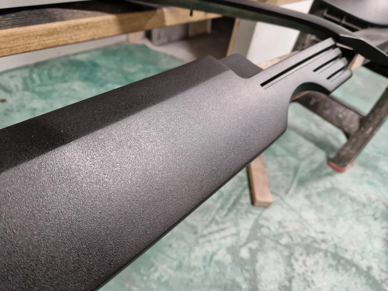

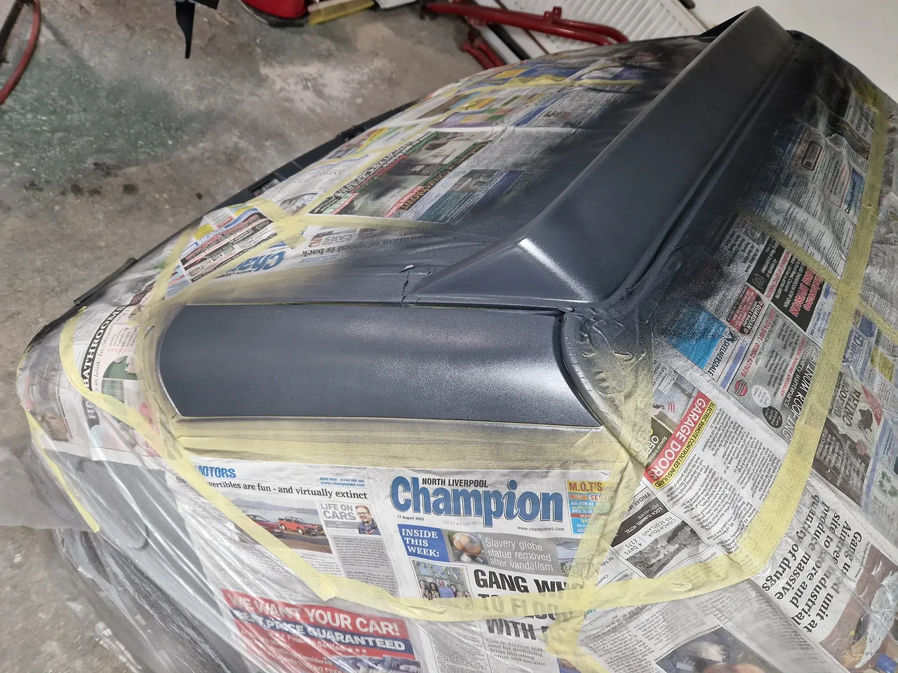

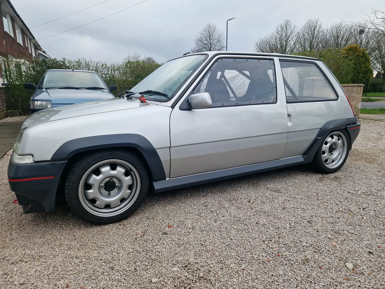

The kit was missing. A fibreglass replica ph1 kit supplied by youngtimers was attached, all but the underlight trims. They are oem but had been painted before. Being far from oe, no filler applied to improve the imperfections in the kit. Applying the stippled effect

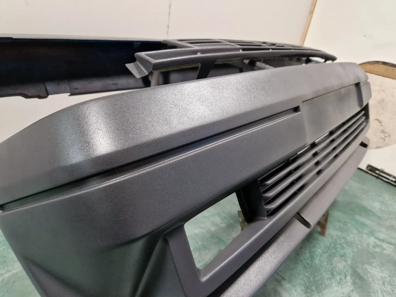

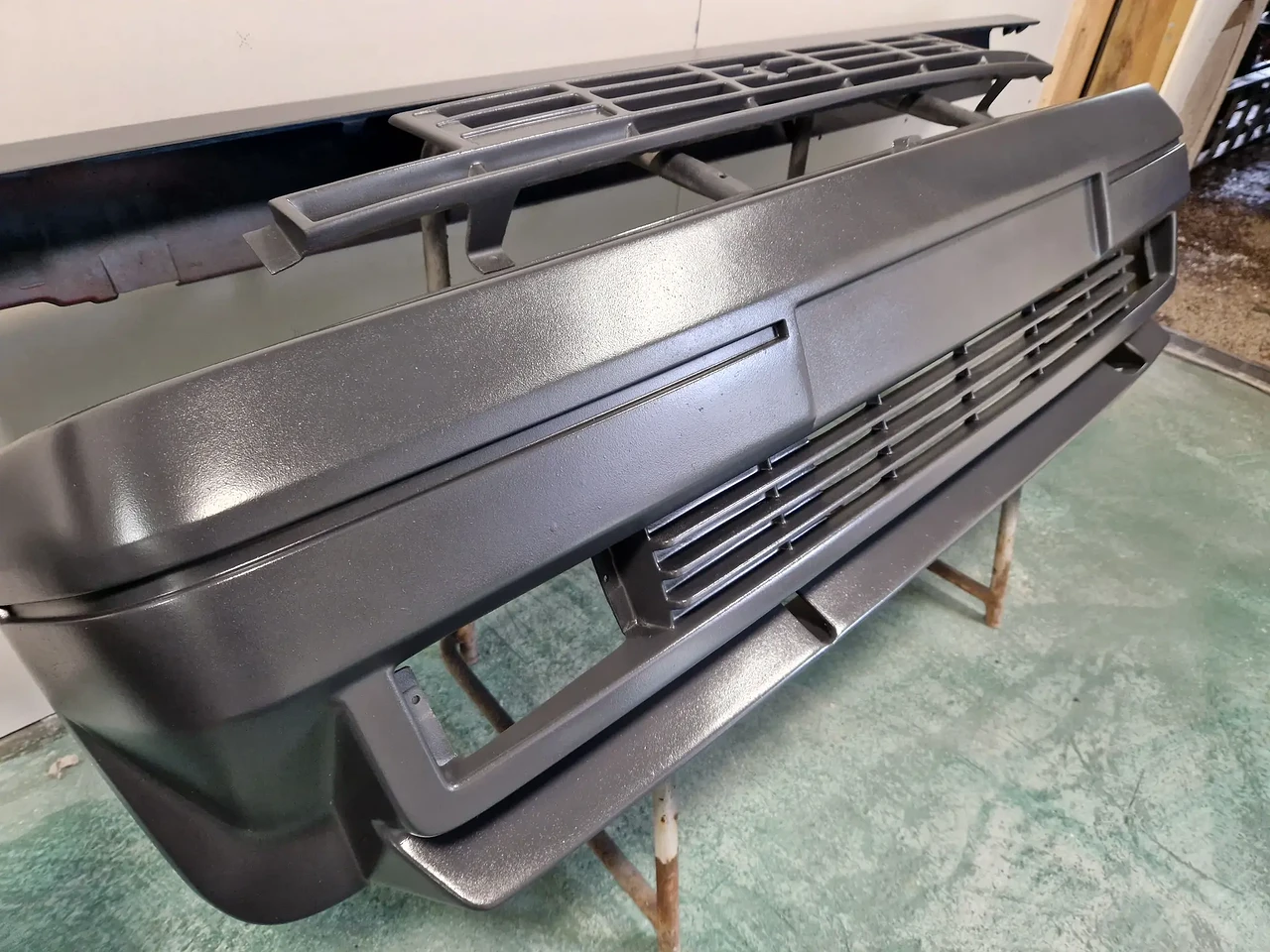

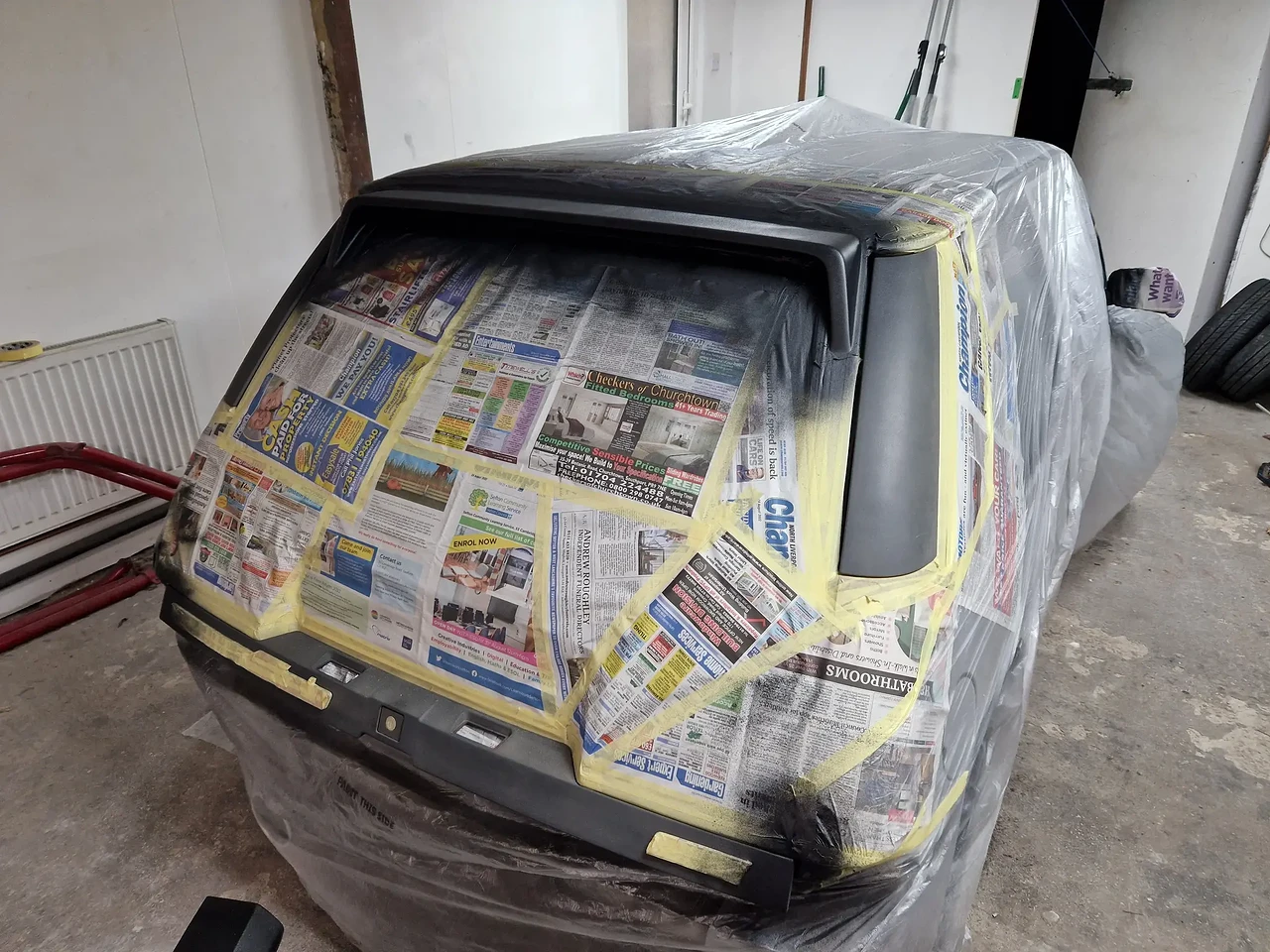

The request for the the kit is oem grey, but with bumper gel applied. Achieived with a 2pk grey and less matting agent than oem, making it satin, or in this case a little less
It does look different from different angles, and as the light coats build up to keep the stipples, plenty of pics

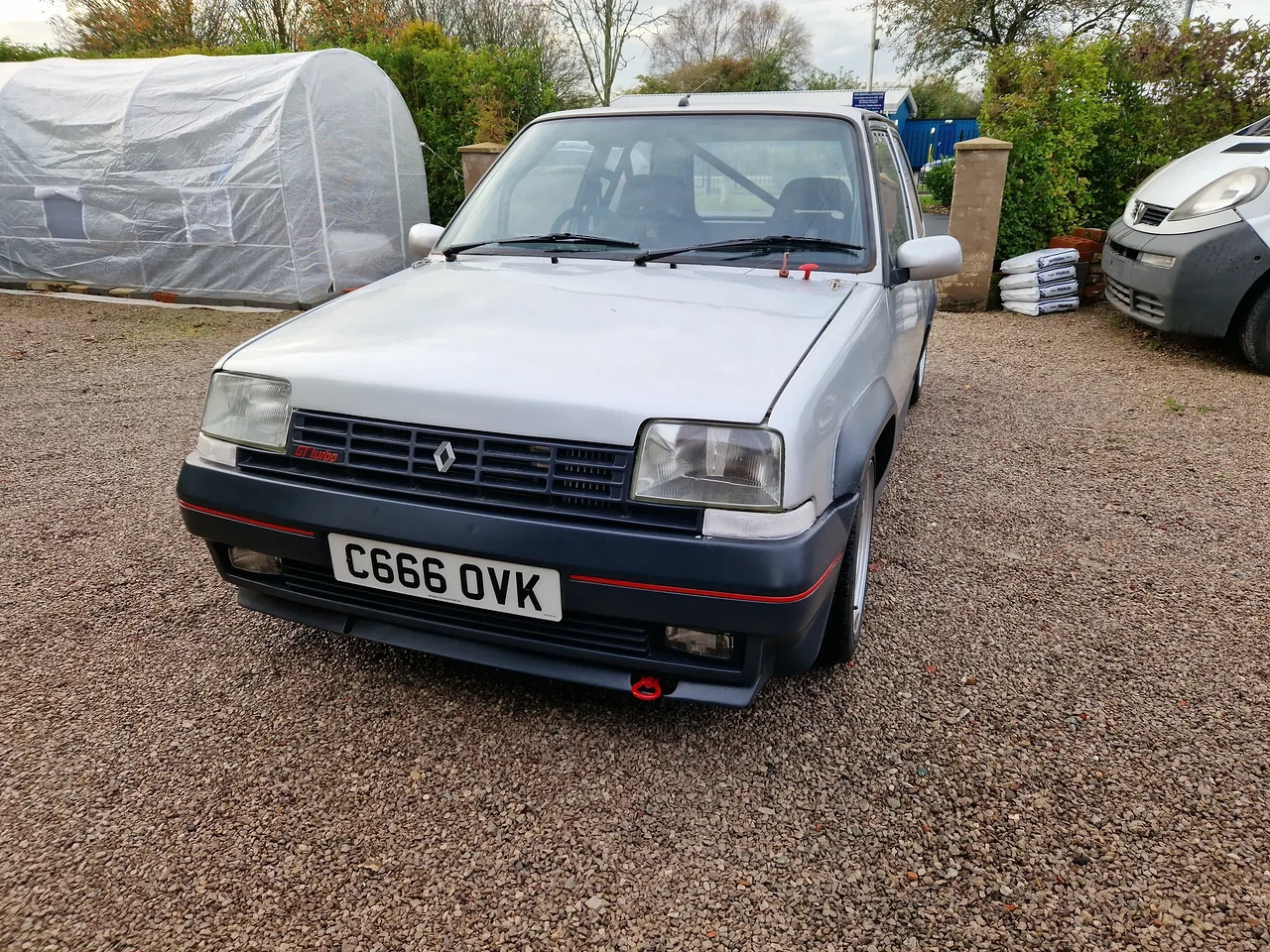

Fitting the kit and improving a few details like the badges
Bumper on too, hard to tell its all repro fibreglass!

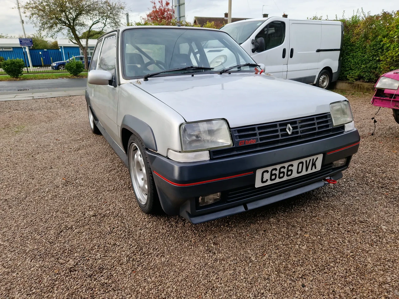

Adddin the front arches was tricky. It previously had wide arches as part of the wing mould which had been trimmed off, not leaving much for the new ones
Attention to detail with the badge

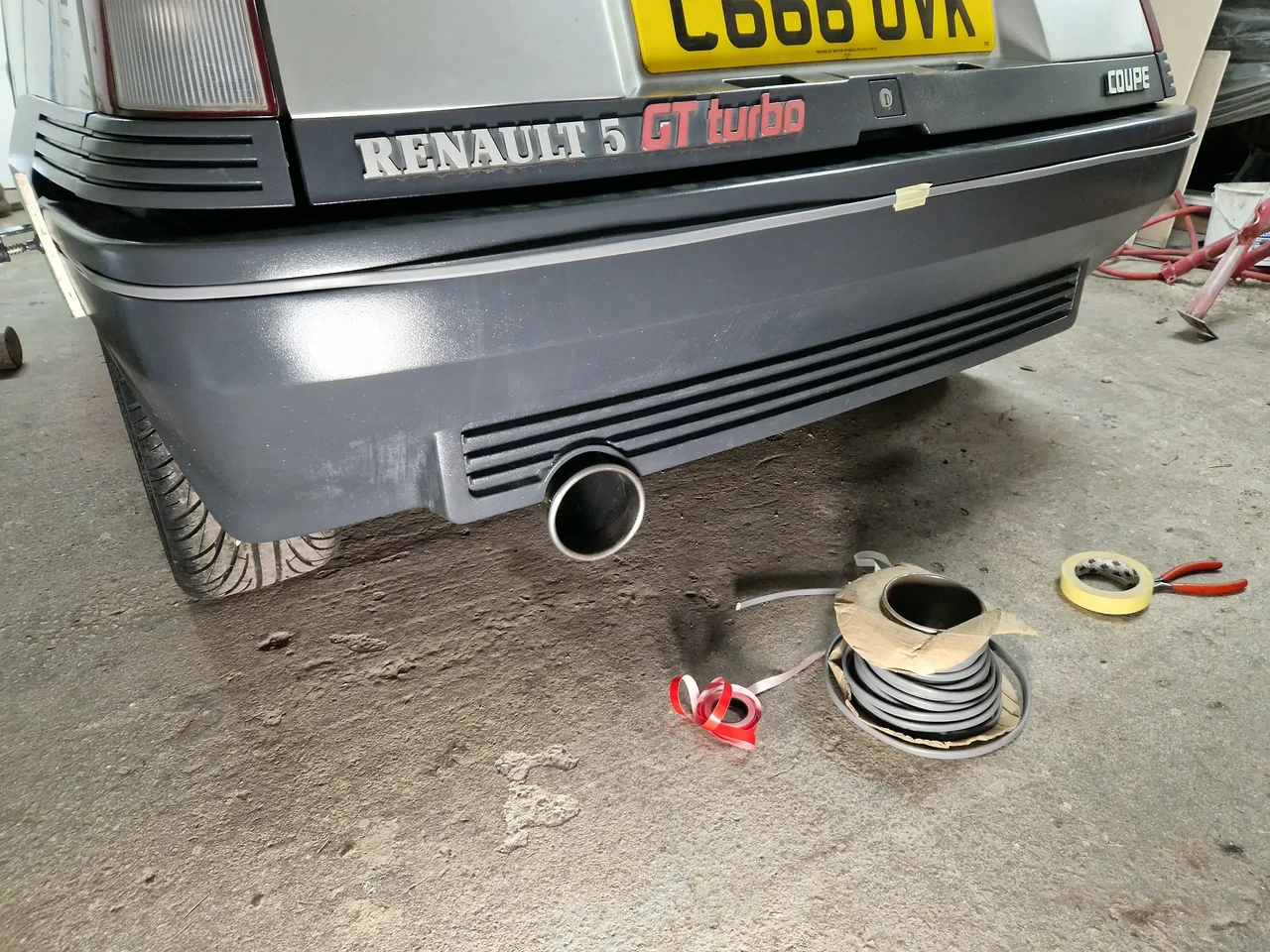

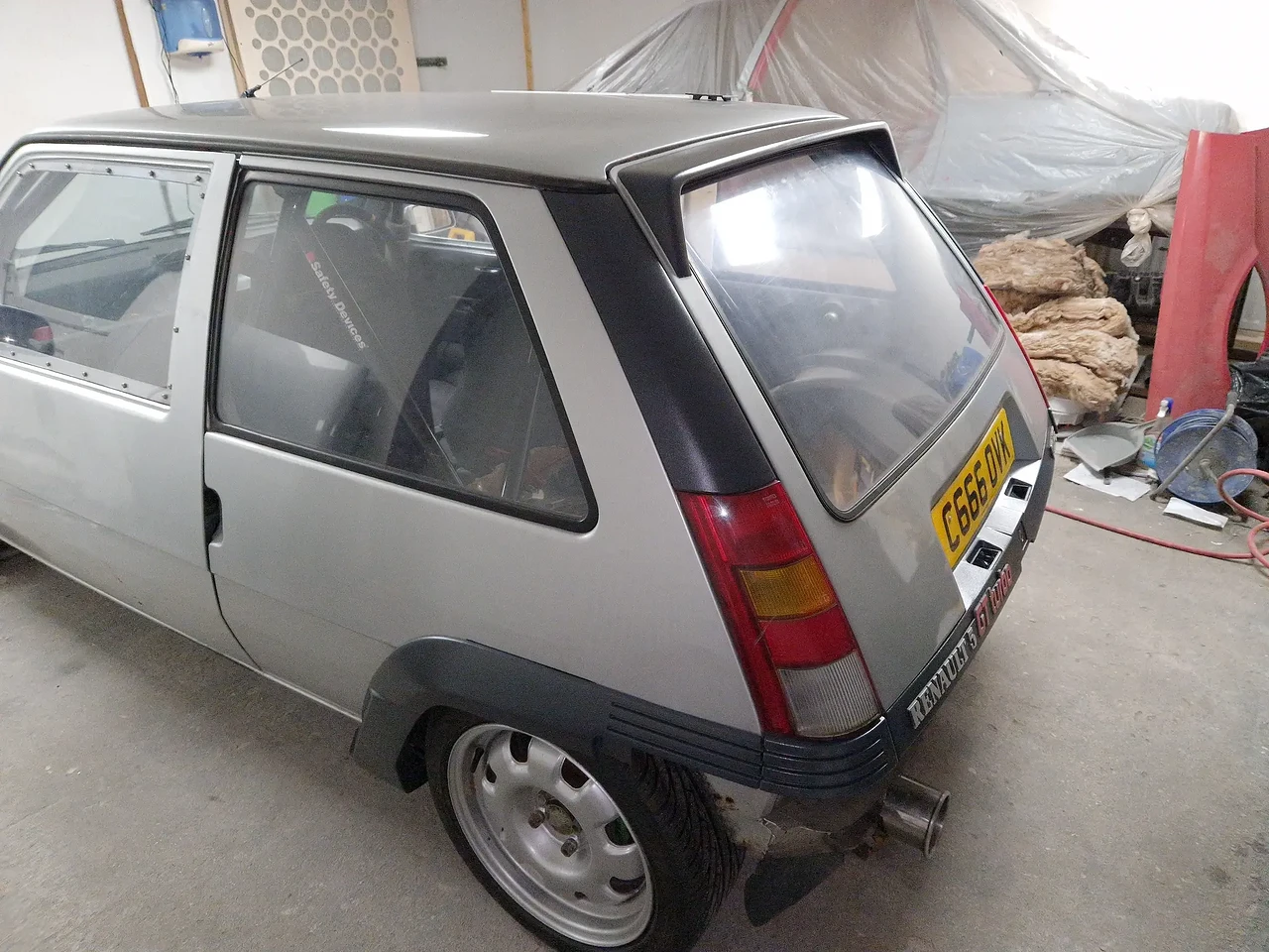

Sourcing anything half decent as the ph1 strips proved difficult, so a quick fake it with some 1.5mm twin and earth
With the same process at the back
Bond in with some tiger seal
Fitting the foglights and once the tigerseal has cured, a coat of 2pk on the strips
Fiddley amd worth it. Felt the tow needed some tlc too

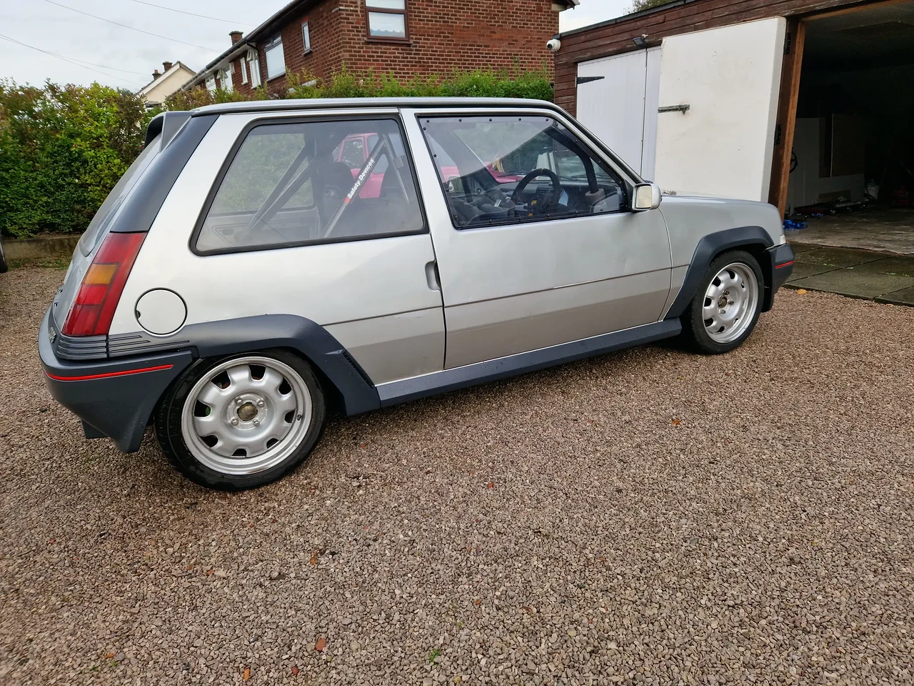

Around the window looked a bit odd too, lacking the oem seals
Windows removed, some satin black “edging” and bolts replaced with black ones
Certainly improved

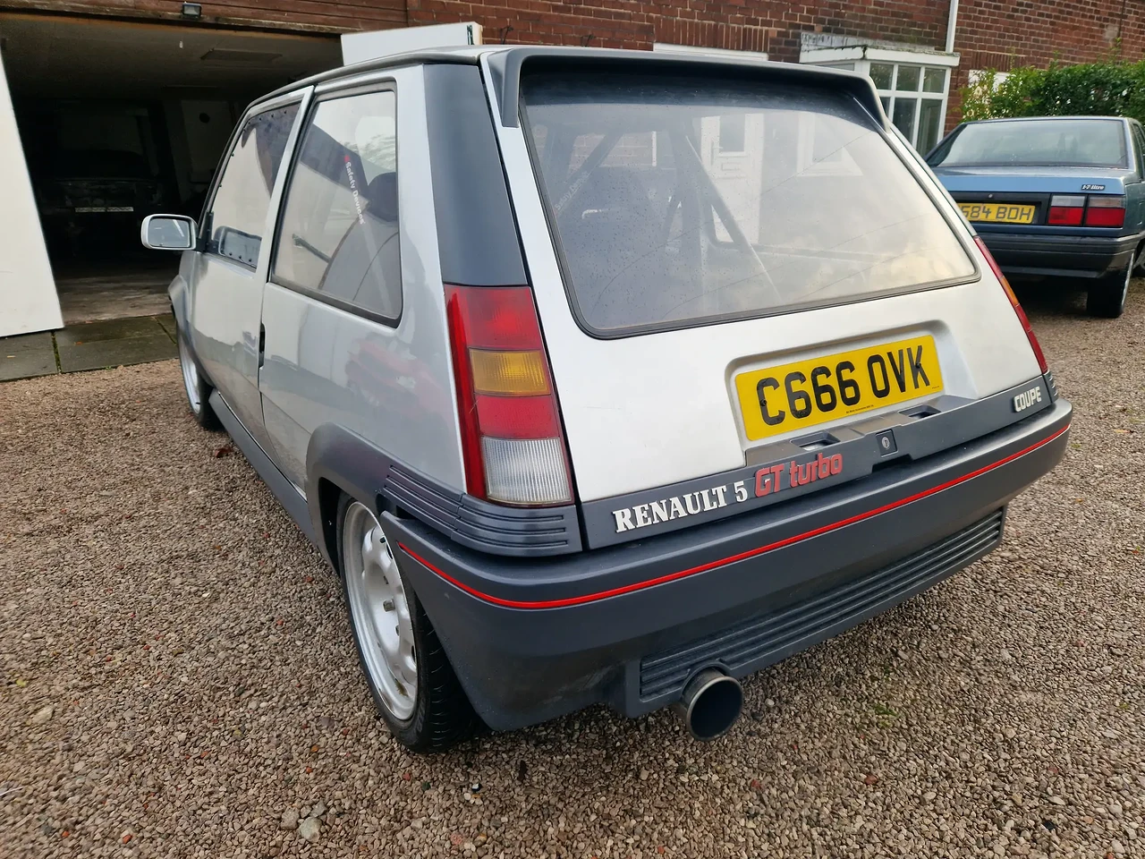

Once complete, did i mention the wings were fibreglass too? For a car thats mostly replica panels it looks even better under natural light.

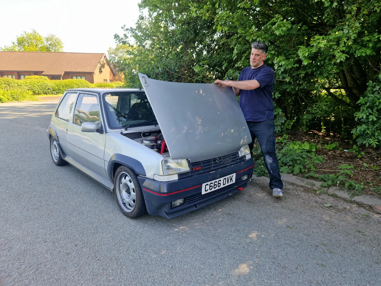

Owner looks happy @50 shades of tungy

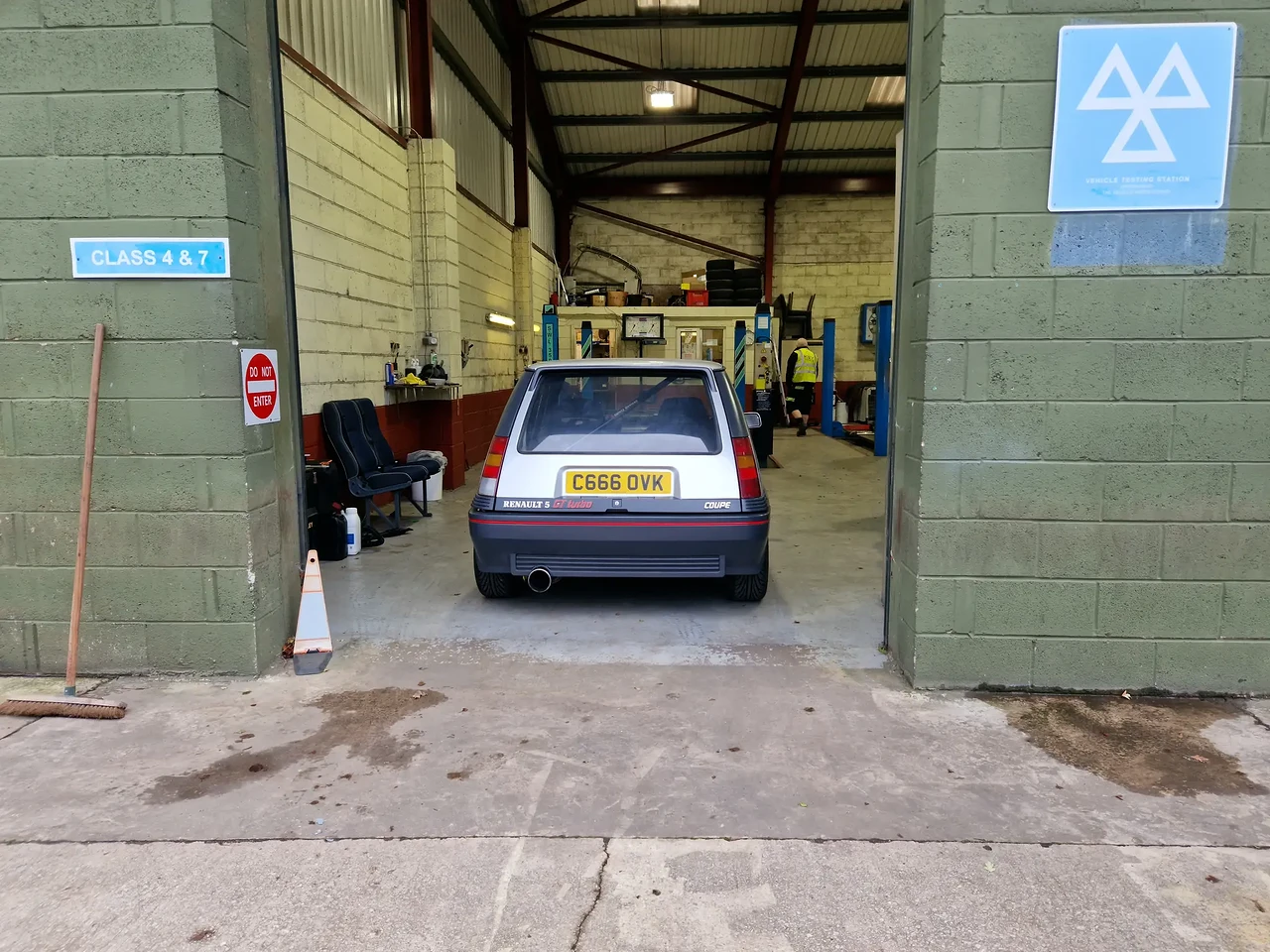

Out on the maiden voyage, and its mot
A more spirted drive on the way back resulting with a squeaky alt belt
Back to hq with no issues. Another back on the road

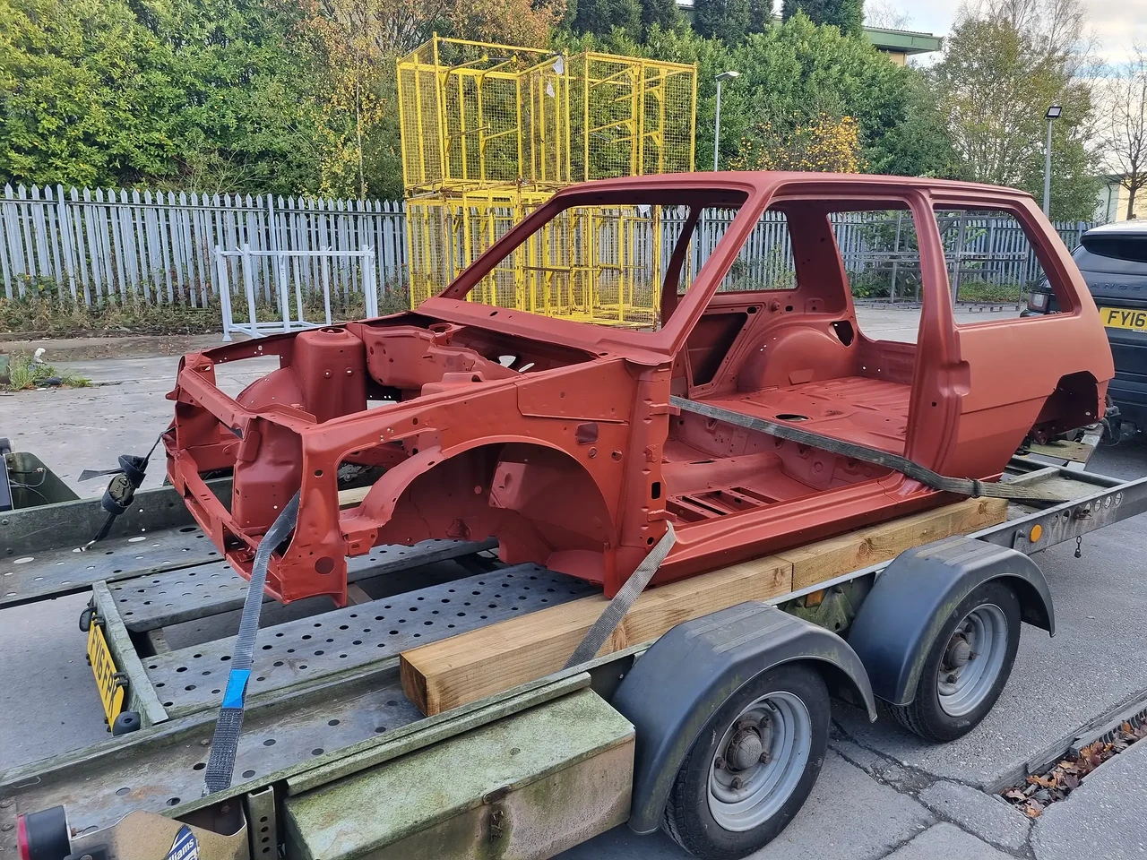

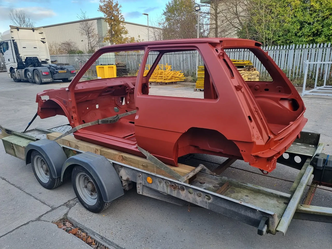

Bob has since seen the car while being used. He regretted selling such a good shell and made robin an offer. It has been sold back to bob and has undergone furher works..pulling it all apart and turning it back into his hillclimb car
