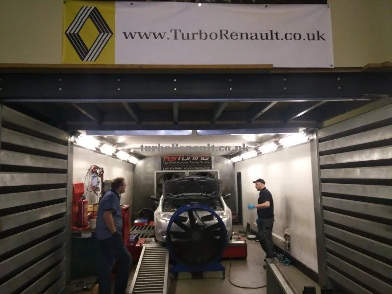

I was up first, so the old girl was strapped to RSTUNING’s Truth Tellers… :yes3.gif: (10 TR Points to those of you who can spot the subtle support for the Internet’s #1 Turbo Renault forum in the picture below..) :bt:
