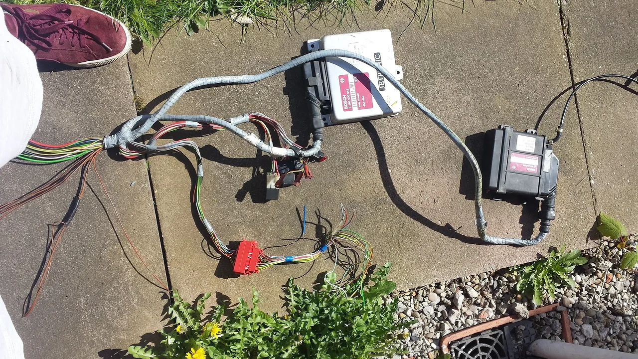

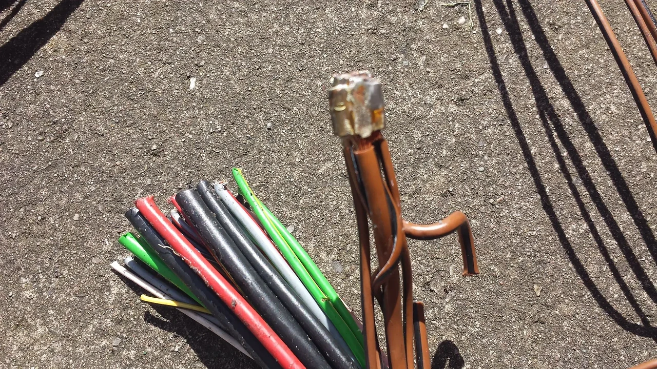

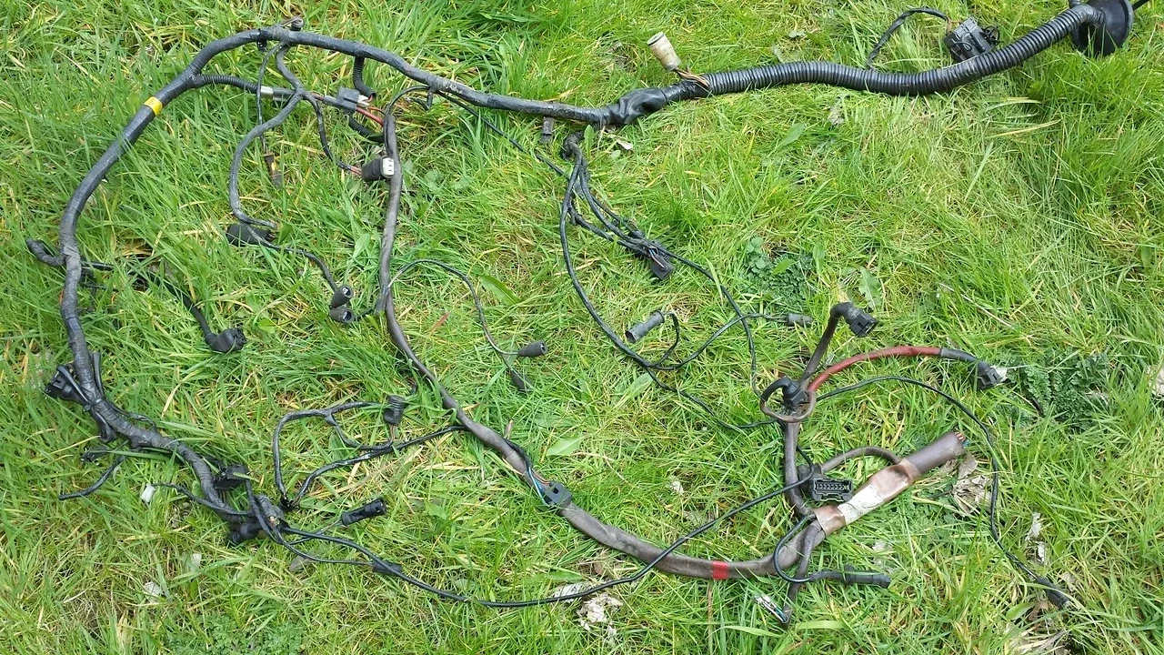

The biggest problem is the wiring loom… The nugget who took it out of the car cut it off at the bulk head:
Am i right in saying this is the only loom im after the conversion? Taking that its got both the ignition and fuel ECU’s on it. I know i can just connect the each wire back but theirs more than one colour of each… So i could get them wrong? Any help?
Also what does the red plug do? Is that where i gain my live feeds and earth from the car?

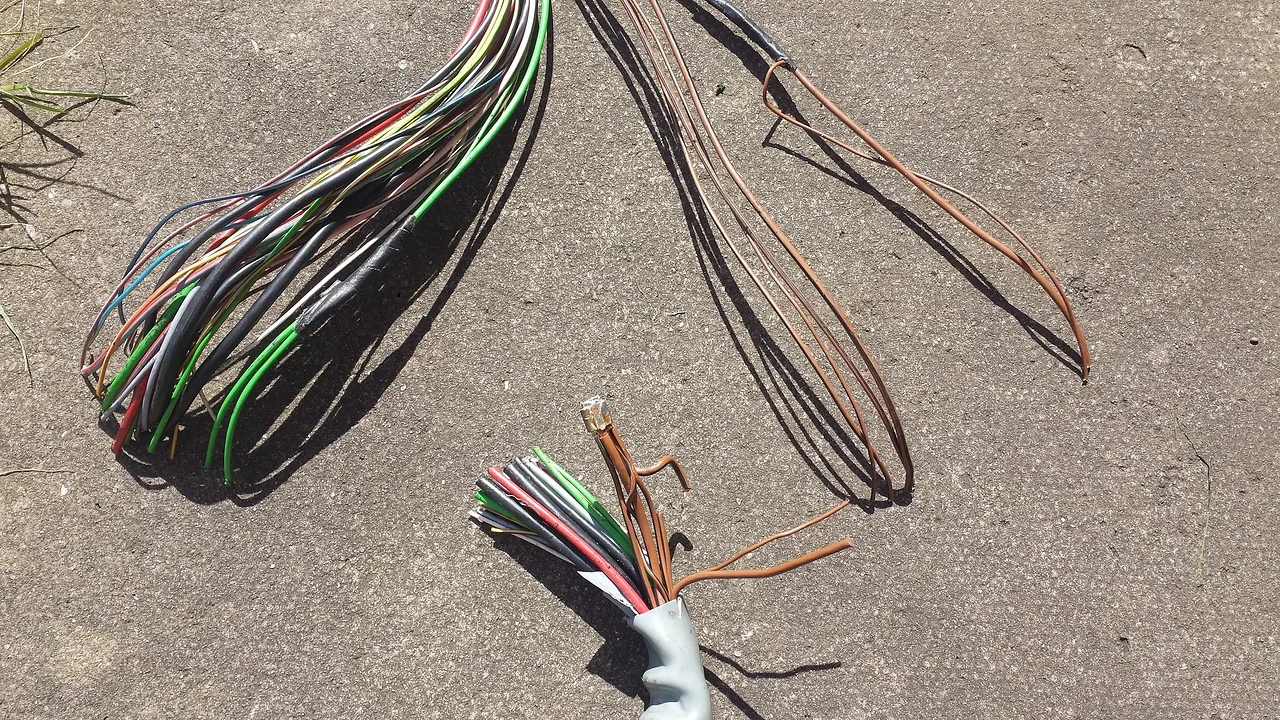

I also got another set lot of loom that had also recieved the same treatment. What a penis.
Am i right in thinking this is not needed? And was used to power acilaries for the rest of the old car? Can i throw this or is any of it used?

Agree the guy was a tool who cut the loom out…or he’s never tried soldering. See here for 480 wiring diagrams:

Nice one for that mate I’ve been after them wiring diagrams, should help. That emissions canister is it needed? It won’t be fitted if it’s not needed. What’s your opinion on the state of that turbo? I think I might post dog poo through the guys letter box who took this engine out the lemon.
Wiring loom is probably salvageable but not ideal, he was a right tool cutting it out like that.
You don’t need to connect many wires to the 5 to get the B18FT running (done few conversions myself) but its worth checking the Volvo diagram to make sure its not had bits cut off

True that, right so i’ve not got any gear to start repairing this wiring today ill bring it home from work with me monday, but been looking at it, im presumimg:
Brown and black are the earths, since half of them seem to join at a crimped connector, so i can join all them up.
The rest of the colours i should be able to join back up, although their are a few of the same colour so these ill have to scan the wiring diagrams to sort, any pointers?
Also what does the red plug do? Is this where im wiring the loom into the car, lives and earth etc.
The rest of the loom seems to be intact, but am going to run through the wiring diagrams ive kindly been sent when ive got an hour or two to get my head around the whole system, to see how it works and see if im missing anything.

Ok, so ive been busy with life stuff i.e work, family, standard stuff. Ive pinched a bit of time here and their to crack on with the repairing of the loom:
So its repaired. I need to test it, then wrap in a nylon loom wrap, tidy a few other bits up then she should be good to go. For anyone who was reading further up and is interested in the route i went with repairing then…
The shielded wires: I connected the core wires with these… Pretty much a heat shrink with a band of solder in the middle and when heated solders both wires together and gives a tight plastic cover for protection. I think their pretty shit hot tbh.
The ‘shielded’ part of the wire, which goes around the center core i pretty much tried to wrap around the core as it originally was, then used copper foil to wrap around that, making the shield complete as best as i could, then heat shrink over than to seal it. If it works bonus, if not then im still after a new loom. Them wiring diagrams are absolute gold @jamesy12345 :clapping.gif:

I would bin that exhaust housing on the turbo. You have done well to splice the loom together, i chopped one about 12 years ago to lose some wiring and i instantly regretted it when looking at the wiring lol. Keep the updates coming

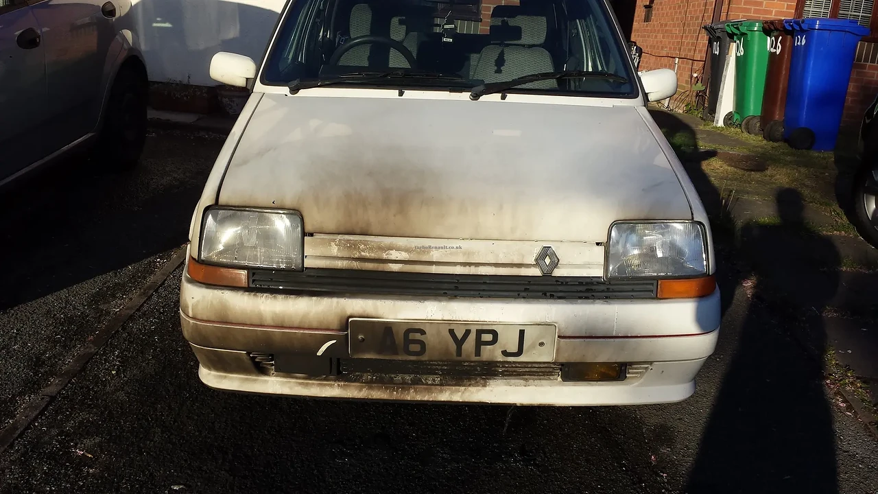

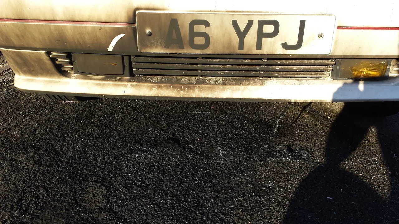

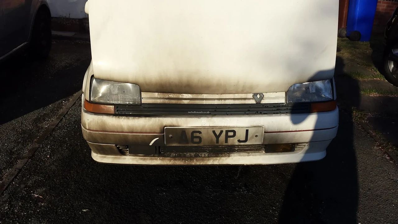

Right. So my car just caught fire. Like 13 seconds away from detonating caught fire…

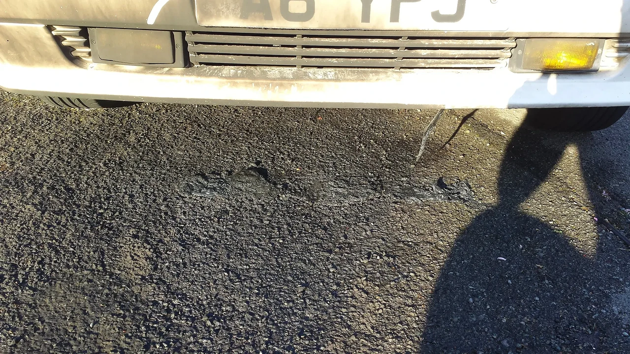

Nice bit of plastic trimming all over my drive
Not ran her for like 2 months, took a while after cranking for a bit, could smell the petrol, she fired up and ran for like 30 seconds, then boom! Full engine bay on fire I thought shit, extinguisher, nar I’ve not got one, bucket of water ran into the gaff filled the pots basin with water casually as the car is about to detonate on my drive, got the misses to fill a load of glasses up bam leathered the b***ard with as much water as the tap would allow and it finally gave in. Shit my self.
My land lady any gonna be impressed about this shenanigan.:cd:

oh dear! looks like you caught it though, hopefully can be saved?
The engine loom, turbo, the intercooler and rad pipe work, exhaust downpipe from turbo and the rad itself and maf sensor maybe a few other things but can’t think at the moment?
Yeah she should be right, looks like I’m ripping the engine out on this earlier than expected, so I can go through the engine bay make it all sweet. I don’t think it’s that bad but it’s hard to tell till I’ve got in their. None of the neighbours even came out which is surprising. One can only laugh :download.gif:
