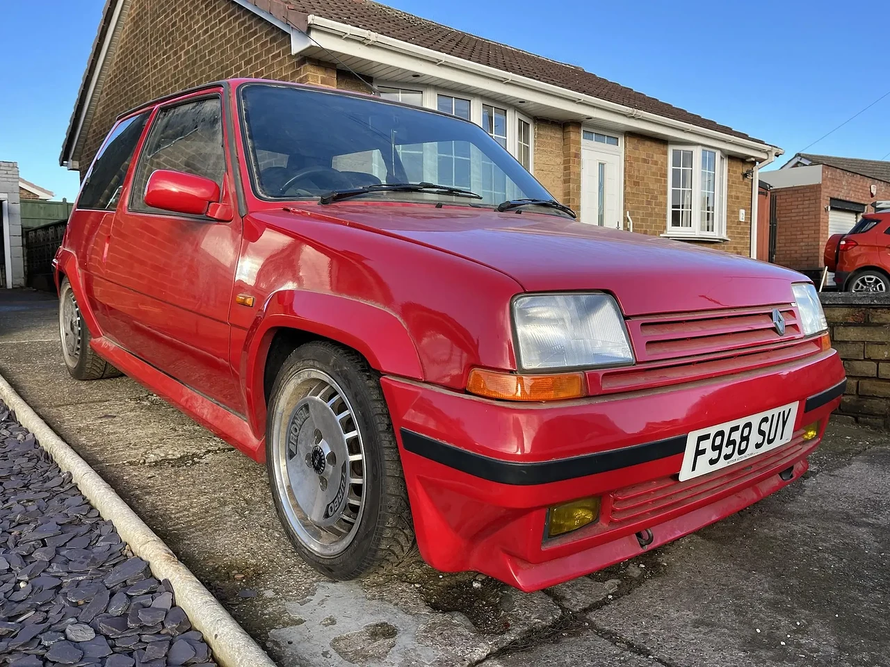

Later that night, Little Chef car park on Little Eaton roundabout, in rolls a little red 5… It’s safe to say that I didn’t take much convincing. £1600 later, the love affair began.
The earliest photo I can find. Sorry for the terrible photo! :rofl:
A few years later, RTOC national day at Mallory. 2006/7 ish i think.

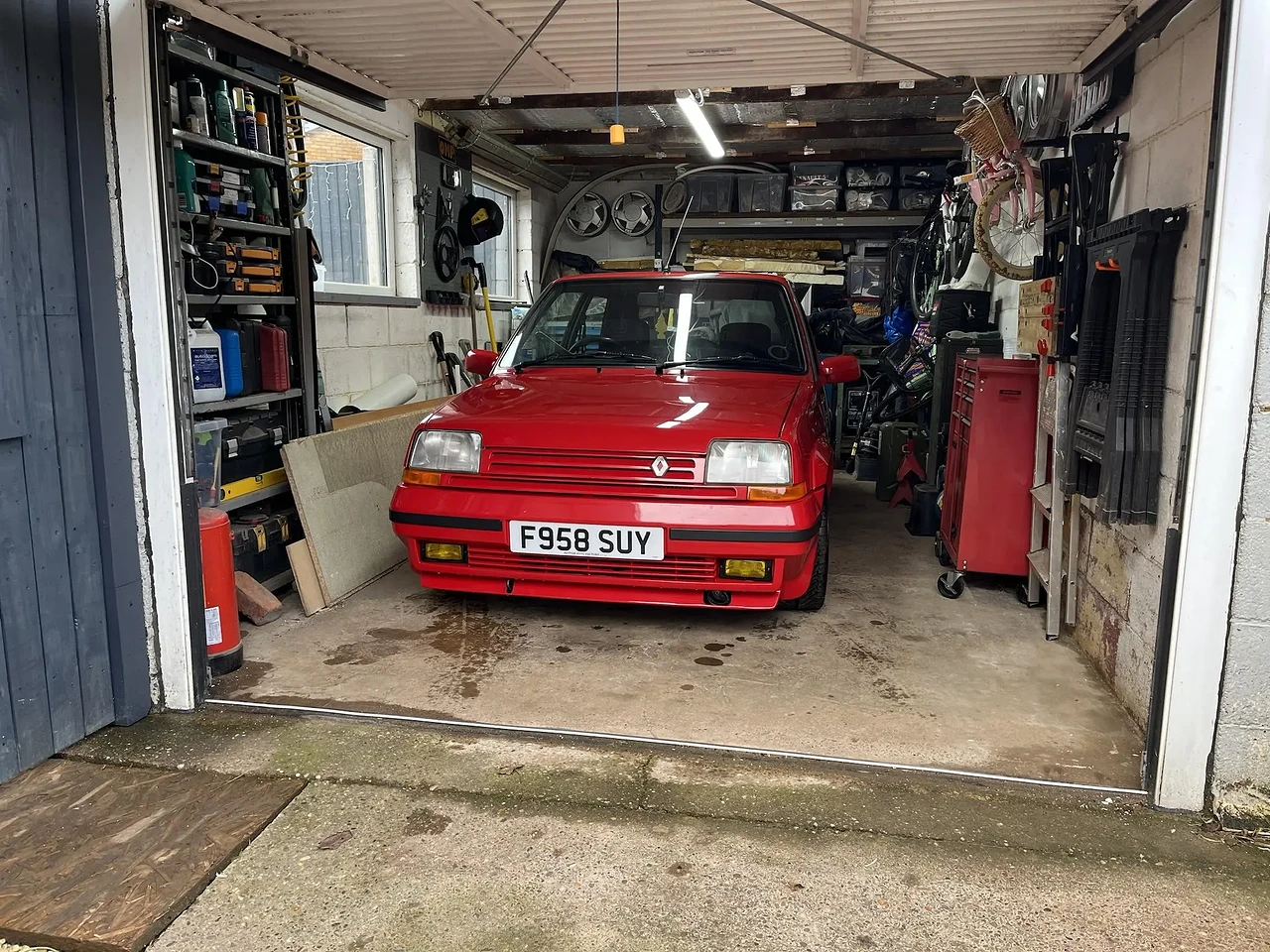

I daily drove it until November 2010 when I garaged it while I played around with some other projects, Saxo vts and a VW bay front camper. I didn’t plan on it being off of the road for much longer than a few months, maybe a year… 13 years later, a wedding, two kids, two kitchens, a bathroom, a house extension, some wrinkles and a whole load of grey hairs, here we are.
I finally have a bit of time to get in the garage so I’m going to get the 5 back on the road.

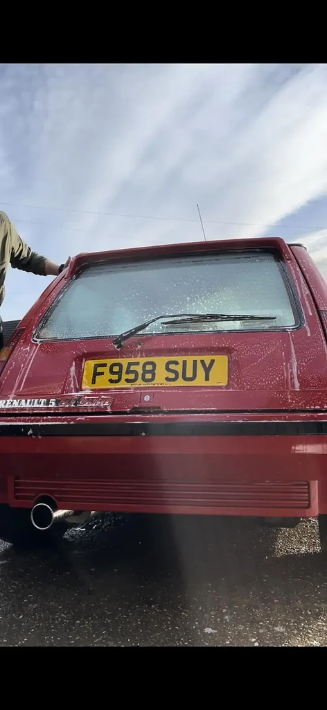

She’s a little dusty
Getting it running - thanks @Brigsy for your help

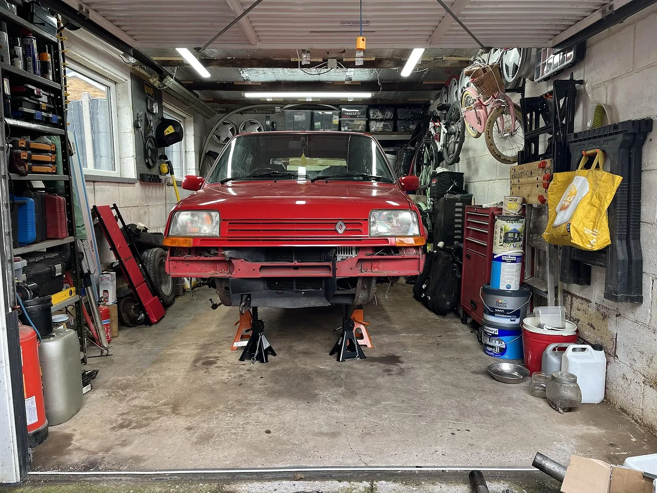

And this is how it looks now.
Body kit, exhaust, petrol tank, brakes, fuel & brake lines and front suspension all removed. A few more bits and bobs to get out of the way then I can properly assess the situation. There’s obviously rust to deal with but it isn’t actually as bad as I expected. I’m sure there will be plenty of surprises yet though.

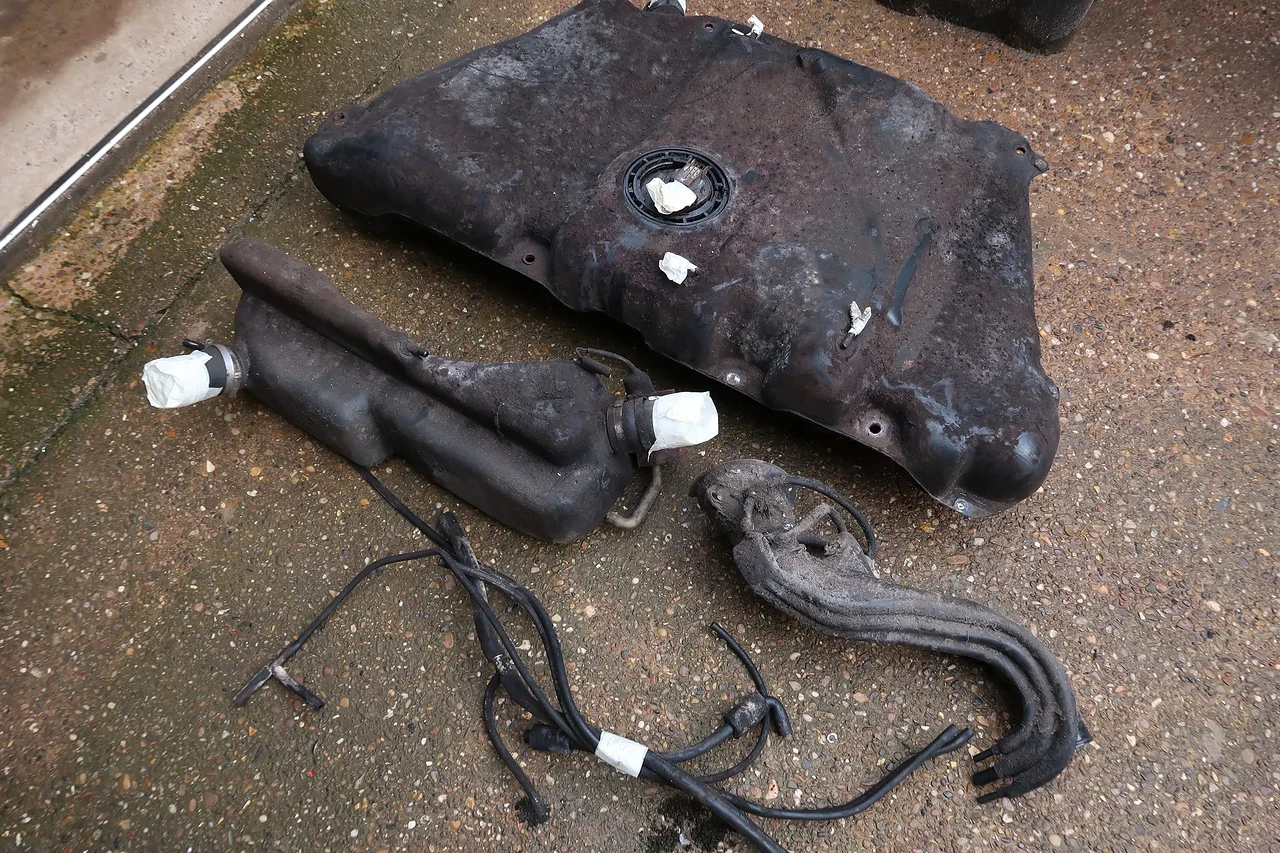

The fuel tank is pretty disgusting but I’m sure it will clean up ok. I do need to repair the dreaded ‘bung’ though as it did used to leak when putting more than about half a tank in it.
Reserve pump bracket has seen better days.
Much like the non-existent filler neck/non-return valve bracket :rofl:

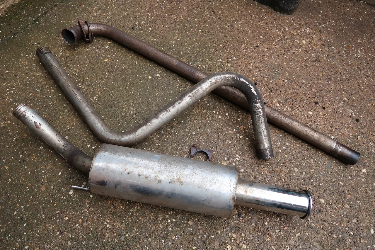

I’m not sure what brand the exhaust system is, it was on when I got it. It seems of decent quality and will definitely clean up.

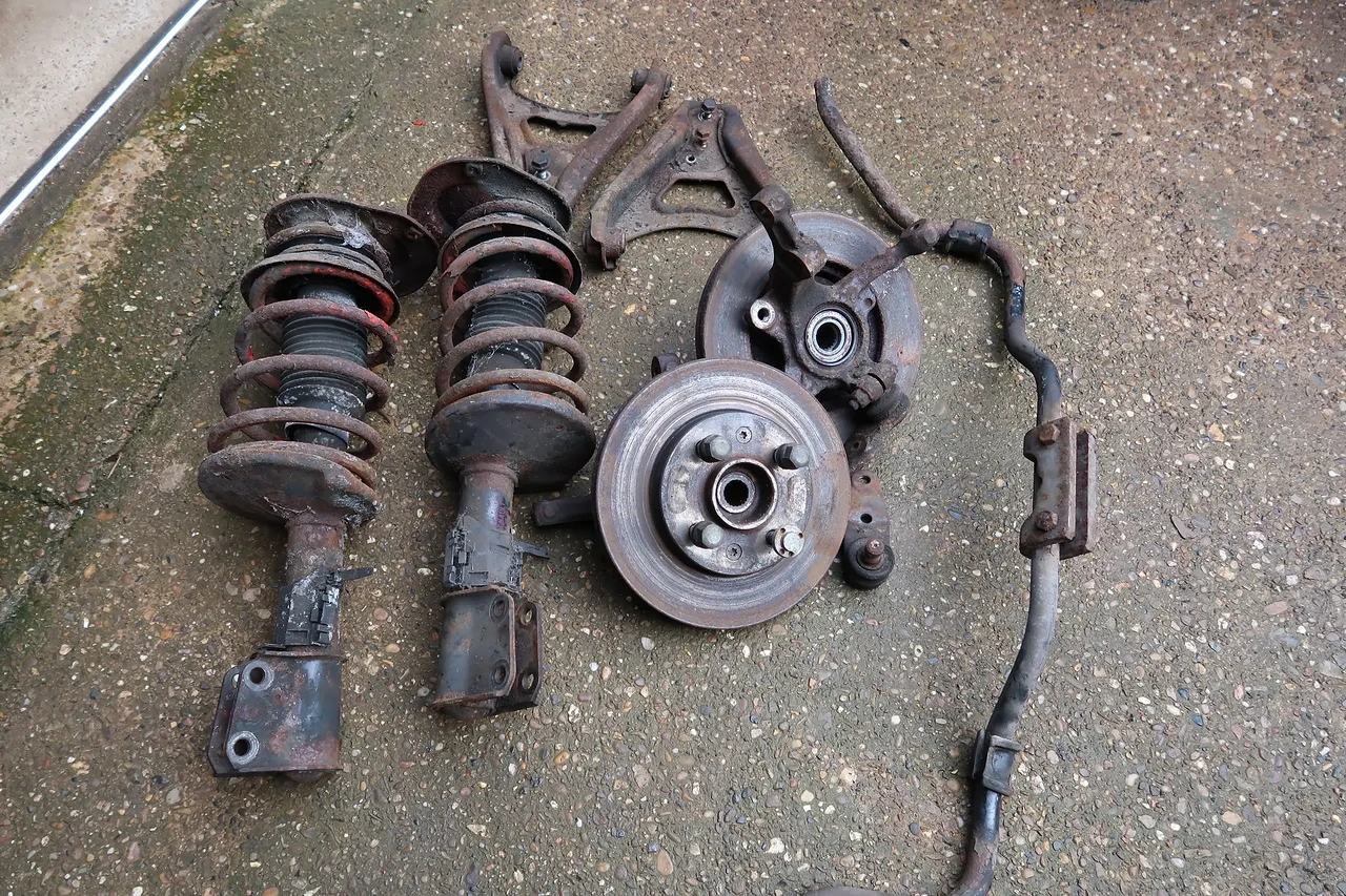

Front suspension all came apart no problem. Some of it will clean up but most of it will need replacing.
Shocks look alarmingly worse for wear. They could well be the originals :eek:
Obviously aftermarket lowering springs. I’m not sure what drop they are.

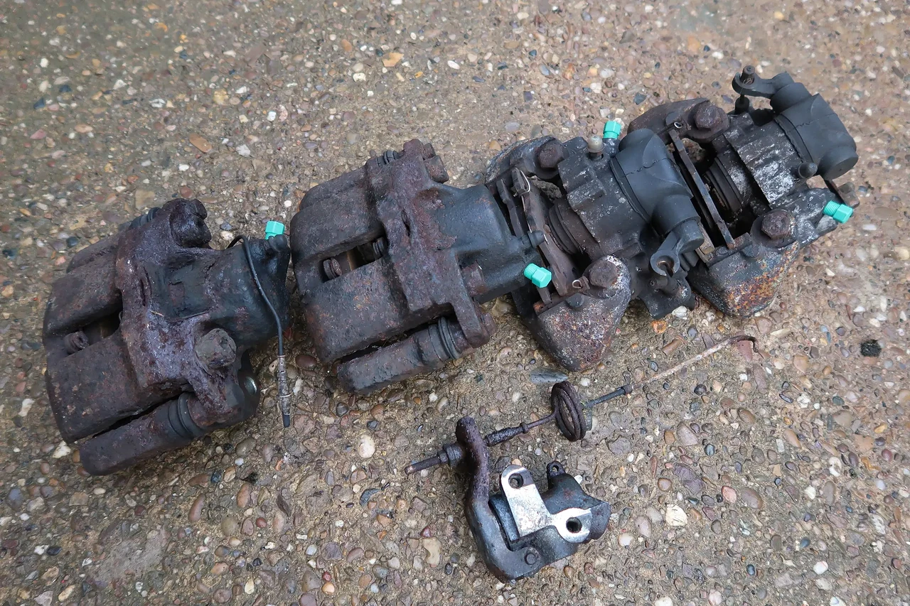

Calipers are very tatty. I’ll most likely rebuild them myself. I’m not sure about the rear comp valve. I’ll look at this at some point in the future.

Exhaust looks to be an old ktec system. Similar look to scorpion but sound way better, had one on my white gtt.
Interesting that it might be a ktec system. Cheers for that, Brigsy. I always liked the look and sound of it so it will be going back on. Albeit, a bit cleaner!

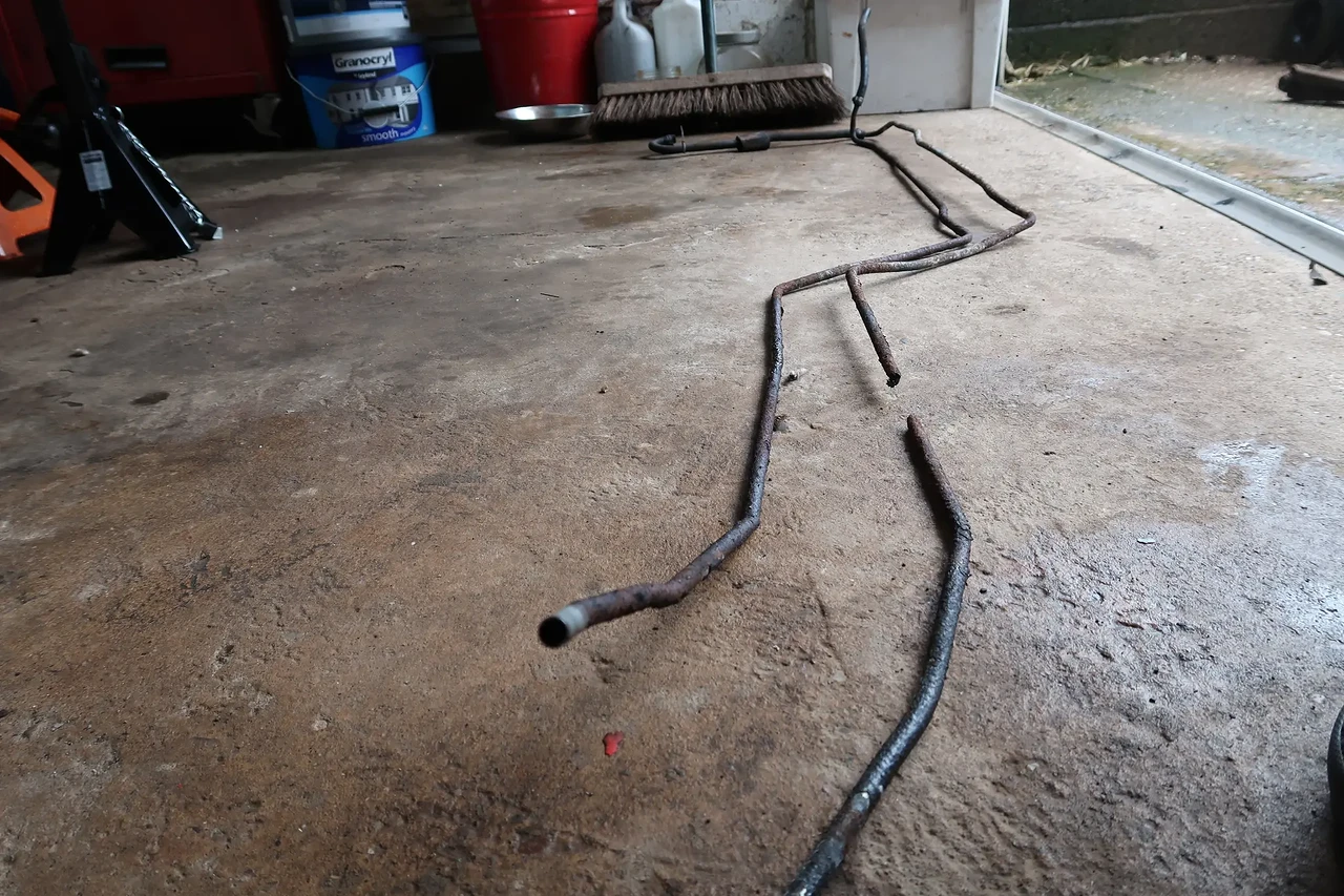

What are you guys re-making the hard fuel lines out of? As you’d expect, mine disintegrated as I removed them.
Copper 8mm microbore pipe works ok for fuel line replacement.
Cheers mate. Copper is pretty easy to work with at least. :+1:t2:
