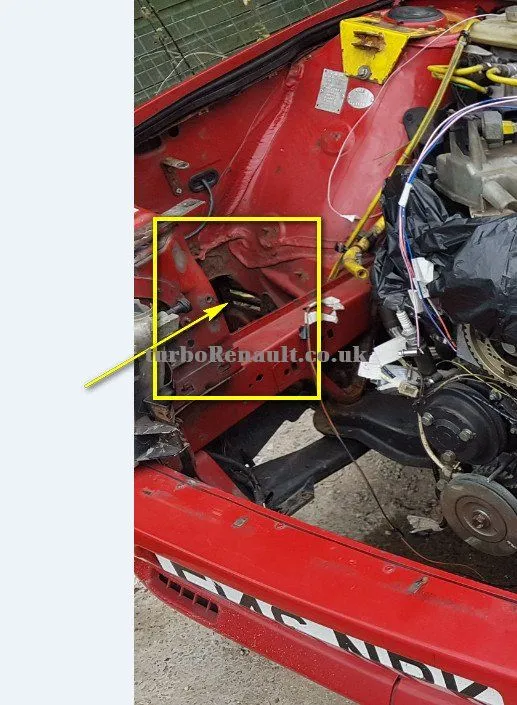

Note for me: now that I have gone FMIC and removed the top intercooler, I must blank it off! My FMIC is a bit big and so the bumper doesn’t quite sit straight, but it’ll do!

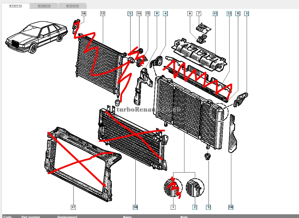

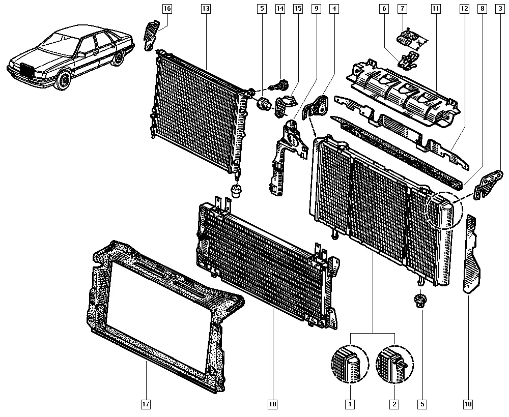

But doesn’t the radiator already have a shrouded intake from the grill (no 17 below)? If so then the deletion of the top 'cooler won’t make a difference?
Can’t remember if the Turbos have this or not.
The top cooler will leave a hole , no ? Its been a while since I have had a 21T!
I am not sure. Looking at that diagram I would have said that the top cooler is shrouded by 11 & 12, and the main airflow is directed by 17, so it won’t make any difference. But again, I haven’t had a proper look in that area for years!
Scribbled out = not on Turbo.
That makes more sense.
