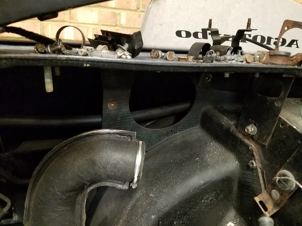

Coils from a Chevrolet LS1 or similar! Exciting because they can be triggered directly from low current/voltage. Giving the advantages that they can be triggered directly by the Megasquirt and they will introduce less electrical noise due to the low triggering current. And they are pretty powerful by all accounts. One coil per plug. I’ll be setting them up in a wasted spark arrangement initially. Probably feed individual trigger wires through the bulkhead and just connect them to the ECU in pairs.
I’m thinking of mounting them where the original coil was:
But I am a bit worried about the strength of the shelf and whether it will support the new coils OK. I’m thinking of strengthening it above and below. The advantage is the packaging - I have loads of space… Will probably stack them on top of each other - two groups of three. Even the original HT leads will work (at a pinch), but will need to be rerouted. Could be messy to begin with.
