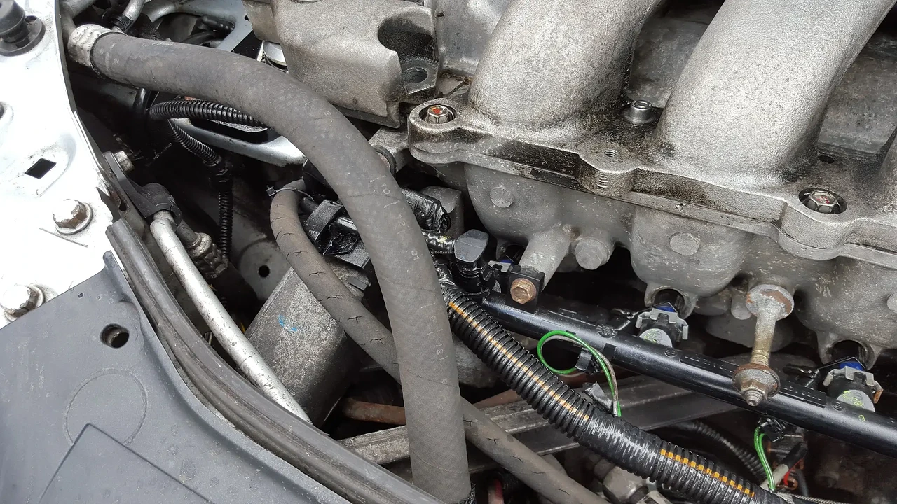

First thought was the fuel line that was showing some age had let go but strangely it wasnt, the push fit connector on the oem line had decided to come off after about 150miles of me driving it.
It emptied about quarter of a tank of fuel into the bay in less than 30 seconds! Anyway pushed it back on and put a cable tie around it to make sure it couldn’t lift off again.
Right so I got the car up on a jack and replaced the upper engine mount with a vibratechnics item to try and stop the exhaust hitting the subframe, it has helped alot but still needs some adjustment. I also removed the diy return line and fitted the OEM ph1 line in its place. Its a plastic/nylon type pipe so shouldnt fall apart like the rubber hose that was there. There is about 4 inches of fresh High Pressure line on ther that i used to join the fuel line where i cut it for removal but its now minimal vs the whole lenght of the car. And whats was really nice is Renault had left the clips in place to take it so its nice factory looking fit.

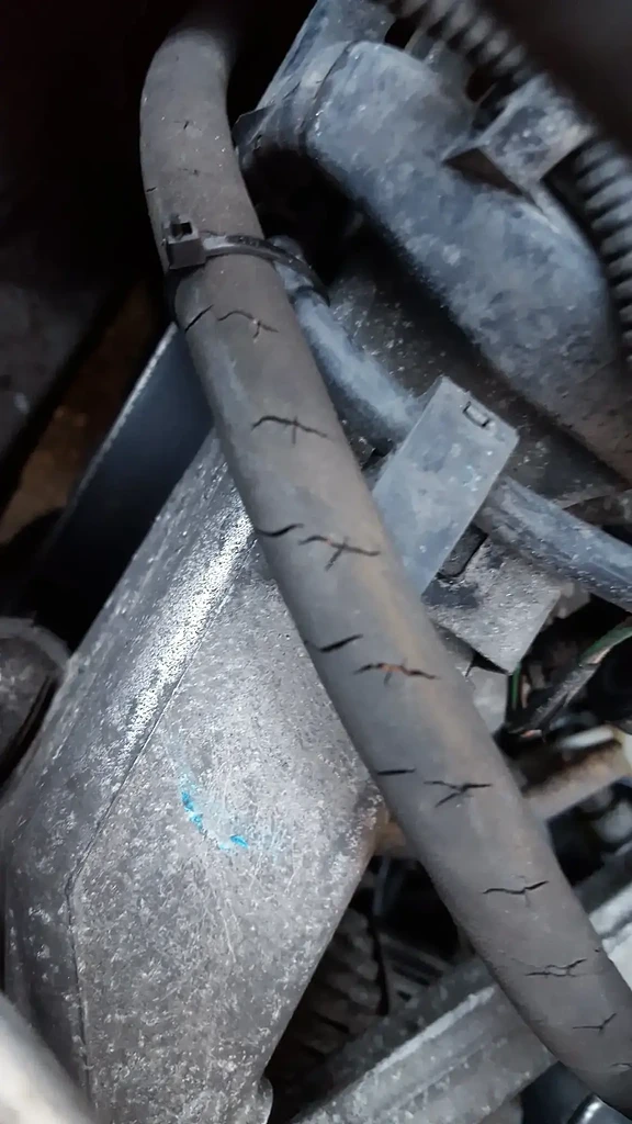

The old hose, was like this front to back, its only on the outer theres and issue and the return line isnt under pressure. On inspection the inner was perfect, but still unsightly

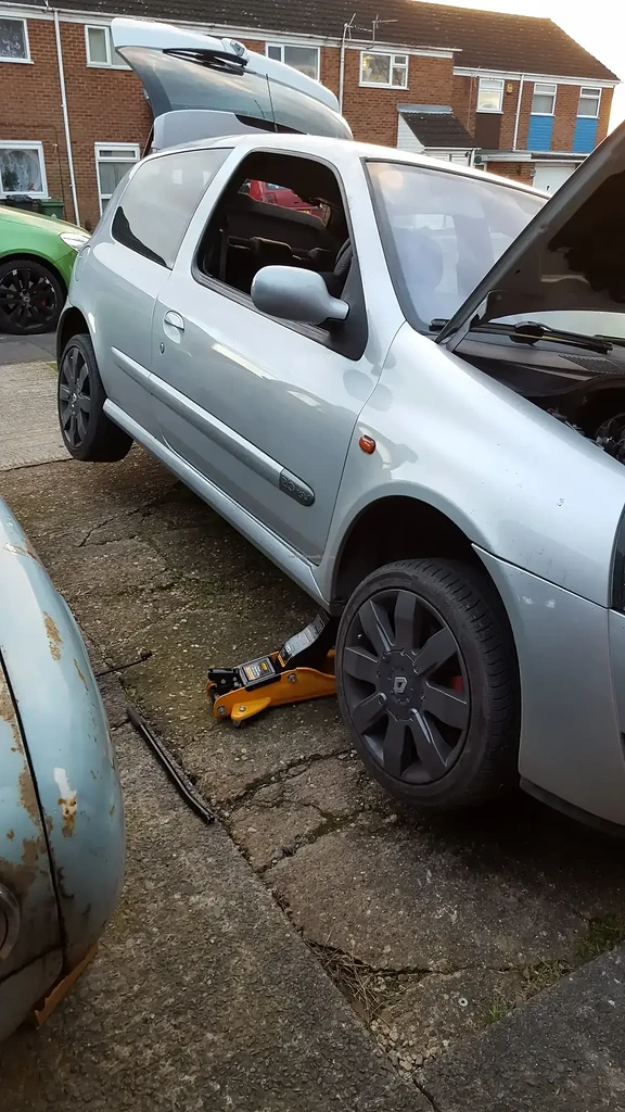

And in the air for the rest of the line fitting.
and parked up against the Twingo
