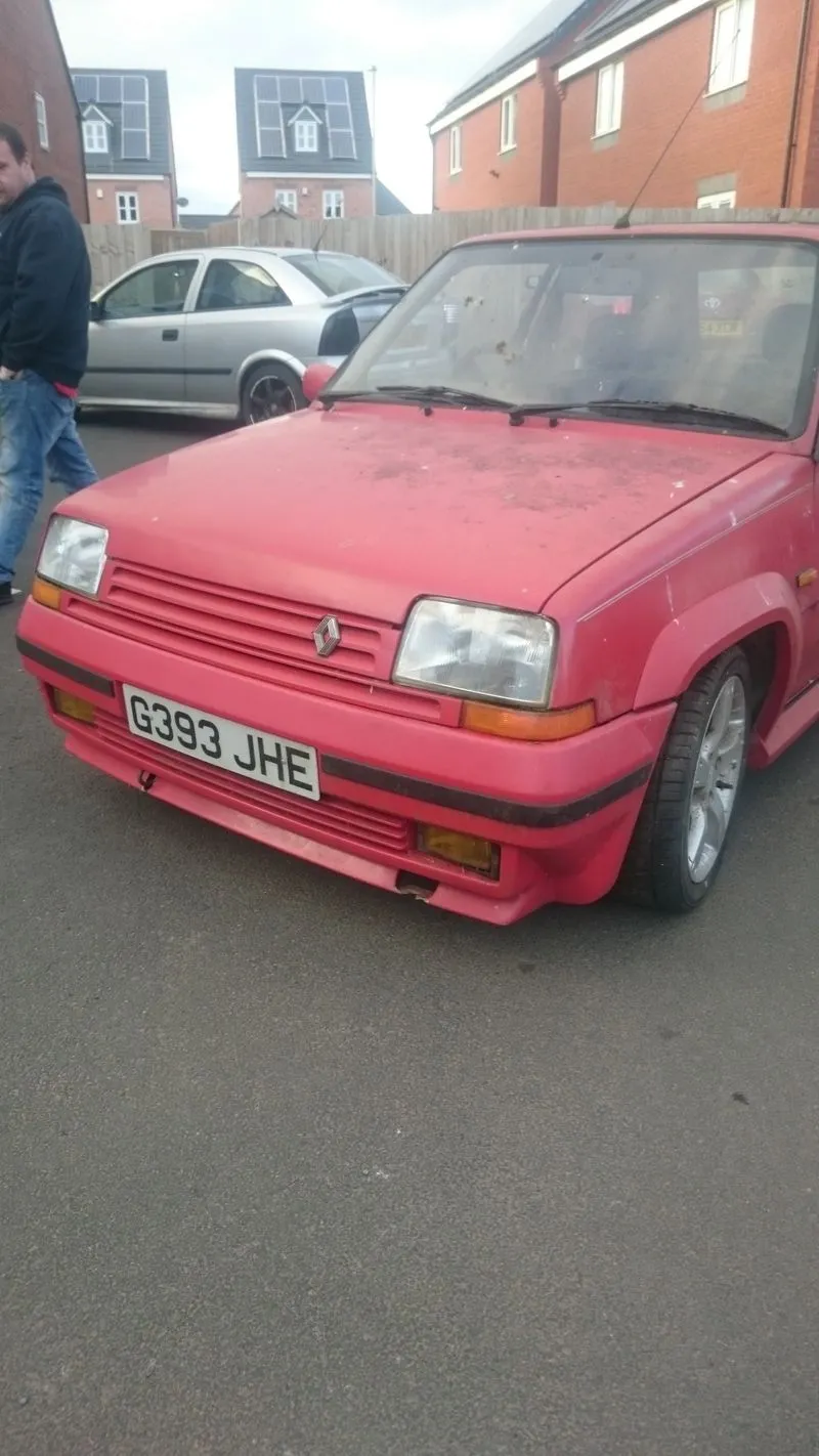

I very nearly threw in the towel and bought a new Nissan Gtr, but I preferred the money in the bank then sat on the driveway. But then one Friday night I was on my phone searching and I came across a car on Gumtree in Leicester. The catch? Well it had been stood since 2003, didn’t run, no log book and no history! BUT, it was 98% original, 70k miles, Red (well faded pink and mouldy) and even amber indicators still! So the next morning I did the hour and a half trip to see it, it ticked a lot of boxes but wow it was rough as you’d imagine! Still I know these cars well and there’s not a lot to them, I had restored a fair few back when I owned a body shop, but that was 10 years ago when I had all the time in the world!
So I just had to have it, I booked a recovery truck there and then. Here’s how it looked:
