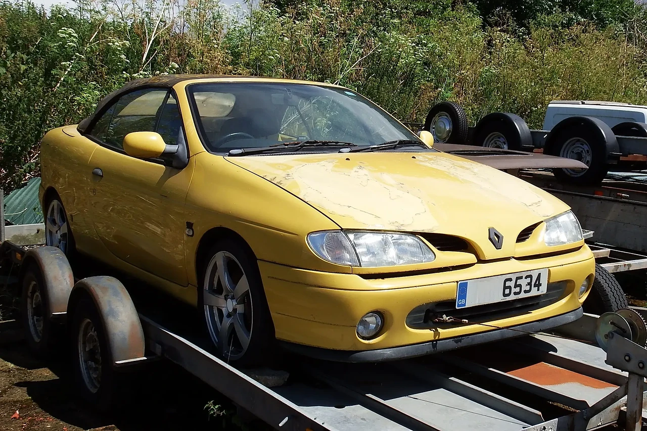

99 convertible - fitting a 225 engine
Not sure if this is the right place but here goes anyway
Hi - I joined to learn about the Megane 225 engine management
Have a 99 convertible in Yellow with Blue leather - engine is the 2 litre 16v - looking at the 225 engine
It already has Brembo’s on 325 discs up front and 253 vented rears
Have coilovers on the front and made spacers to lower the rear
Plain 5 spoke 17" wheels
Also has a “road box” in place of rear seat and a quality stereo

If you want to use oem megane ecu then you will have the headache of using an immobiliser emulator. As far as i know the mk1 megane is pre canbus then gettting the oem dash working ok is not a problem regardless of ecu used.
What are your goals power wise and what are you planning to use it for. I think you would benefit from a good standalone ecu regardless of what engine you use.
Saab is an excellent choice but fabrication needed and tall engine so may cause issues. Megane 225 will fit in easier and easy to find usually but if overall power is your goal then you will need to use the stronger 6 speed gearbox which needs fabrication to fit. Vag 20vt is also another option.
I’m not looking to go mad with this - just think a little over 200 turbo horses will be way more fun than the stock 150 it has now.
If I get the 225, think I would just leave it as is - so no messing with re-maps etc
If it’s just a chip key - can work with that but dash and body module is more of a problem
I’ve been restoring vintage Bentley’s for the last 20 years or there abouts so fabrication is not a problem.
Have a spot welder - plasma cutter - nice tube bender - welder etc so there isn’t much I can’t do

As you can see - standing around has not done it any favours.
Lacquer is peeling and the discs are so rusty, they need replacing
