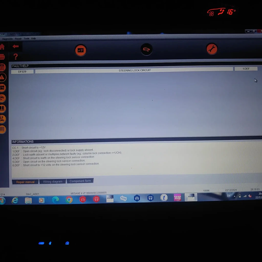

Here’s the only thing I can get off clip ATM

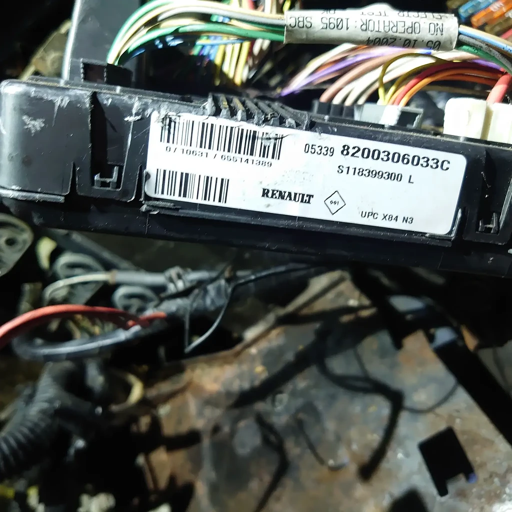

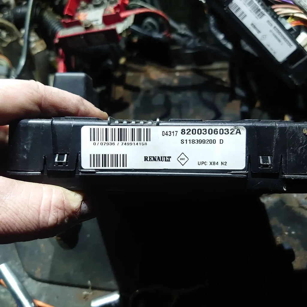

Battery was too big :joy::joy: so I’ve checked basic connections up by the upc/battery ,nothing seems amiss, I did notice there is two upc with the car x84 N2 and an x84 N3 not sure which should be in it,

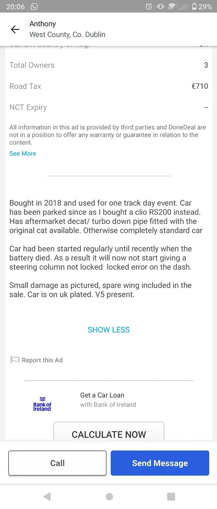

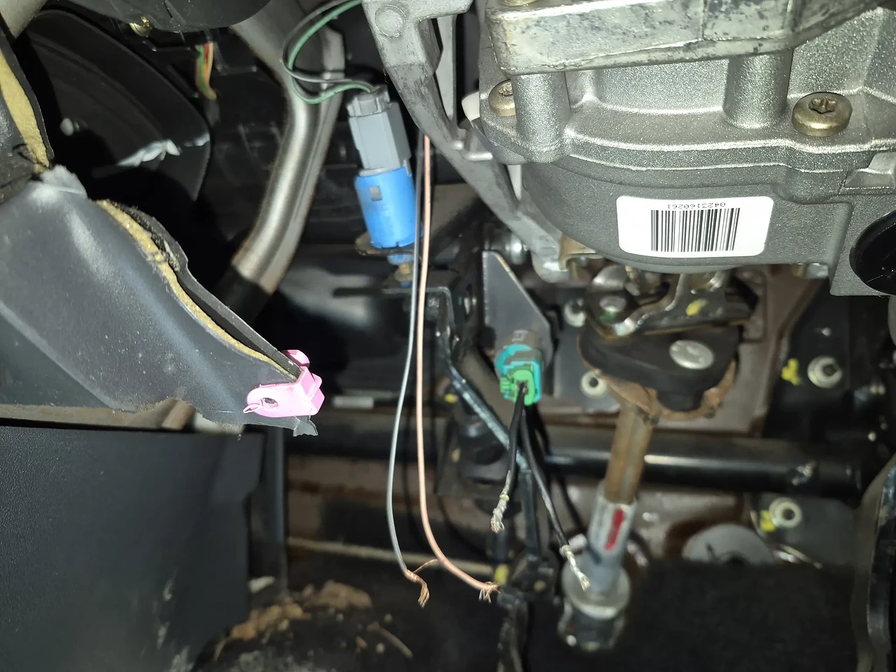

Now I should mention again this was bought with the steering locked/not locked problem, so I’m uncovering attempted fixes as we go along
There is two yellow wires stripped and joined, is this an oe arrangement that was stripped back for diagnostics and just not tidied up or is the other wire ment for somewhere else?
oh no…
Oh yeahhhhhhh, so just waiting on a virgin lock to arrive from renbreak and I’ll go at it again,

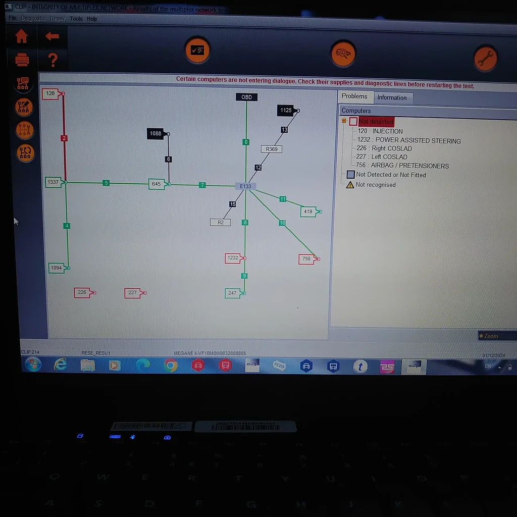

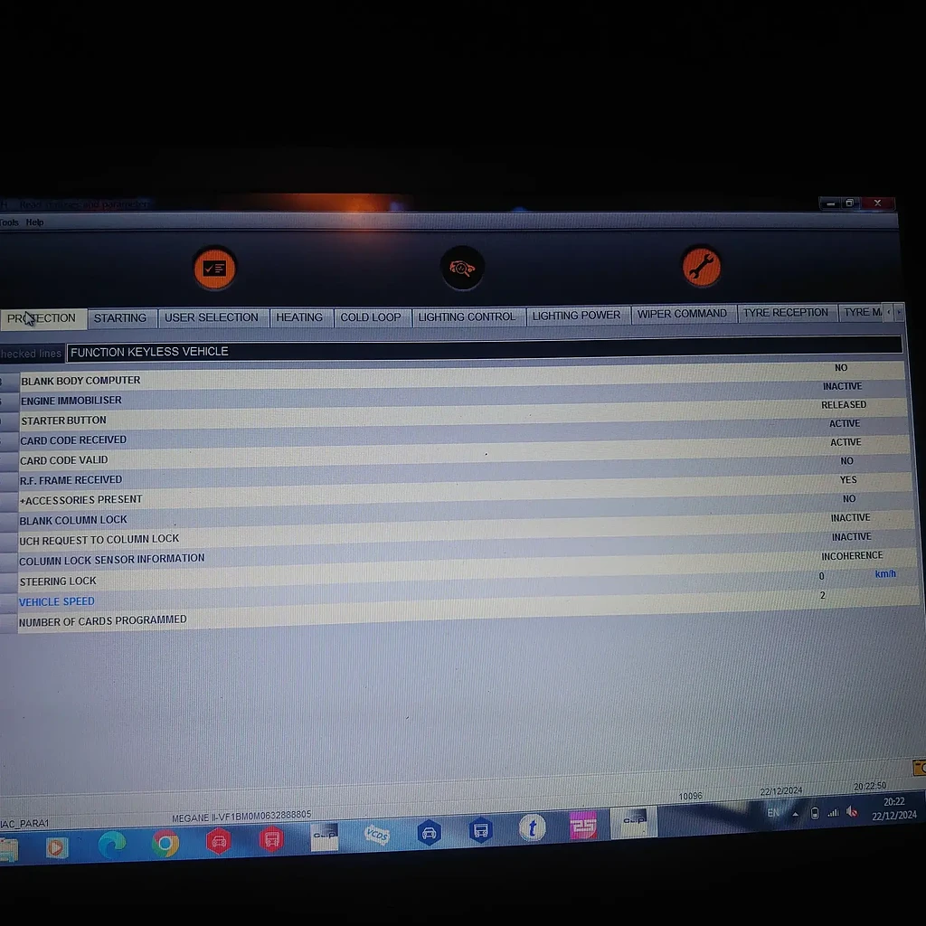

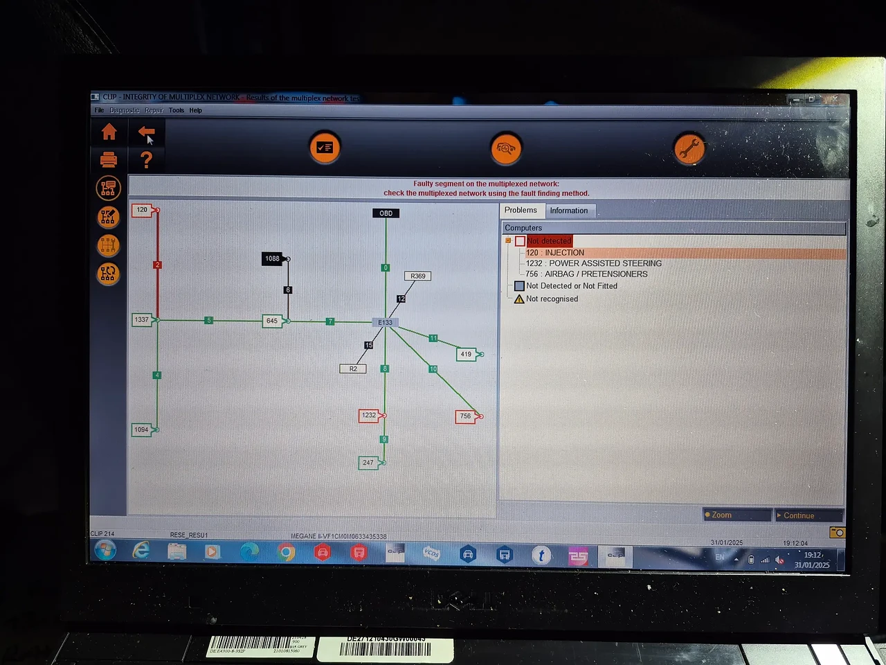

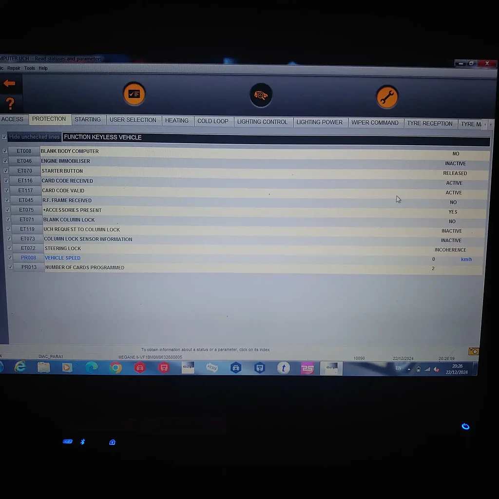

Few screen shots from clip if anyone wants to throw ideas at me

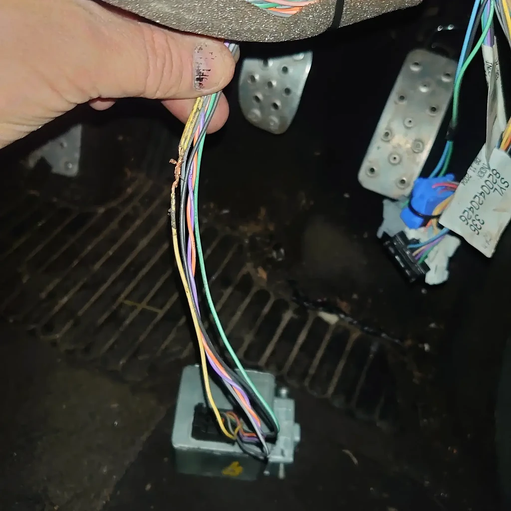

So went back to basics so to speak and found more bodging
I’m wondering is the normal meg interior loom the same as the 225 and just replace it
