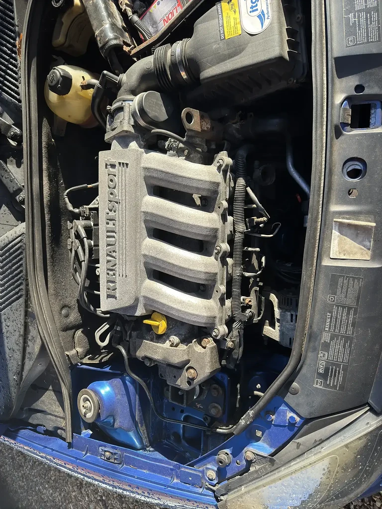

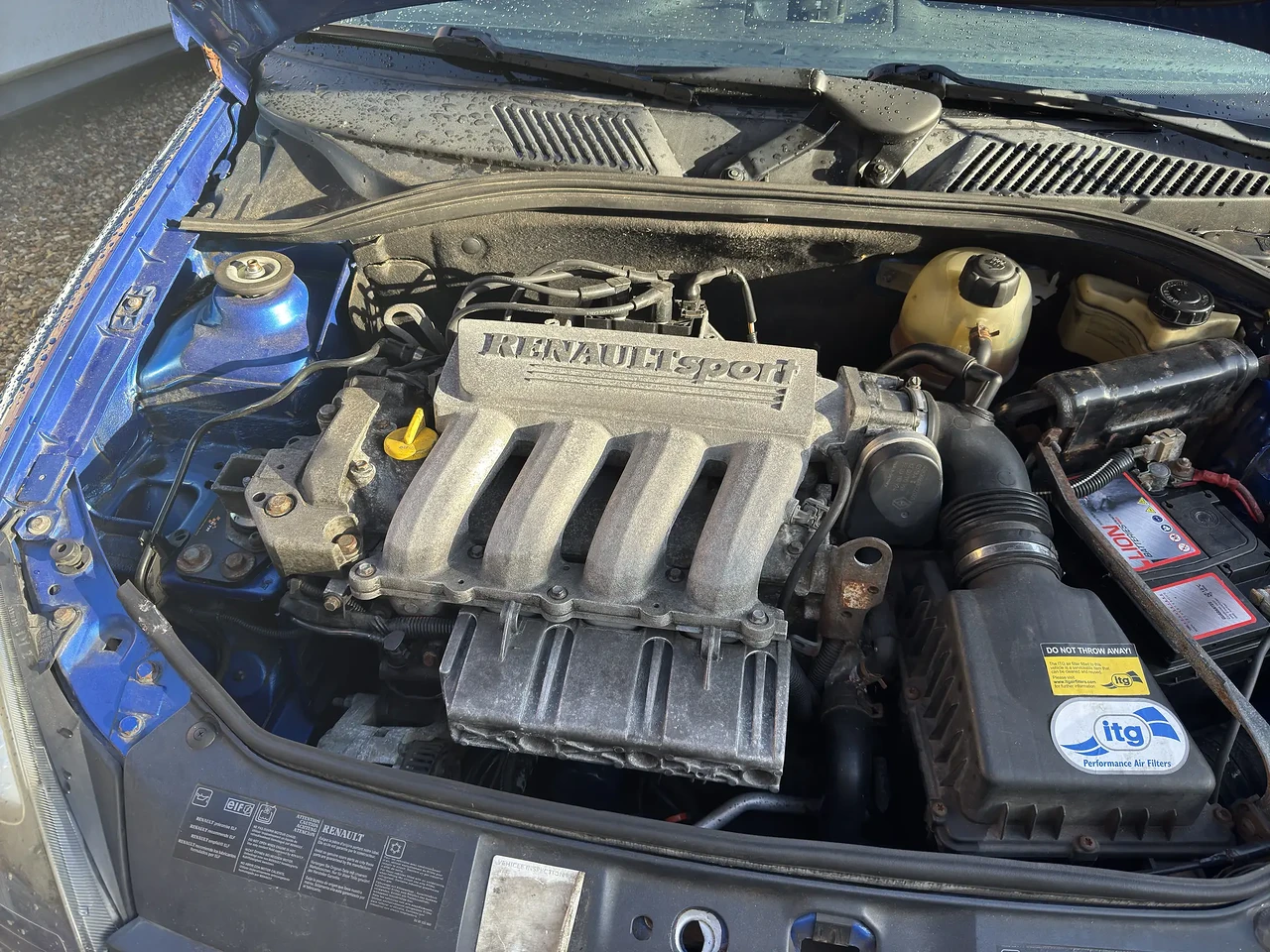

Rushed out at lunch to use DashCmd and my odb2 dongle.
O2 sensor one value fluctuating between just over 0v then .65v
Car idle is rough and smells of fuel
Resistance shall be measure tomorrow @Adey
Almost live injector resistance results are in.
( from gearbox to offside )
Inj1 15.9
Inj2 16.4
Inj3 16.4
Inj4 15.8
All there , or thereabouts. They look cosmetically in ok condition.
Must be o2 or TDC then at a guess.

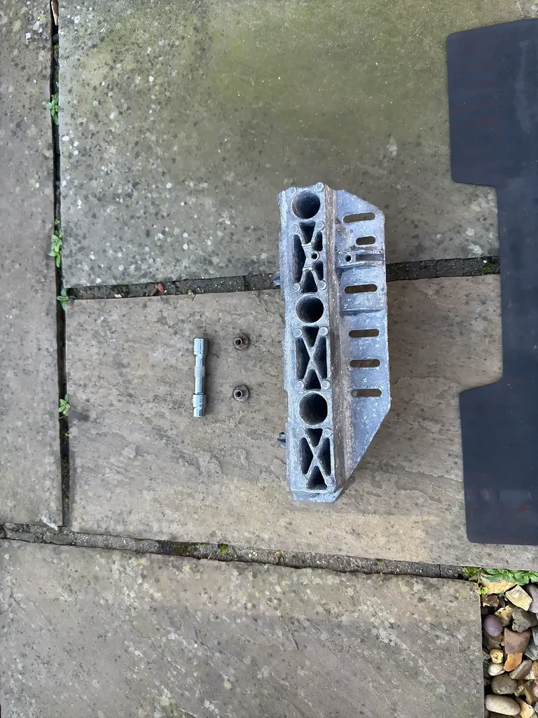

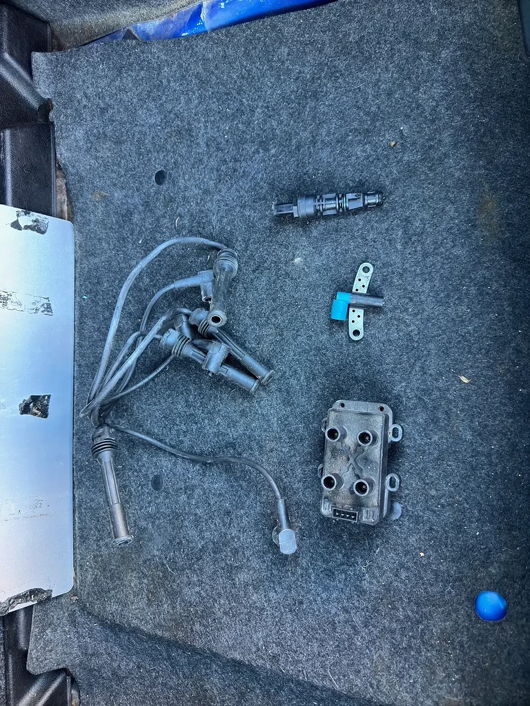

I found some spare part treasure including :
Guess that should save me having to invest in these as apparently these were changed over 10mo ago

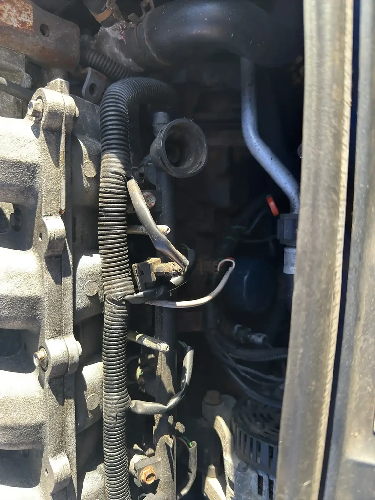

I am not sure what the part that resembles a kazoo is ( top , right ) though?

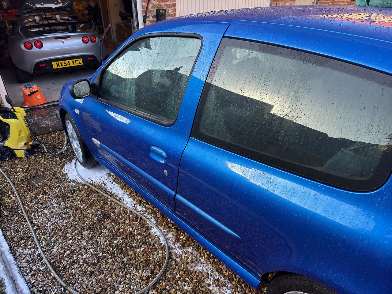

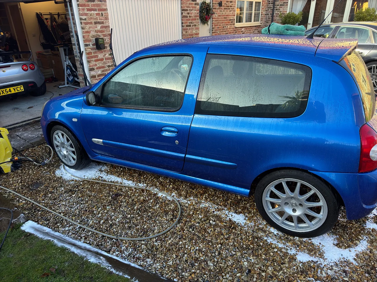

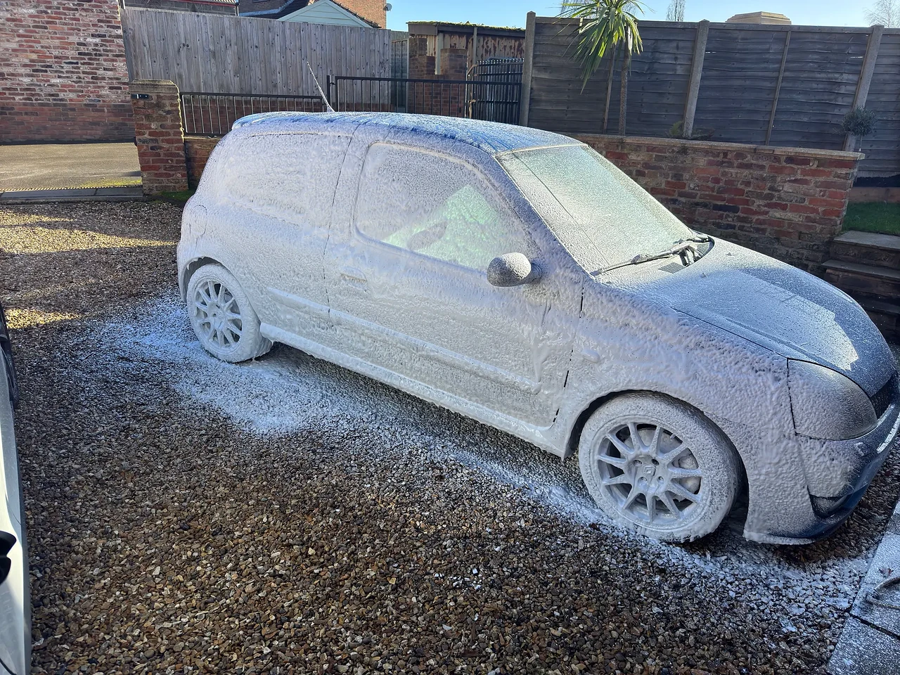

I also washed the car to get rid of the salt from the run back from the bodyshop and all the bodyshop dust etc.
Its a very photgenic car but dont be under any illusion. There are marks on a lot of the panels. Its not perfect by a long way

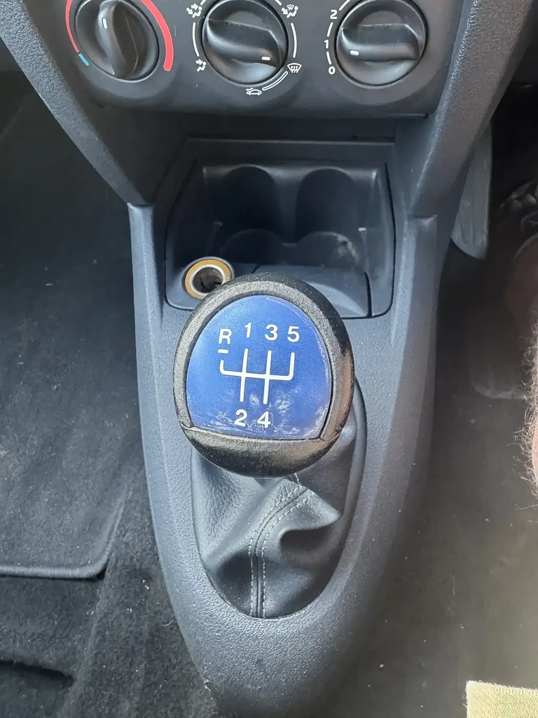

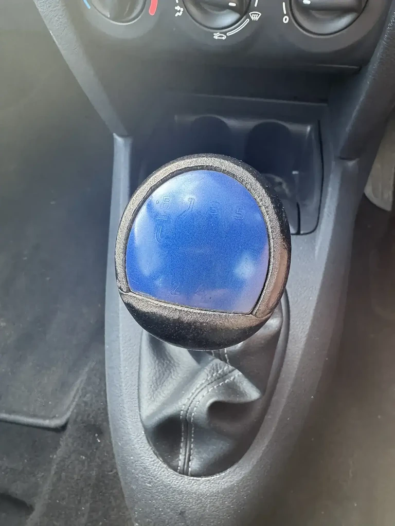

I noticed when I purchased the car my knob was worn.
Thanks to a very helpful man over at Diamond-Performance I recieved a new knob sticker.
I then put it into the very new, very high tech paint booth and lacquered it. Its currently in there drying now
Before
Decal applied
Top removed to apply lacquer in new paint booth

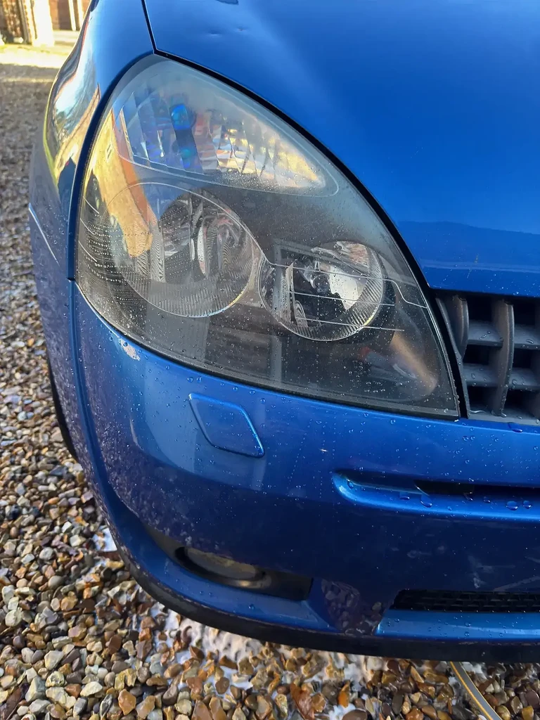

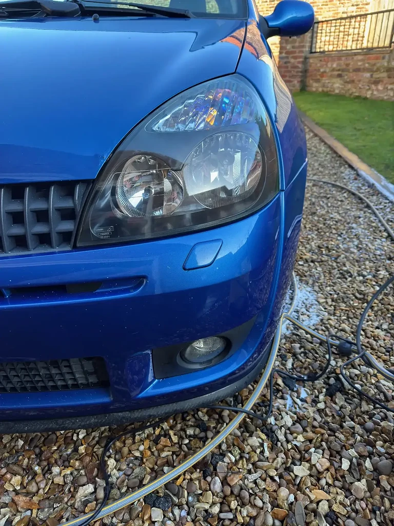

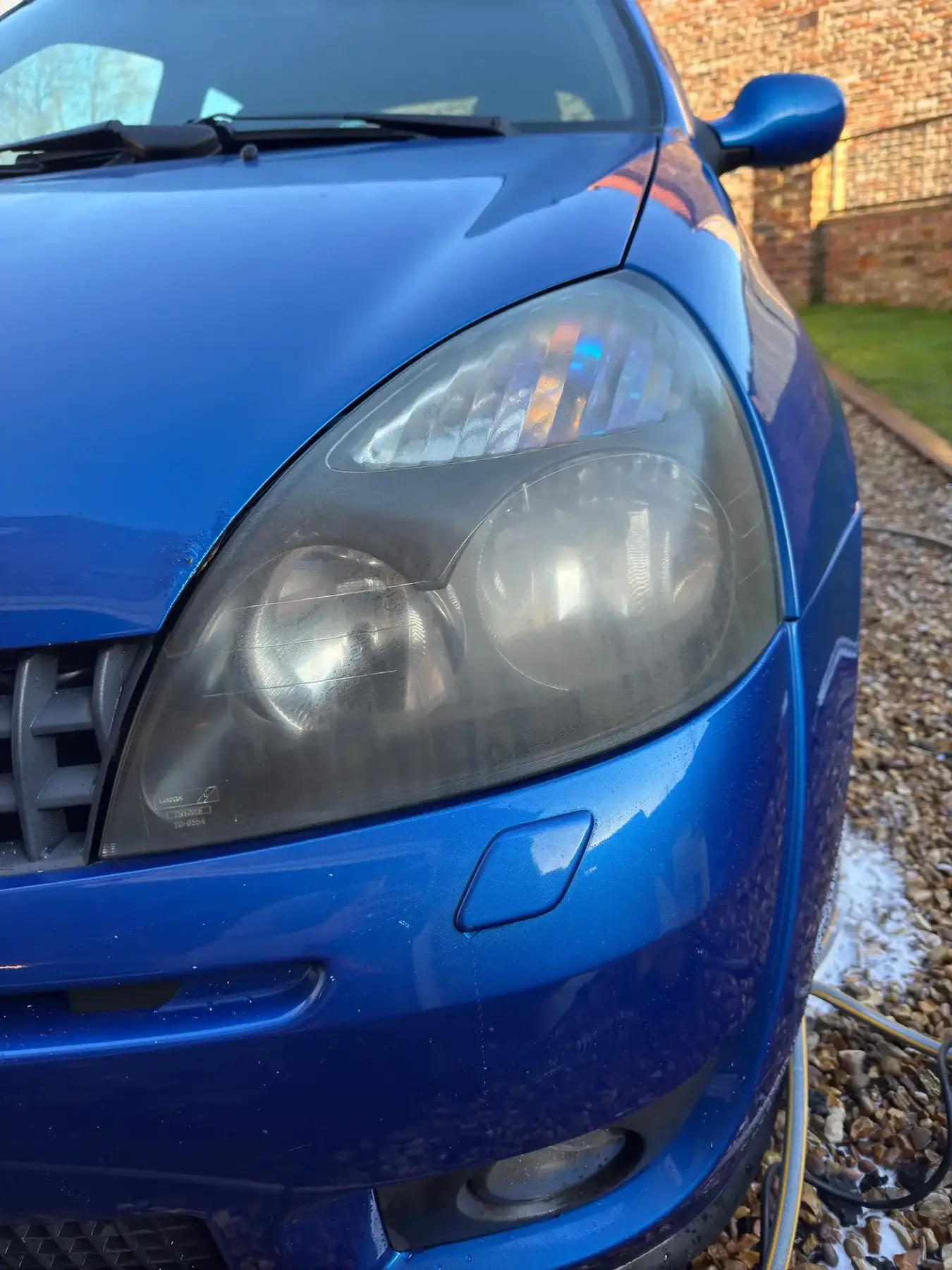

Finally the nearside light was frustrating me. It was cloudy as heck. I purchased a cheap “wipe” kit on Amazon and had a go. Nothing to lose really!
Its only gone and worked!
Before
What it should look like
After
Looks like a gearbox speedo pickup as theses don’t use the abs rings like a normal Renault sport Clio
Thank you!
O2 sensor ordered. Cannot wait to try and get under the clio.
all being well itll just come out easily (y)
all being well itll just com out easily (y)
