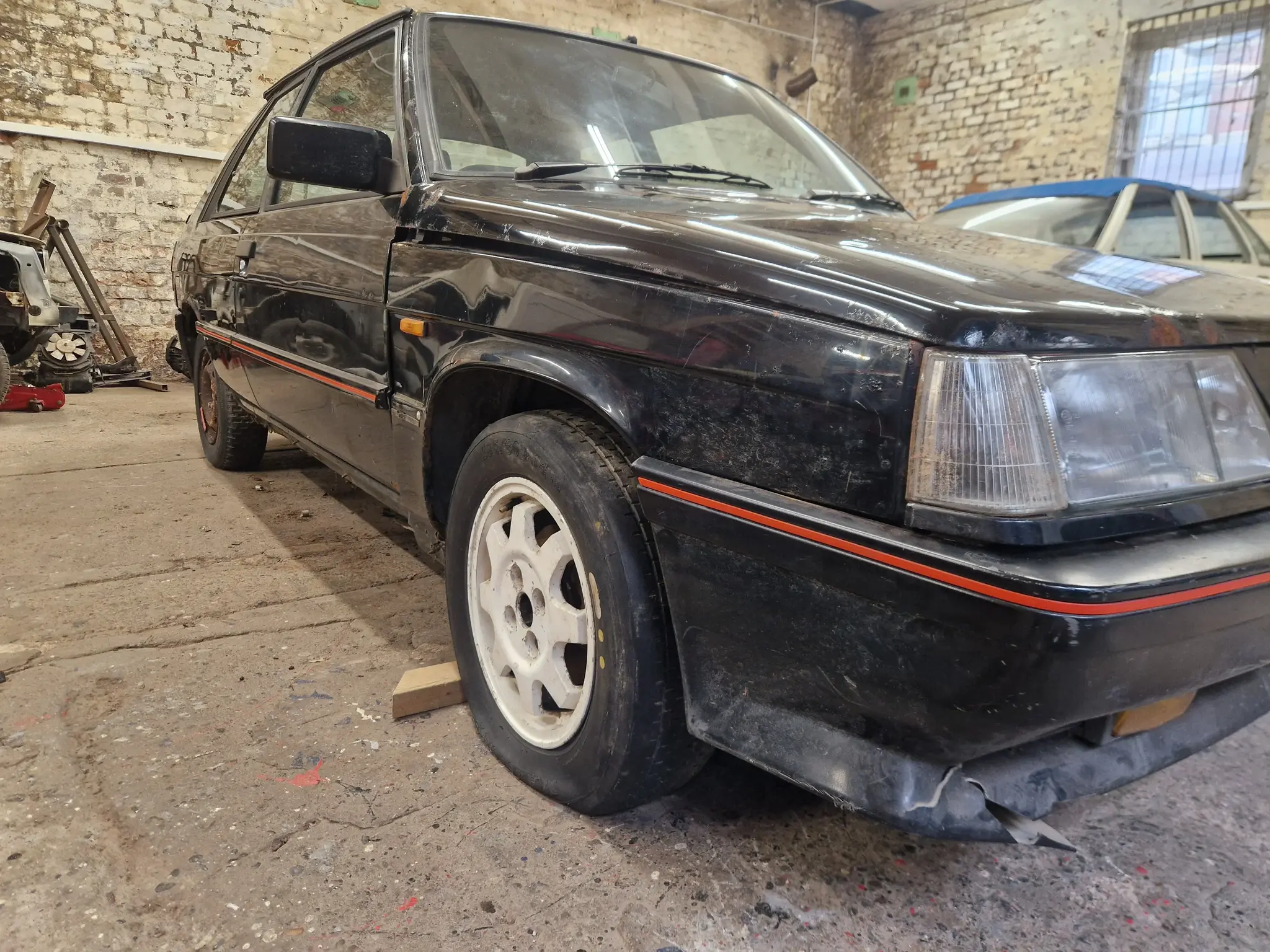

1988 black 11 turbo

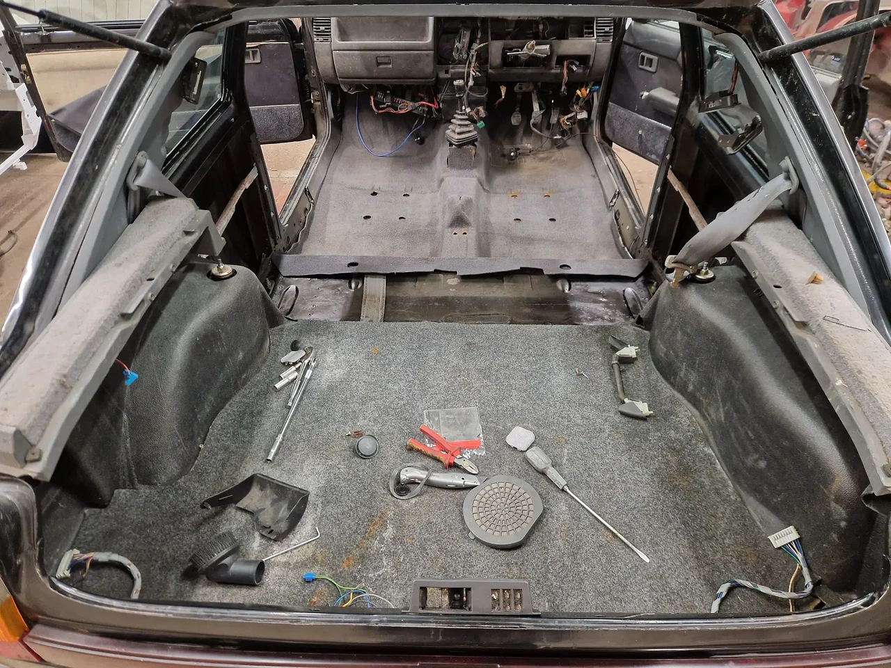

Removing the damaged interior to inspect the shell

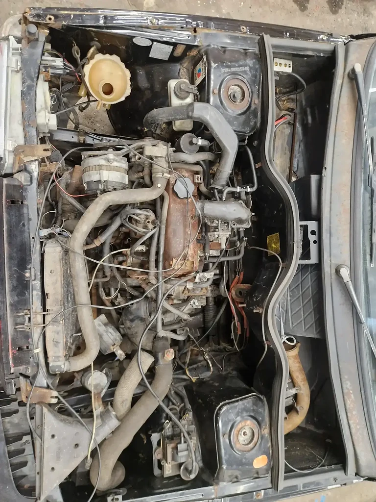

Engine bay pic..patina!

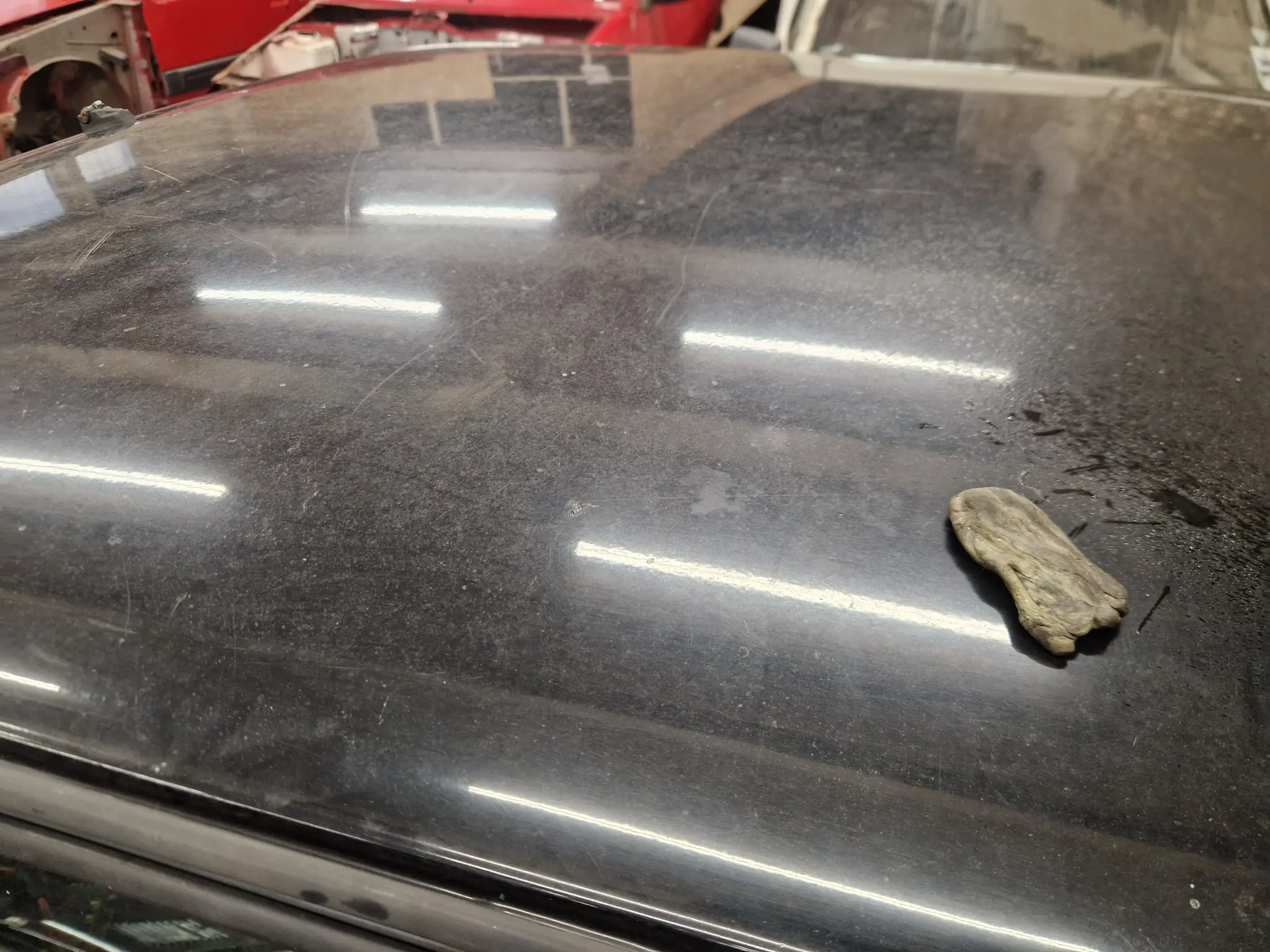

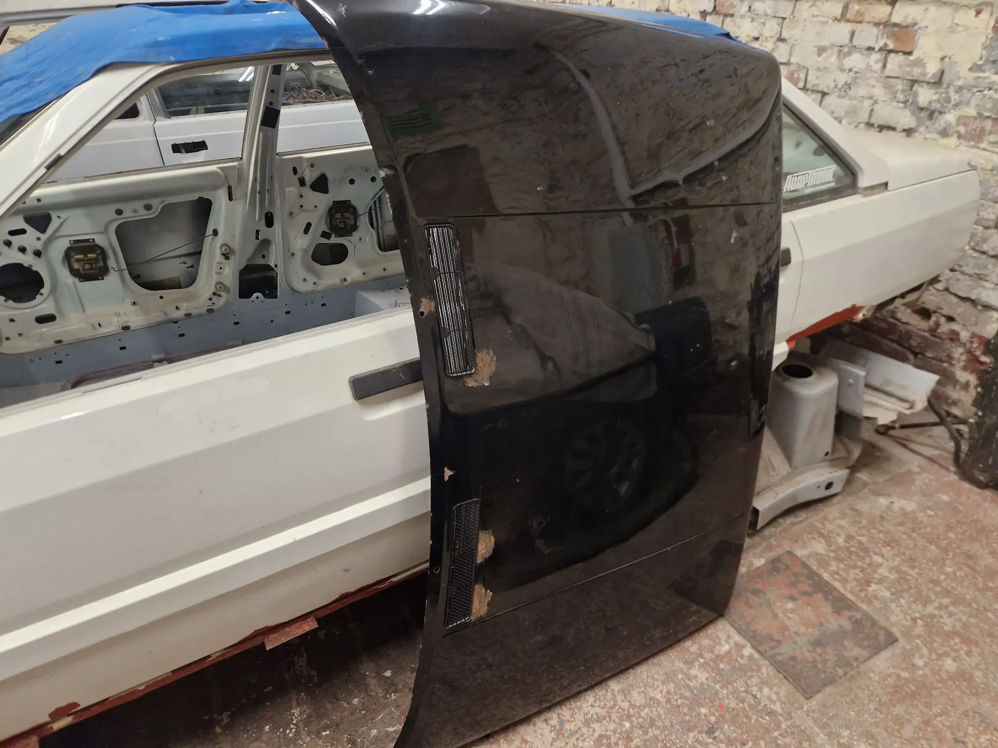

So lets see what the paint is actually like
Shiney, despite the repairs needed

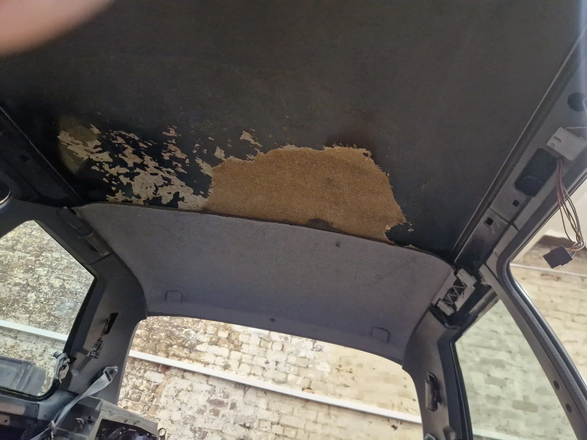

Half a roof lining to remove

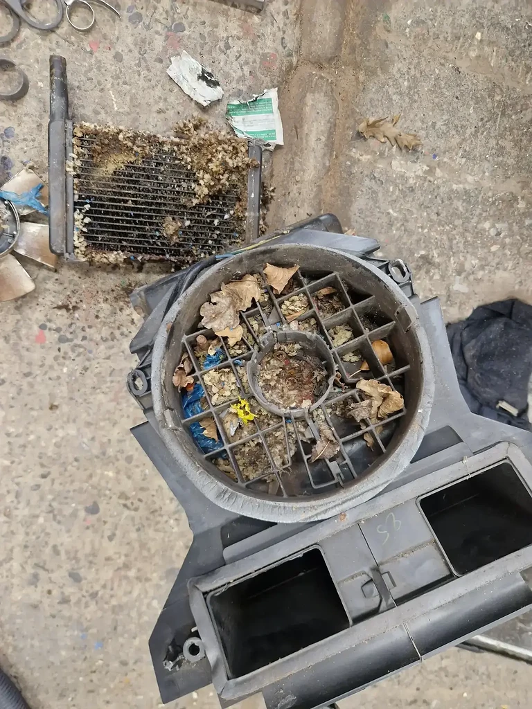

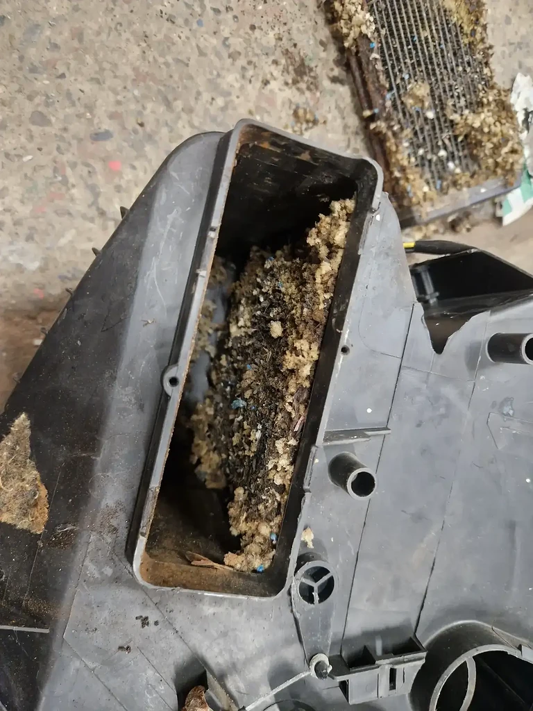

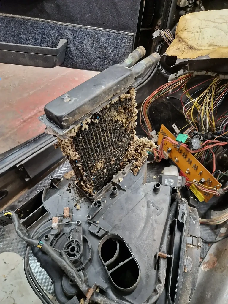

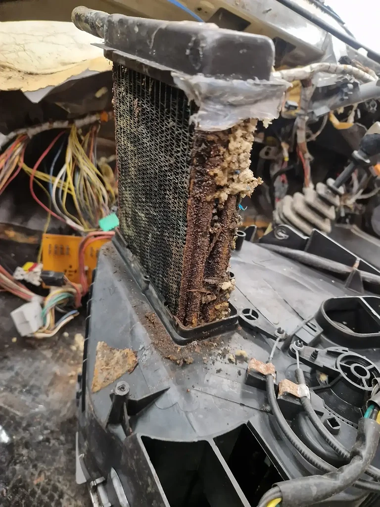

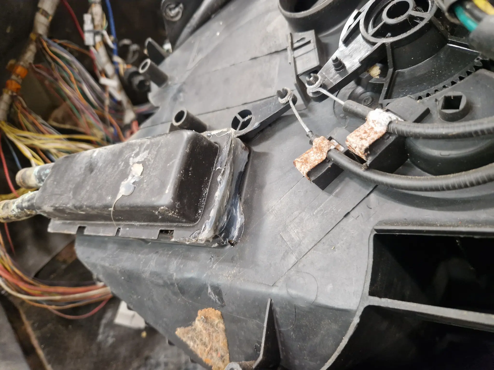

Along with the heater box
Housing rodents at some point and totally blocked
Bulkhead sound deadening replaced
Heaterbox replaced
And a spare dash i had for mine fitted
Interior also utilised from my 11
Roof lining removed from the quattro and as usual some damaged
Masking tape for extra support
And fitted

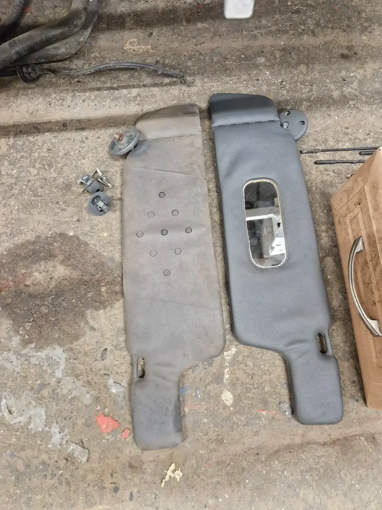

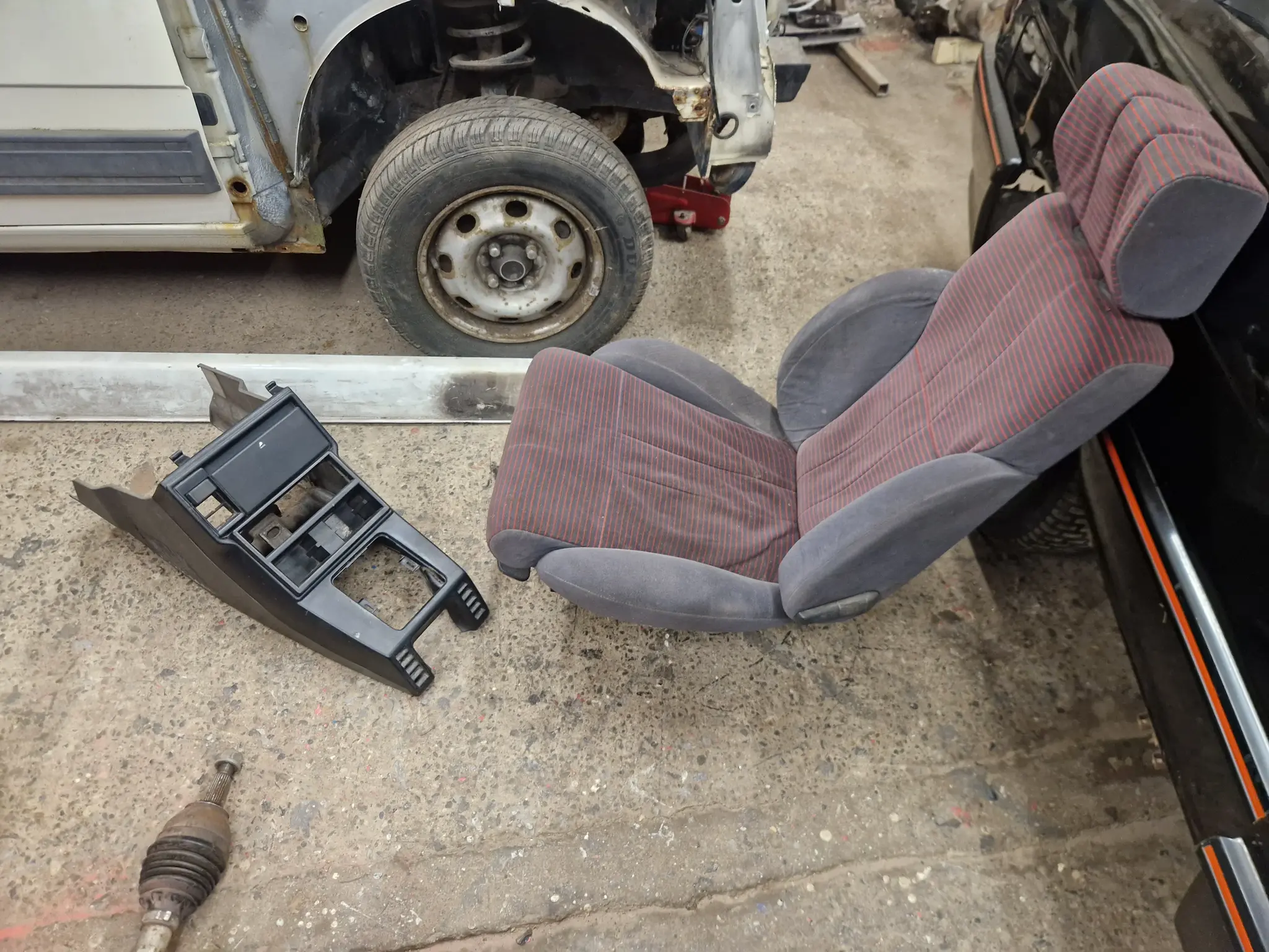

Seats going in, more parts that won’t be used in the quattro version
Finding and adding more parts that were missing
Extra dash bits going in

Giving the outside a once over
With some pics of the rough bits too

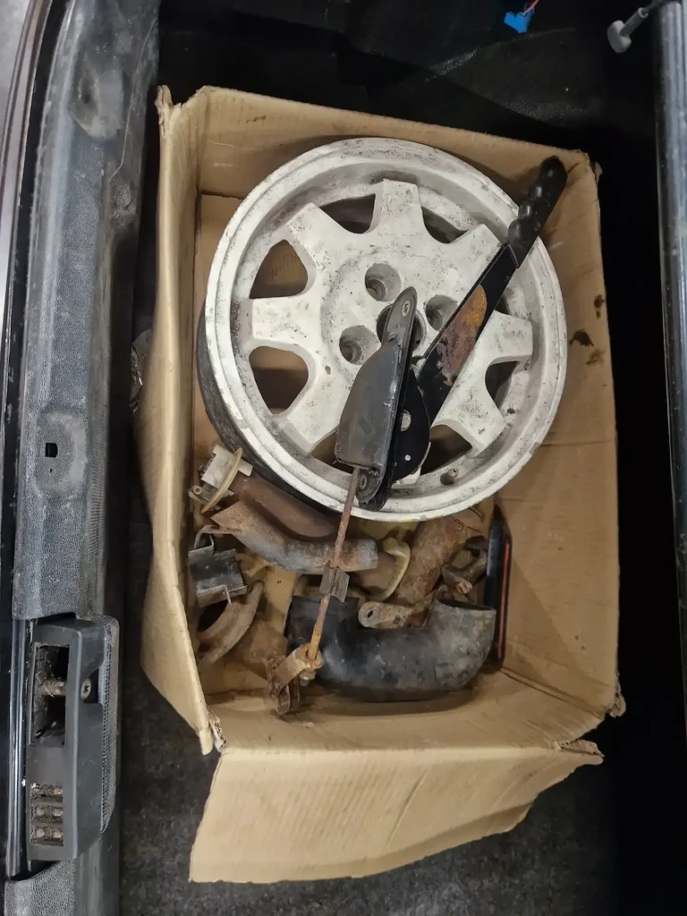

With a box of spares yet to fit

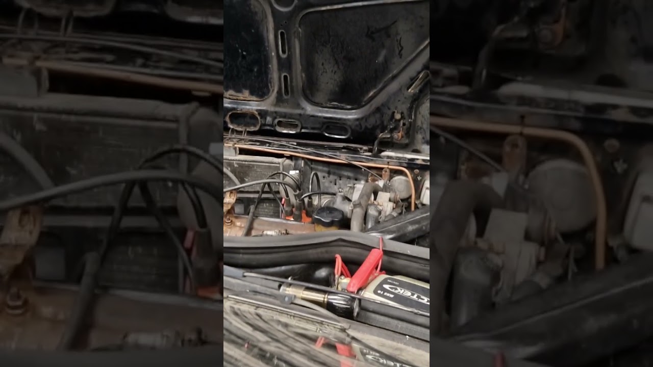

All connected up using the oem fuel lines
Some fuel in, and of course the oem lines leaked, in several places
Fuel lines pulled out and replaced with 8mm microbore copper pipe. Fuel is now up to the carb.

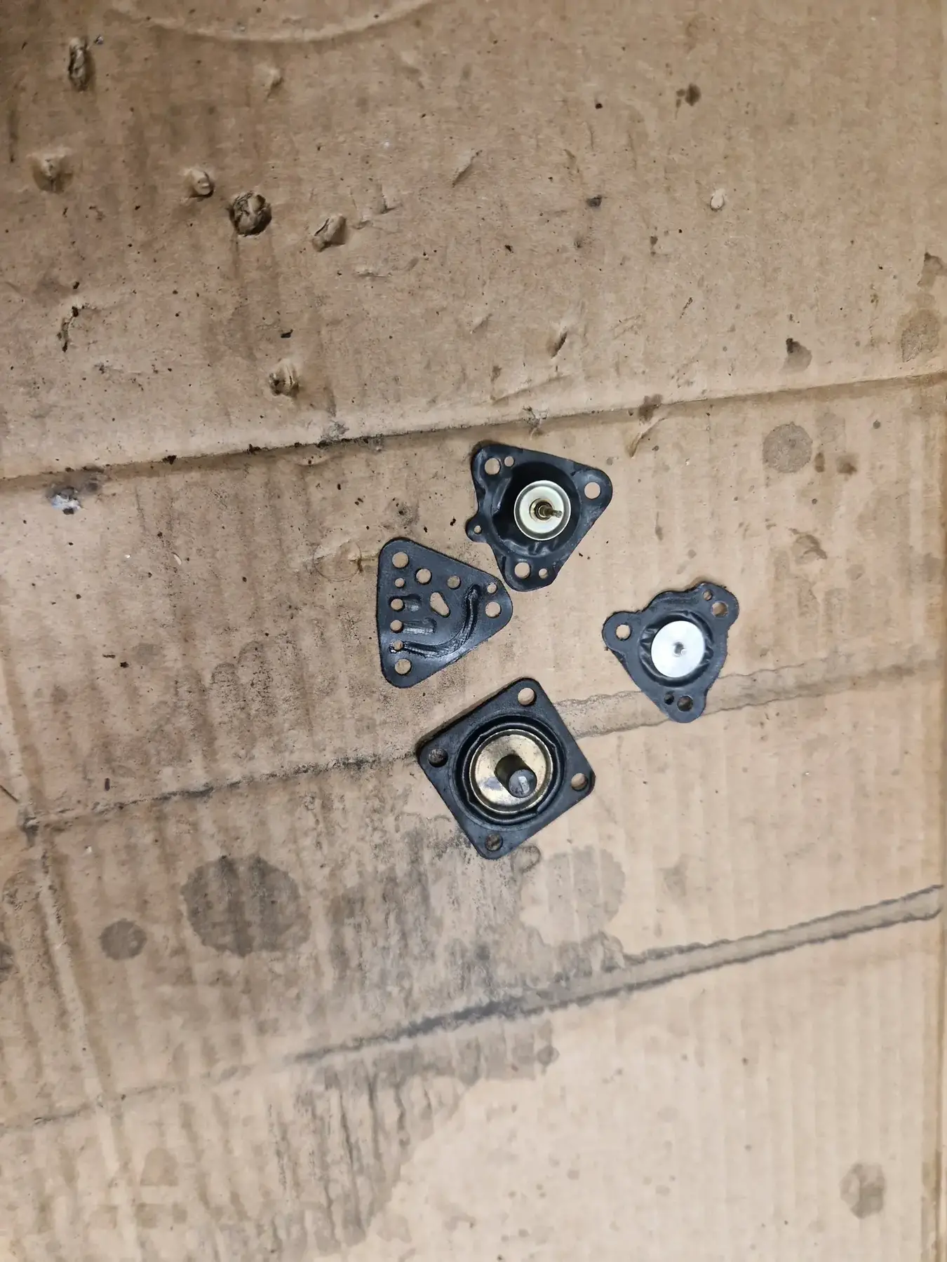

As expected, the carb doesn’t operate. Removed, checked, adjusted and new gaskets fitted
Theres fuel, ign next

Coolant system was modified, replacing the oil sandwich plate with an f block version. It has a watercooled housing, allowing radiators without the oil cooler section to be used..like a spare clio one i have. Fitted..and leaked.
Swapped out for another rad.
A turbo has been sourced, fitted and it’s fired it up once again. A nice none tappety engine!

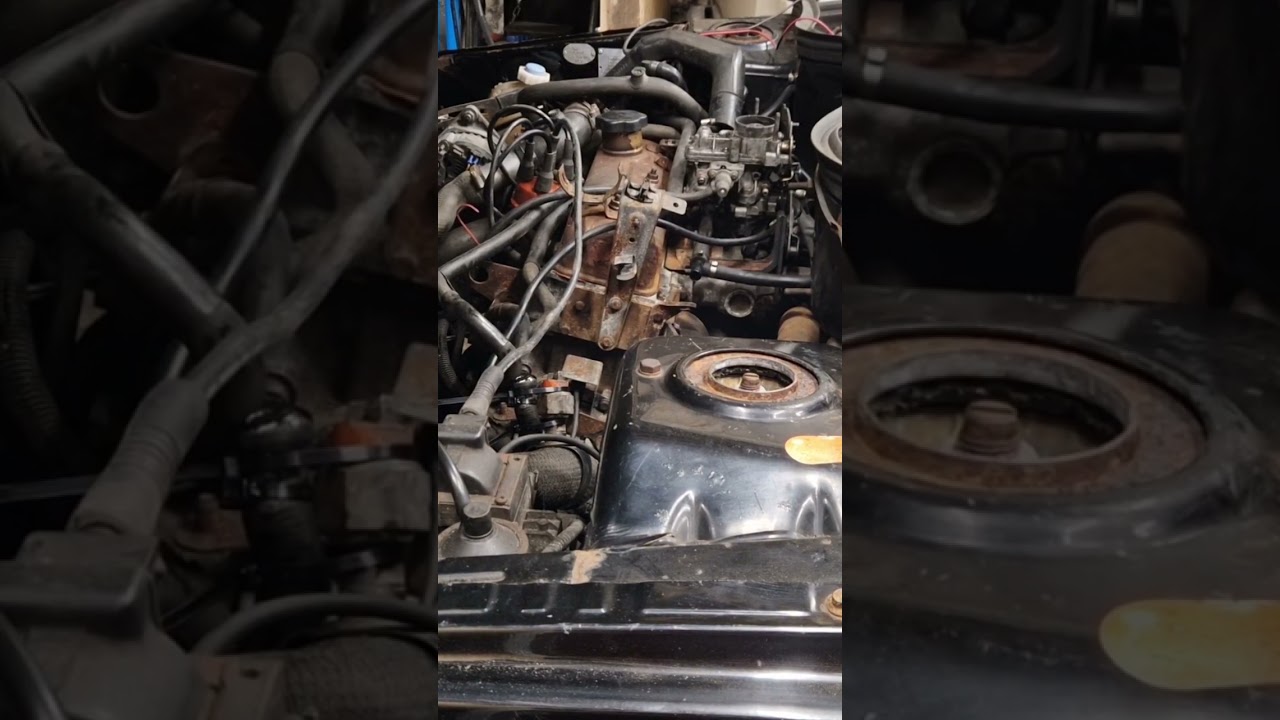

The first fire up in well over 10years
Followed by
With the second start and clear through
Progress at least!
