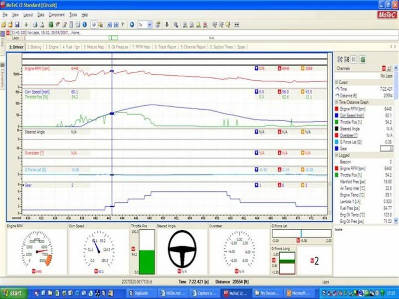

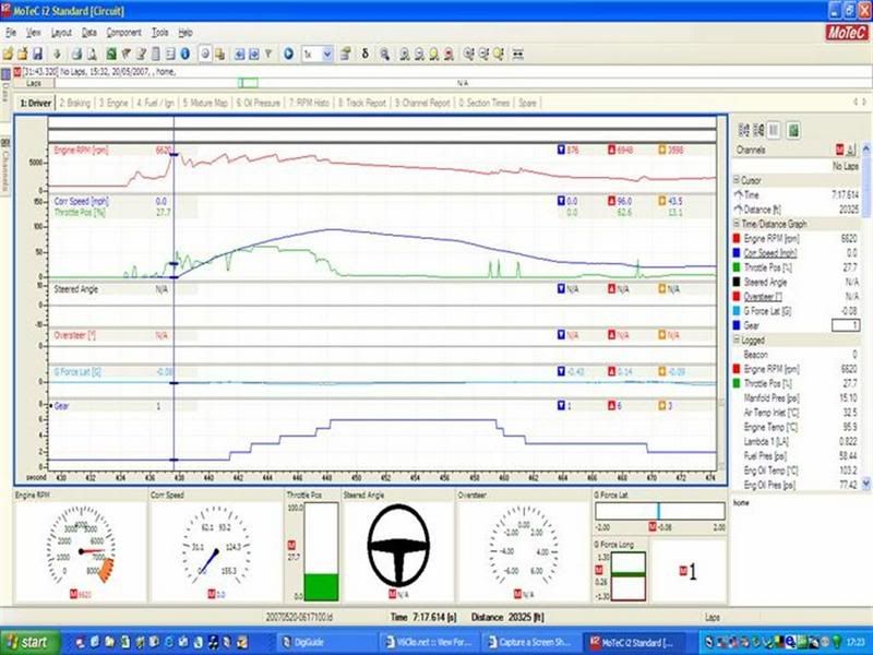

i dont understand any of this, but im guessing there good, considering the engines they pack in.
That can't be...
1st: speed = 0 mph and time = 7.17....
2nd: speed = 60.1mph and time 7.22....
5th: speed = 95mph and time 7.27...
Are you saying that the car went form 0-60 in 0.05 of a second?
think the times are 7:17.614, 7:22.421 and 7:27.965
so 0-60.1mph is 4.807s and 0-95 is 10.351s
Doh....I never was that great at maths!
I second quicker to 60 than a MK2 with all that kit thrown at it?
I thought it was gonna be at least 4 seconds to sixty and a sub 10 seconds to 100?
mike64":2030i33s said:
note the throttle positions, it never seems to go above 60-70%
Well spotted Mike...........The car wasn't even mapped for the turbo..........still running the supercharger map hence not being pushed very hard. It will be comfortably sub 4 and sub 10 when done.
I can confirm it was at half throttle and unmapped and running only 6psi of the 18 available so if anyone would like a head to head they're welcome!!!
