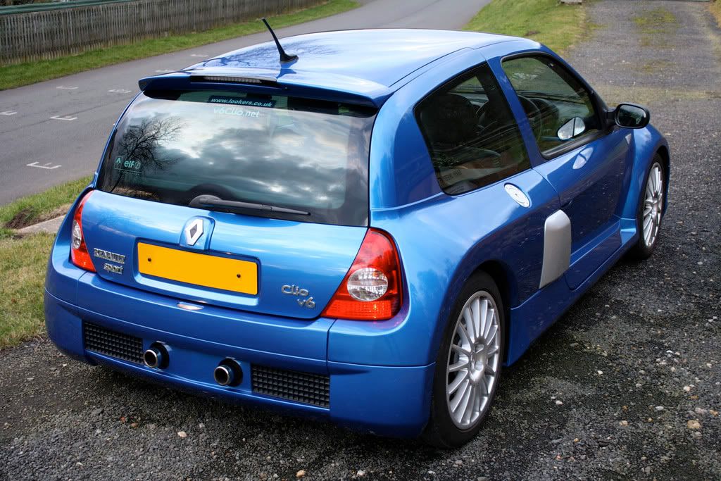

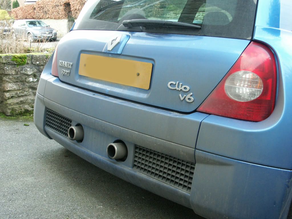

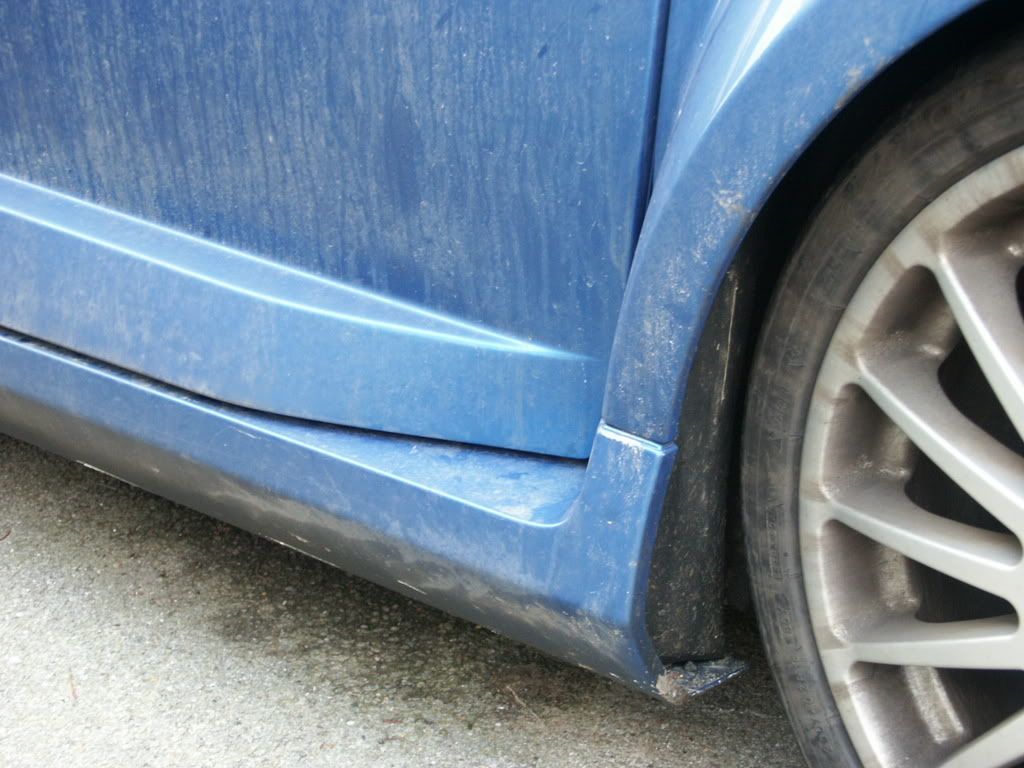

This was the state of it after 2 weeks without a clean!

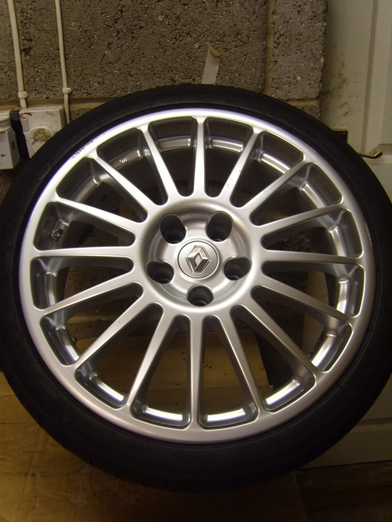

All 4 wheels were then taken off and washed with Bilberry wheel cleaner and clayed with Bilt-Hamber Auto-Clay. Arches were treated with APC and rinsed.
Wheels were then polished with Autoglym SRP and given 2 coats of Poorboys Whel Sealant.

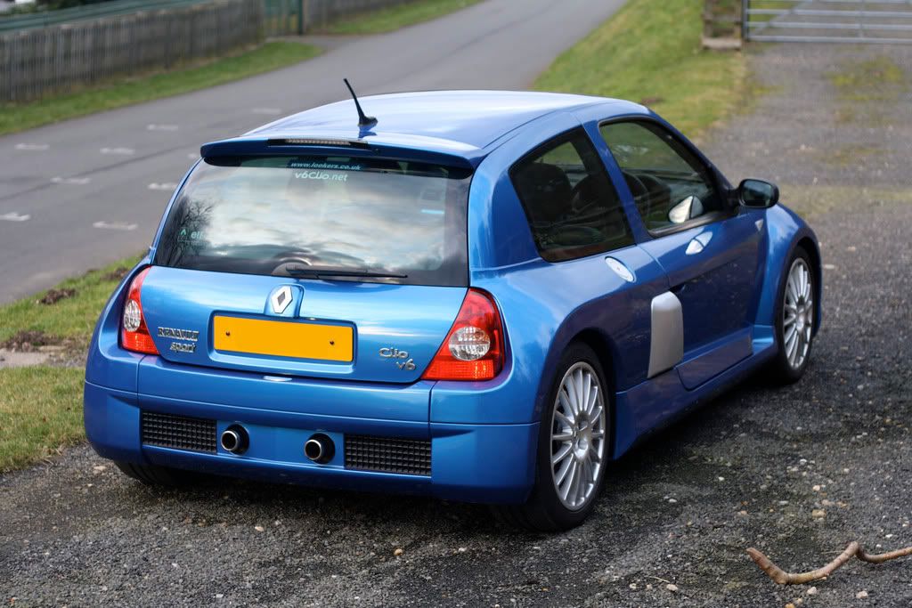

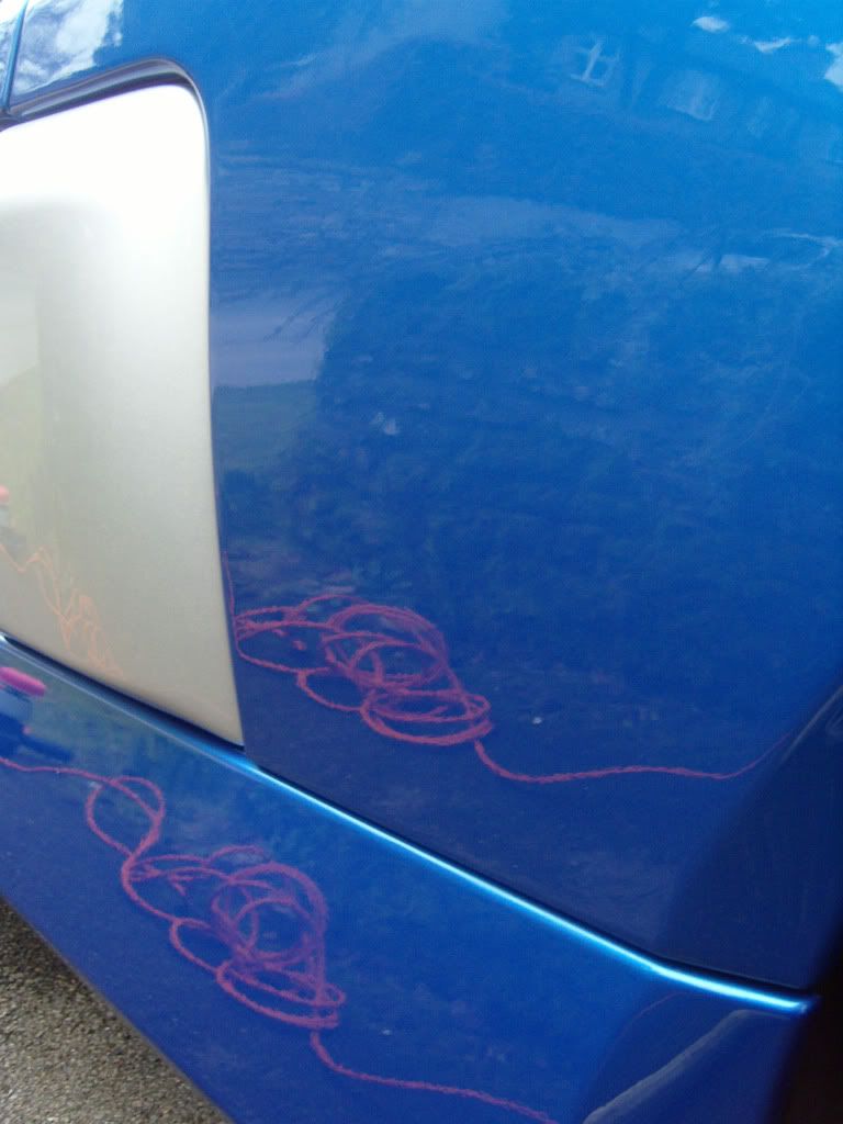

After numerous tests with different pad and polish combinations I eventually settled on a Megs polishing pad with Megs #80 as there was barely any correction required. I did struggle seeing the fine scratches that needed correcting due to poor lighting options available to me. Anyway, here are the results from polishing.

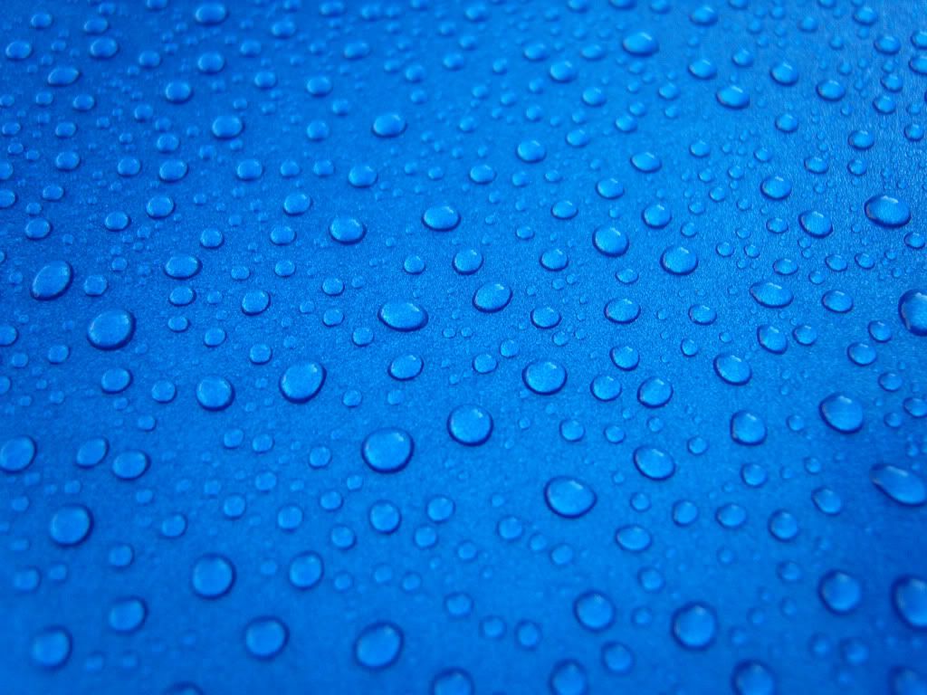

The paint was then wiped down with Duragloss Aquawax.

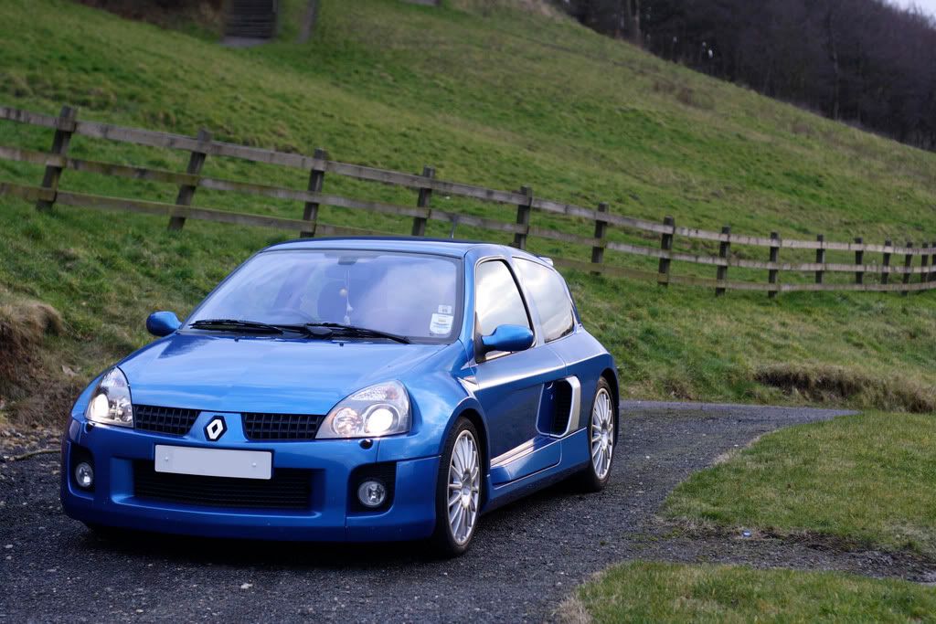

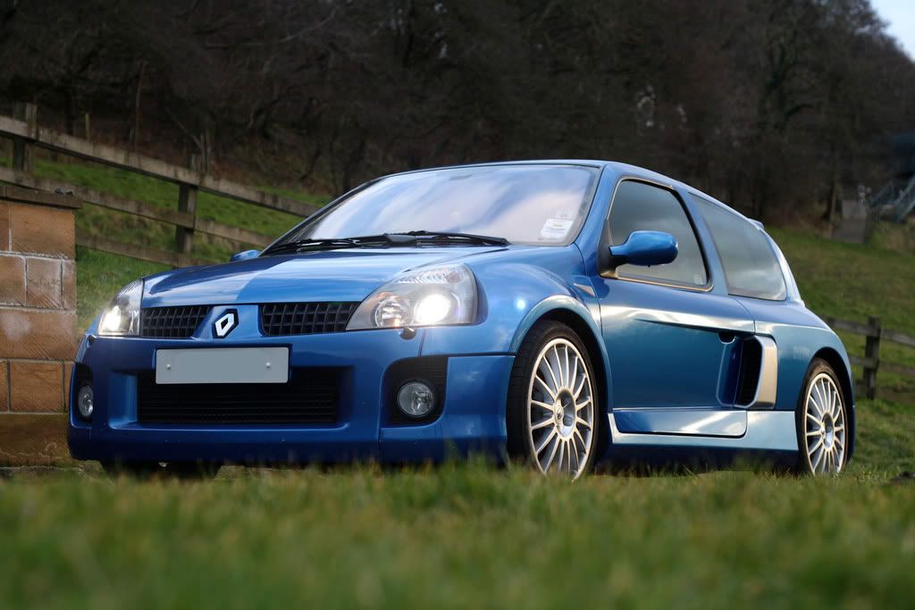

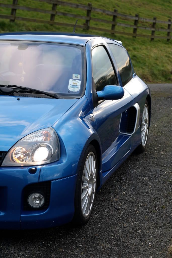

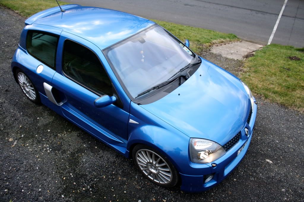

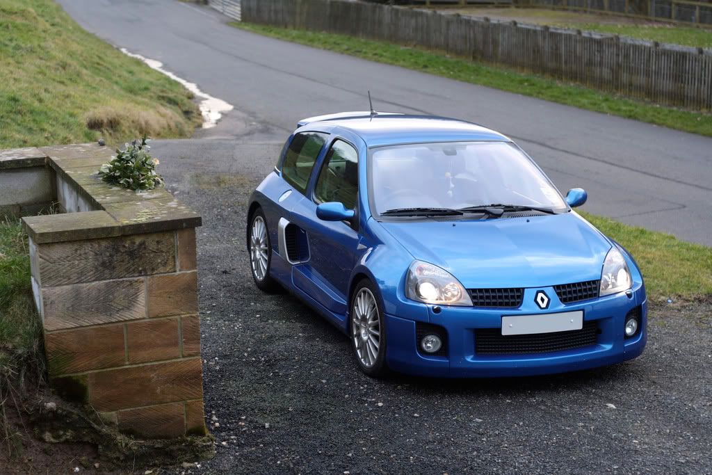

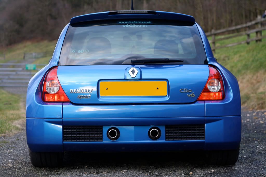

Final Result (As seen in the media section!):

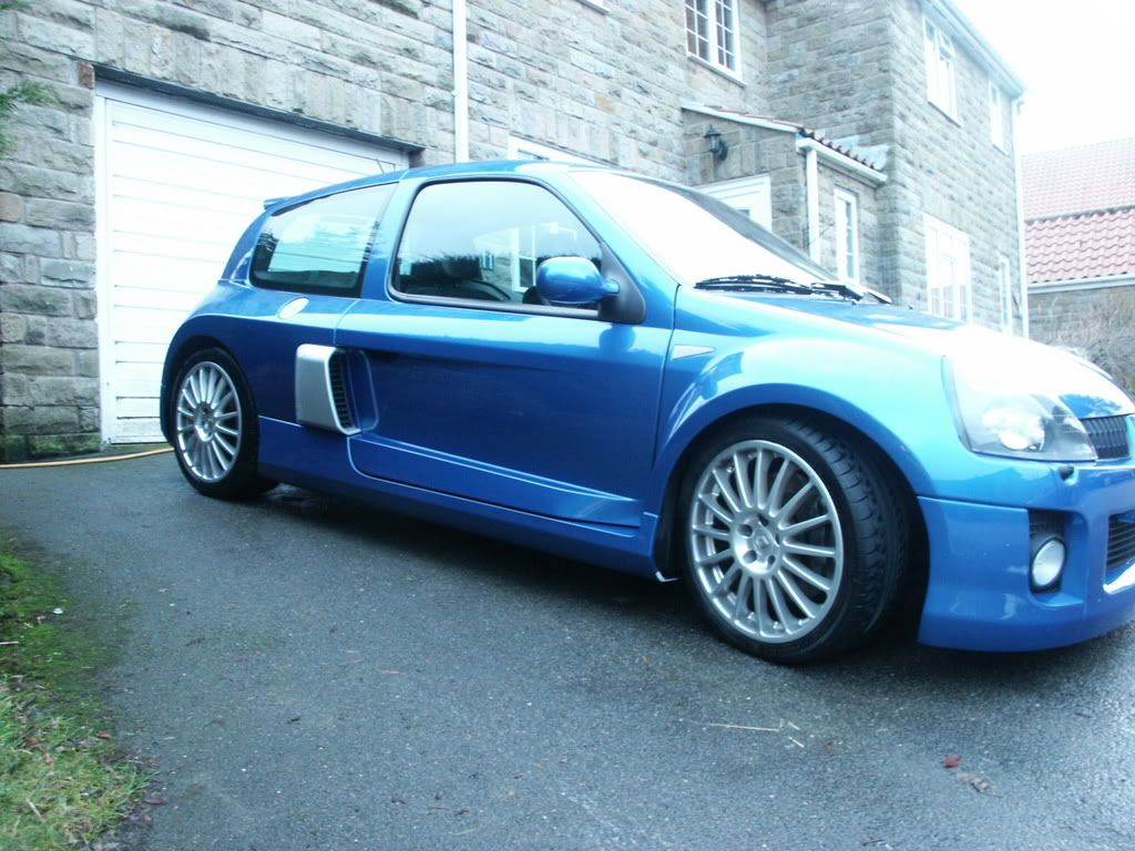

Leaving:
